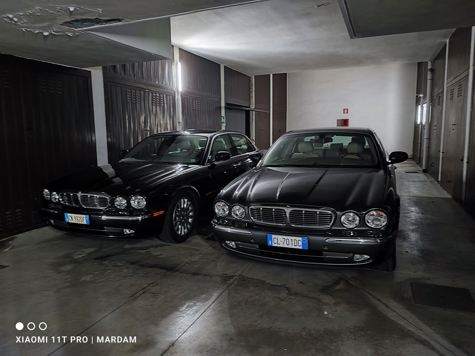

“My father owned two XJ8s: the first one he bought new in 2003, and the second one he purchased three years ago because his original black XJ8 had reached 200,000 km and he no longer felt comfortable taking it on long trips. So he asked the Jaguar dealer in Monza to find him another one with low mileage.The dealership found him a wonderful grey one with only 50,000 km on the clock, this one had the 3.5 V8.
My dad passed away in June 2024 after a short illness, when I went to start the cars a few weeks later, I found his black one full of mold. We had inadvertently left the sunroof open, and all the seats were covered in mold.I immediately took it for a steam cleaning, but the person who did it didn’t do a very good job. I personally cleaned the seats again using a Furniture Clinic mold remover and steam. I removed the seats, cleaned everything thoroughly, and then took the car to a detailer who disassembled the interior and cleaned it completely — but the smell is still there. I have also used an ozone generator but the smell lingers. The aircon has been flushed with a cleaning foam for ducts but I can still smell mold... These day the weather is really cold and the smell is somewhat weaker but I fear hot weather would bring back the strong odor...
In the meanwhile the low mileage grey one has been sold (i could not afford to keep both, I have a 1965 Mercedes 220SEb Coupè W111 in need of a new interior and my 1992 Rover Mini Cooper awaiting a new tank and some metalwork)...
I know I should have kept the grey one and get rid of the black one but my mother had fond memories on the latter and I could not gave her another sad setback...

Both of them
Both of them

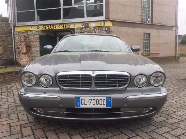

Why I am asking about CL701DC? My Super V8 was first registered to Jaguar in Rome and carried the licence plate CL700DC while it ran in Italy. Here's a picture from the ad when I bought it in 2018:
CL701DC definitely was built in 2003, but it belonged to model year/MY 2004.
