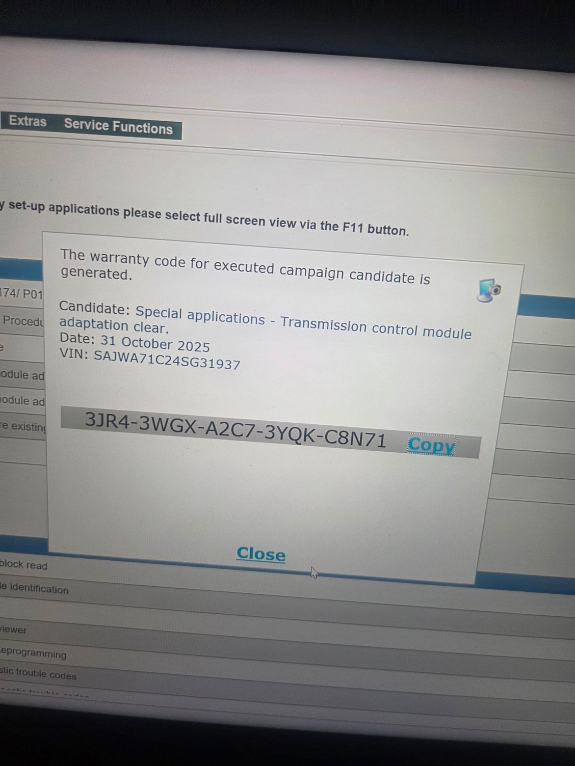

Thank you all so much for the reply! I went ahead and installed the appropriate drivers for the cable that I have and SDD does recognize the cable as a Mongoose Pro MFC. I hope to be able to access the data within the car to do a transmission adaptation reset and I'll keep everyone posted on whether or not I can do it on my cable.

Hey everyone!
As an update to my previous post, I was able to connect to the Jaguar using the cable and after countless searches later, I was able to reset the transmission adaptation. I'll be doing the drive adaptation procedure tomorrow but nonetheless, I am surprised that the Pro MFC, which was designed for Toyota, was able to communicate with the system from Jaguar (I assume it's based on the J-2534-1 protocol instead of the J-2534-2 protocol that the speciality JLR cable has). Overall, I am very happy that the software was able to work with the cable and I cannot wait to see the harsh shifting dissappearing at long last.
