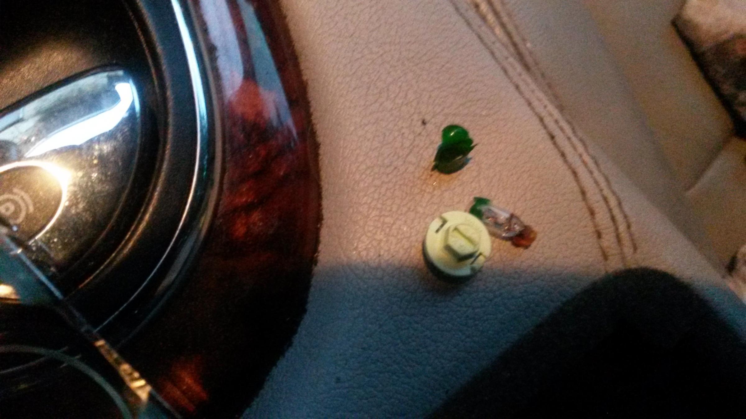

Now it was time to fix the bulb... the original one was fried.
Attachment 92009
I had to peel off the green film from the old bulb to use on the new one.
Attachment 92010
2721MF is the type of bulb you need to fix your clock light! I picked it up at the local auto store. It fits perfectly. Put it all back together and it should be working.
Attachment 92009
Attachment 92010
Attachment 92009
Attachment 92010
