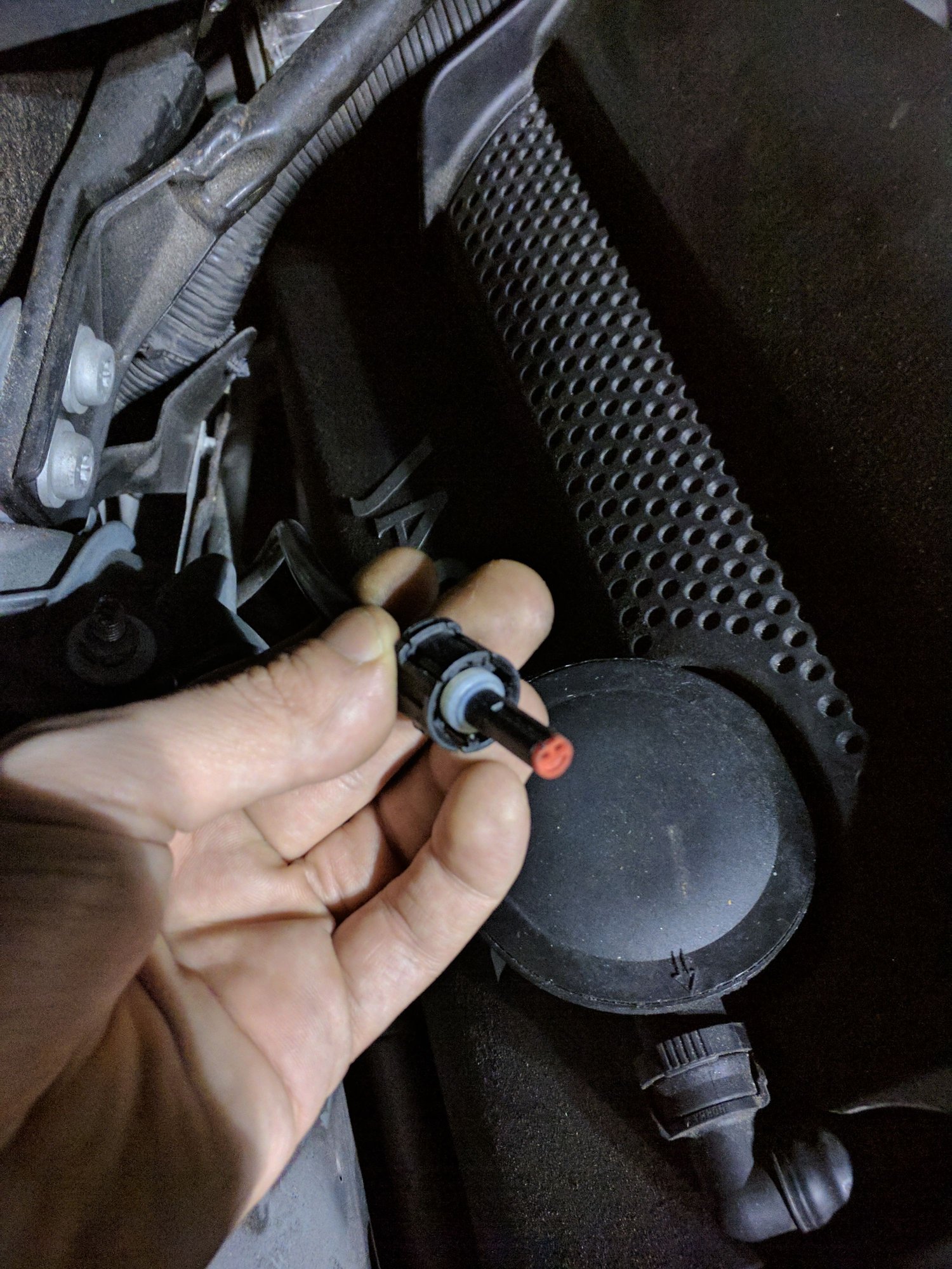

My A/C recently went out. I assumed it was the bad resistor in the BCM, but while poking around I found this unplugged electrical connector. I have no idea what it is. I replaced my air suspension with springs two years ago, could this be a leftover connector from that? I have no memory of it.
Yes, that is the connector for the ECATS adaptive damping solenoid valve in the original air spring/damper unit. When I've done the coil conversions I've just used a zip tie to attach those connectors to some convenient point so they don't dangle around.
