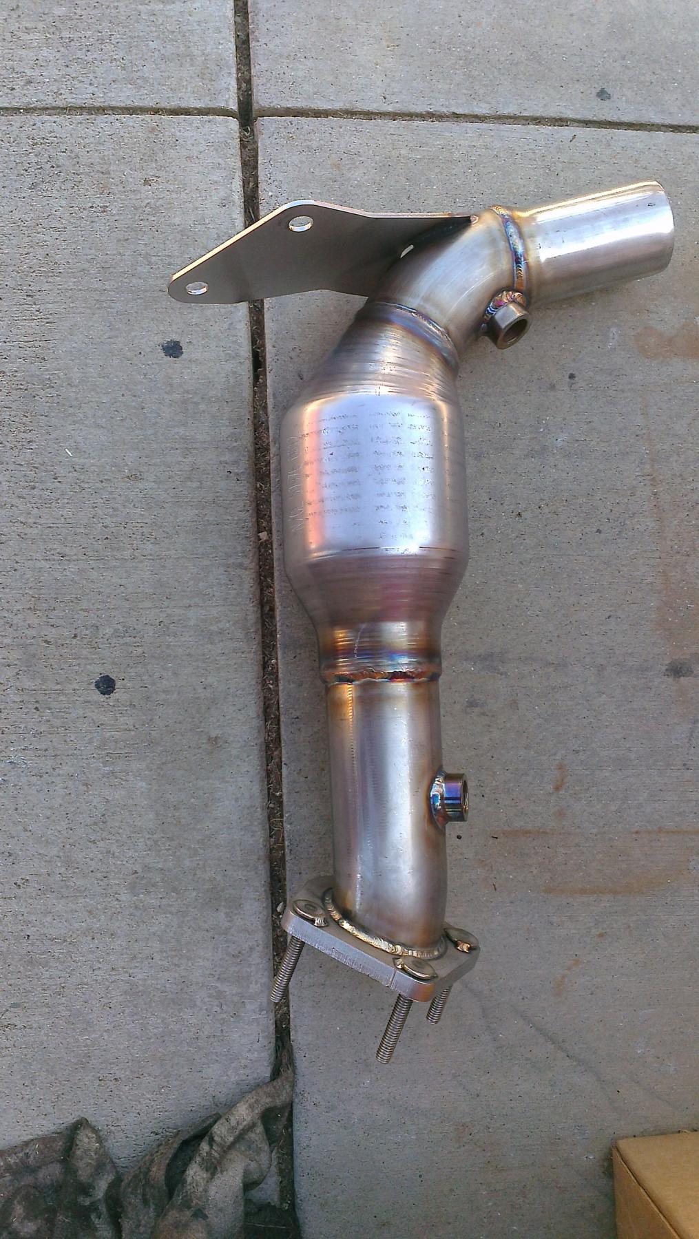

The flanges on the exhaust manifolds from the 4.2's are not the name as the earlier 4.0...
4.2 manifolds have an oval 2-bolt flange where the cats bolt on, with slip-joints at the other end.
4.0 manifolds have flanges at both ends, and the manifold end is a square 4-bolt flange.
Actually that's not entirely true. For XJ's yes that's the case. X100 XK's have the square flange even with the 4.2, and the early 4.0L S-Type's have the oval flanges.

Here is pic of what I got this time, does it fit anything (jag) then.
The first set I got was XKR for sure, these I don't know about???
Thanks for all the great info, have you heard of anybody actually getting 350/XJR cats from nameless.
Looks like very nice work they do, but I am starting to get just a little impatient after 7 weeks, LOL.
