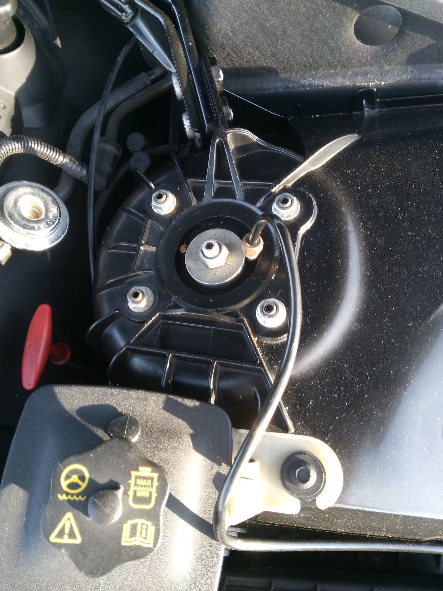

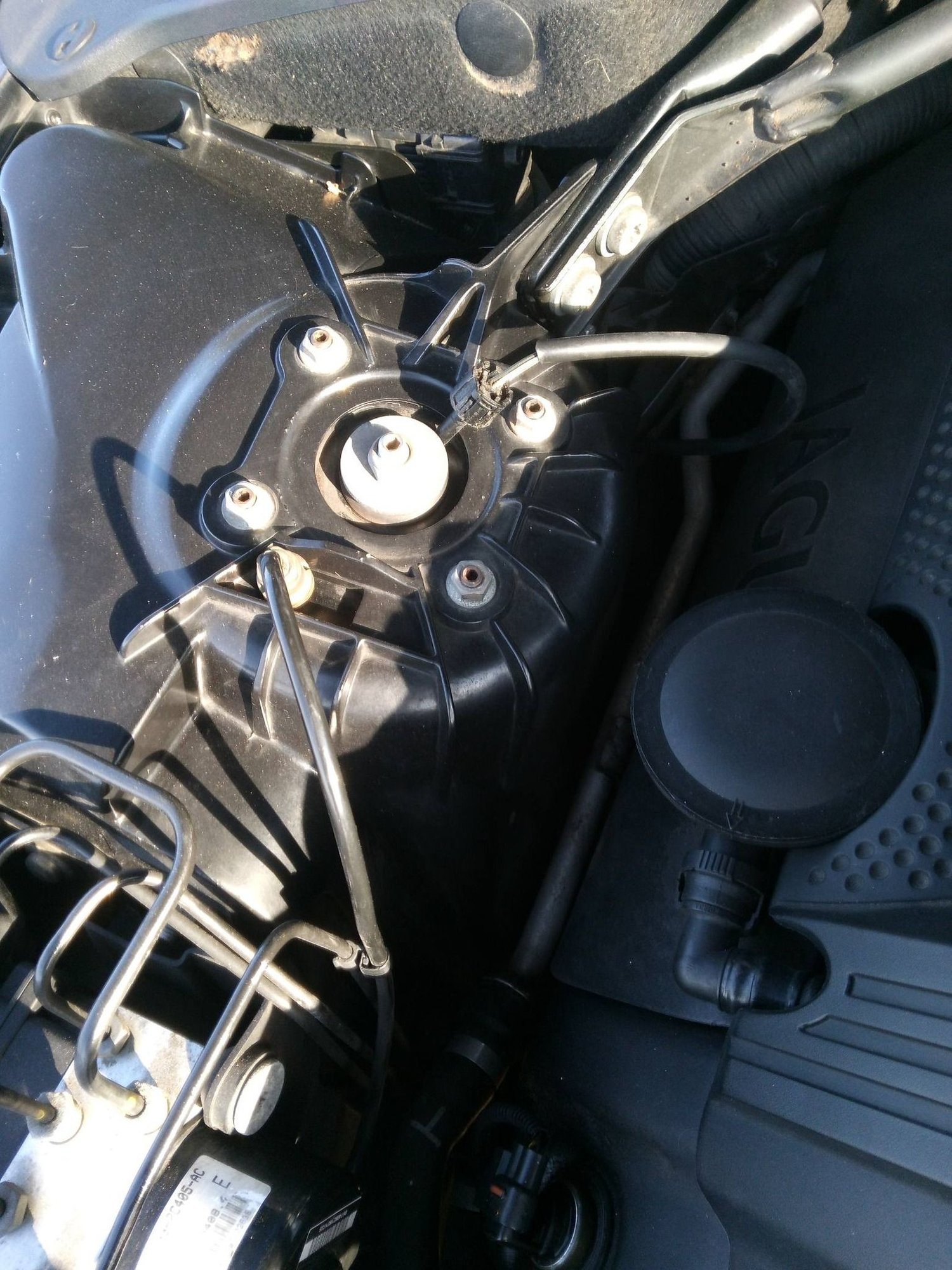

Hello everyone! Gotta question about my 2004 xj8. I just bought this recently and I'm working on some issues that it has. Just finished with the headlight problem and before I go much further I kinda need to know about my suspension systen as I am at a loss on this currently. The struts on the front appear to have only 4 holes on the sides for the bolts but the pictures I've seen of the air shocks show 4 bolts holes and a fifth for the air line and the left shows the connection in the middle I'm assuming connect to the air control module? Now if someone has switched the air ones out for regular ones, my question is why am I only seeing the 4 bolts holes? I've read various comments regarding this and I KNOW I want air but what is up with these 4 holes instead of 5? I need to know what I'm missing here b4 proceeding. I love this car and it's one of my dream cars. I have no problem investing my money into it as it's pretty darn immaculate but I'm no expert. I can do anything with help from my uncle or someone giving me direction. I can't really afford to pay someone to do the work so. If any can give me any tips, I would much appreciate it. Thanks, Larry

Your car is modified to have coil overs. Pervious owner took out air spring and replaced them with what you have.
What you see is remains of air connection. Here is what functional air suspension with leaking valve looks like driver side:
4 nuts hold shock on the top; air valve is to inflate airsprings; yours's have been removed and replaced with coilovers
there is one electrical connection in functional airspring. That is CATS adjusting suspension stiffness when/as required. Not available with coilovers.
Good luck an enjoy your car!
