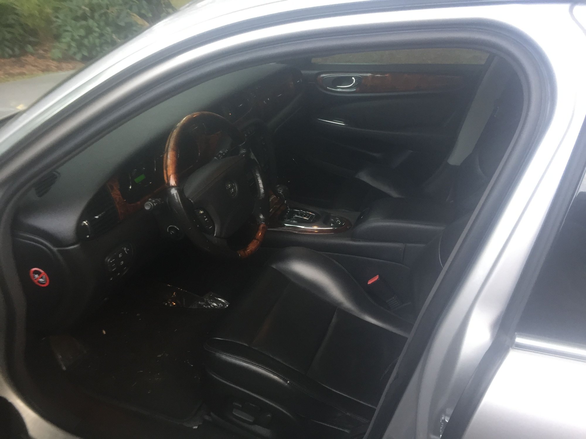

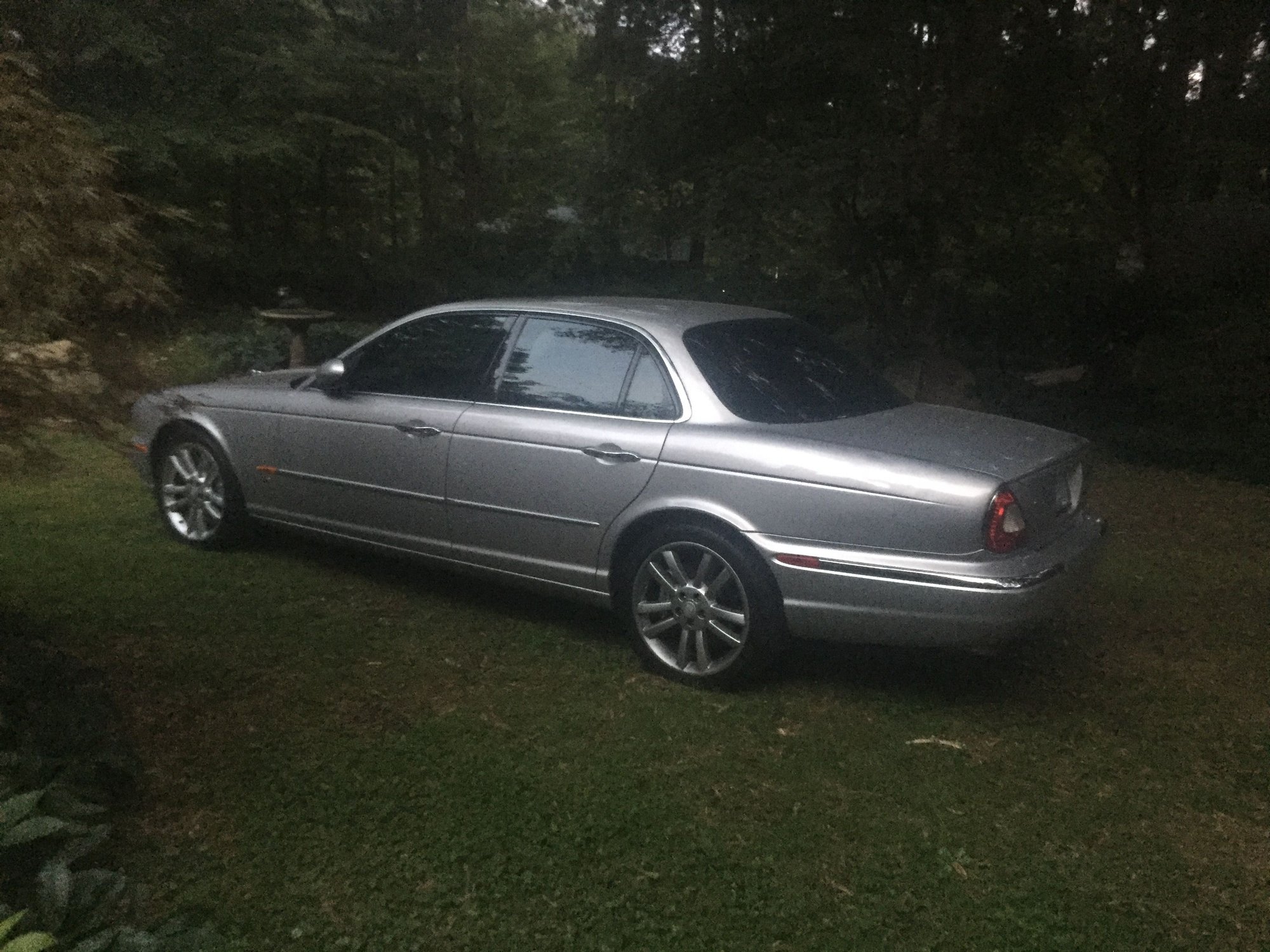

here are the pics as promised...i do have a SRS icon ( code 17 ) in dash and CEL from o2 sensor. I have the new Denco? sensor and just ordered a OBD2 reader online to troubleshoot. It's been driven less then 9k miles since 2016, so i expected some issue to come up as i rolled the miles.

Looks very nice, and if it has been cared-for properly you will enjoy many thousands of miles driving it. Nowhere else do you get an interior like that !

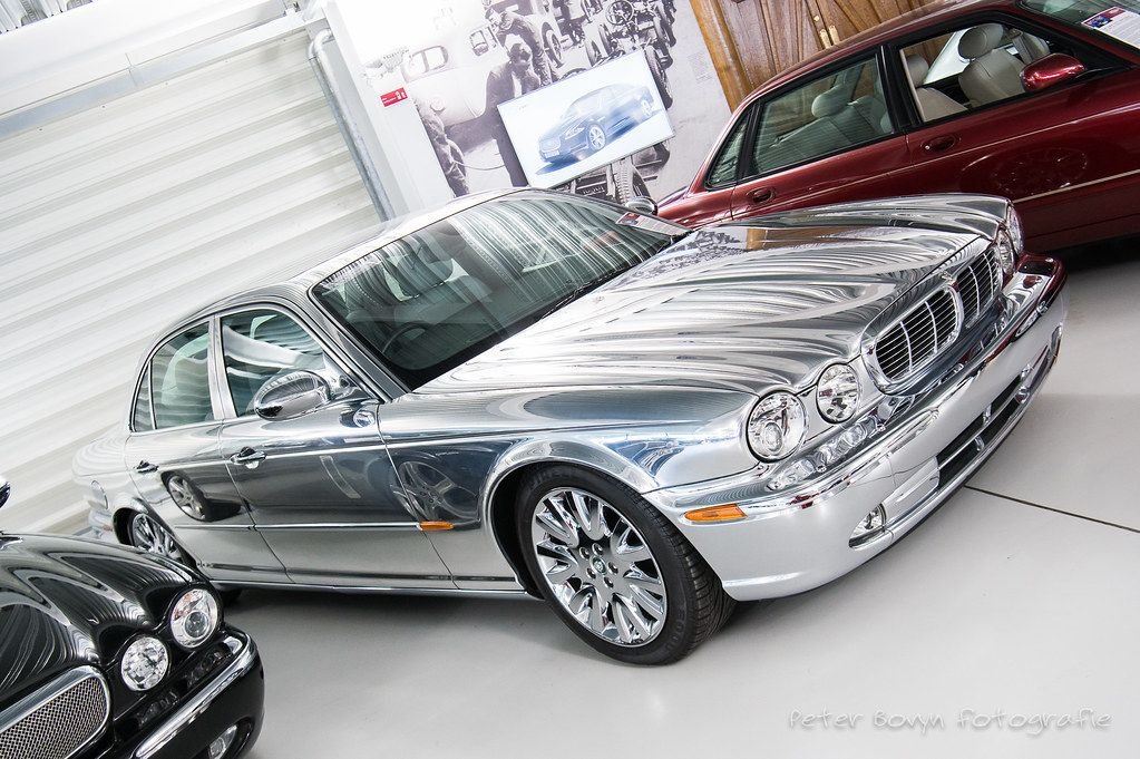

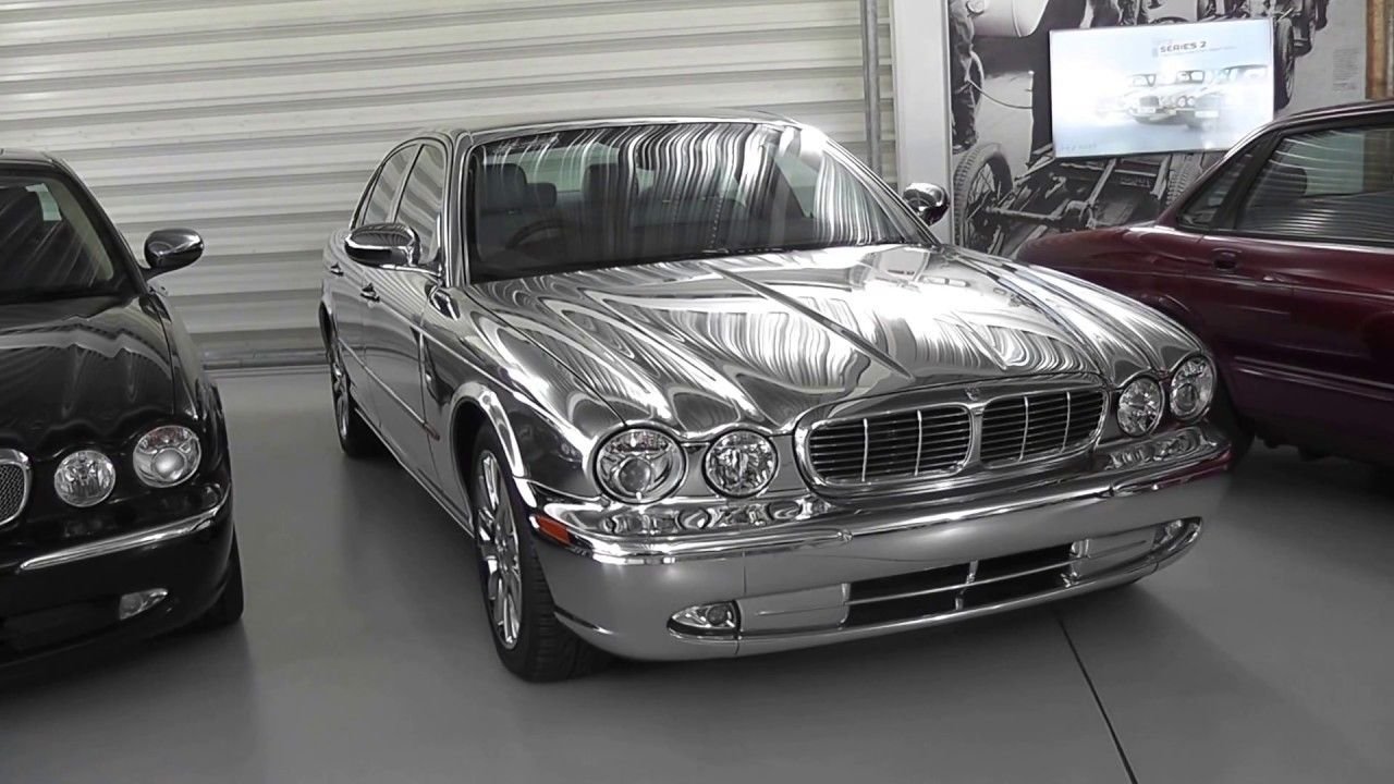

Here's a pic of the fully polished aluminum (aluminium for the Brits and Aussies out there) that Jaguar created to show off the design and a few contemporaneous reviews and some of the development story for your reading pleasure:
I wonder if they made more that one - else why do the museum pics have the early egg crate grill and the Paris show have the stainless mesh... hmmm.
