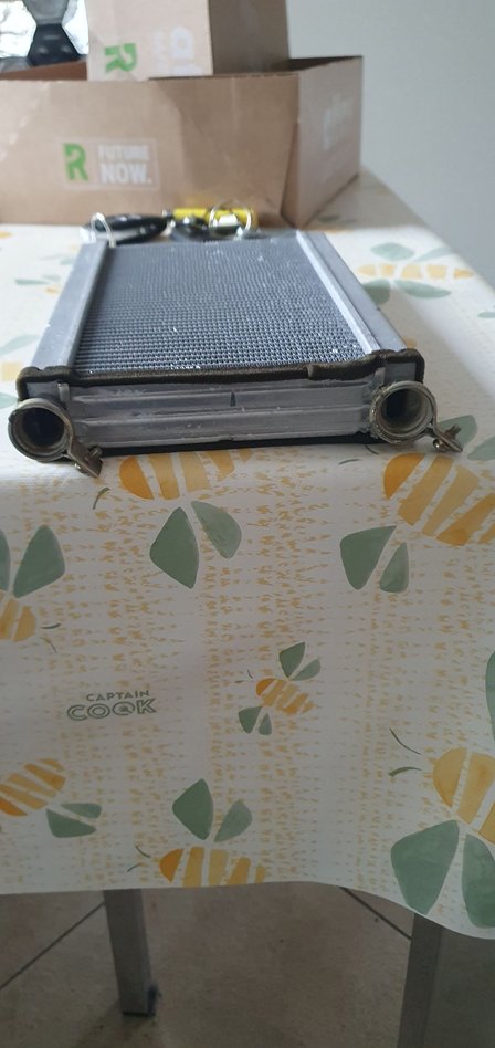

I am about to exchange my heater core on my 2004 lhd xj6 3.0 x350 with barely 145.000km.
After rinsing /force flushing the radiator over 2 transparent hoses connected to a mini pump driven by a drill , once with vinegar and later on with a radiator clean liquid from liqui moly there finally was some heat but barely enough .
had some heat on the right ,cold on the left

The clamps that attach the hoses to the matrix look pathetic.
You can get a kit from the dealer but I don't know if it is any
better than the existing ones.

Replace the screws with bolts, M6 I think they were. They were a royal PITA to remove and no way were they going back.
