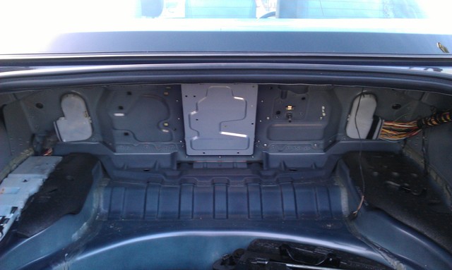

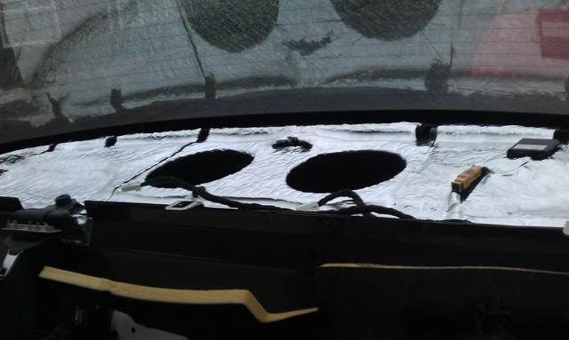

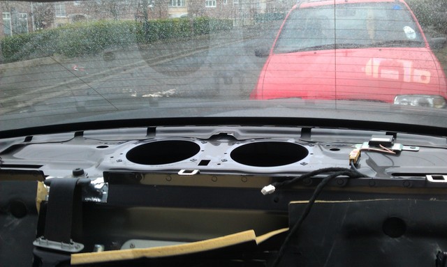

I thought I had taken more photos of this part of the process however it appears I didn't, in anycase here's some pics.
Rear shelf after stripping rear seat/ parcel shelf trim.
Rear shelf after.
Inside the boot, you can see the silver 'ski hatch' panel that I later removed.
That's as far as my photos go obviously spent a load of time on the boot lid itself and must admit it took 2 coats in some areas to get that to stop resonating!
Rear shelf after.
