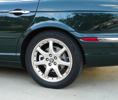

About the drilled/slotted rotors....don't do it unless you are ok with the considerable noise they make when stopping.
I did it and while they look great they suck due to the noise. I will be going back to stock rotors next time.
Attached Thumbnails Perforated/ Slotted Discs on X350-rothwell-5131-albums-brg-vdp-w-18-bbs-monaco-wheels-192-picture-outlanderlugnuts-14093.jpg   Perforated/ Slotted Discs on X350-rothwell-5131-albums-brg-vdp-w-18-bbs-monaco-wheels-192-picture-100-1801-sm-18128.jpg
Nice Pics!Good taste in tires too.I have a question though---are the rotors by ATE?If so which pads are you running with them?
My reason for the question is that I run ATE rotors with Akebono ceramic pads on my Subaru Outback (with Continental DWS tires) and they are quiet and stop very well.On the basis of my Subaru experience I was thinking of going with ATE/Akebono brakes on my S-Type.
I should point out that using factory pads with the ATE rotors was noisy.
