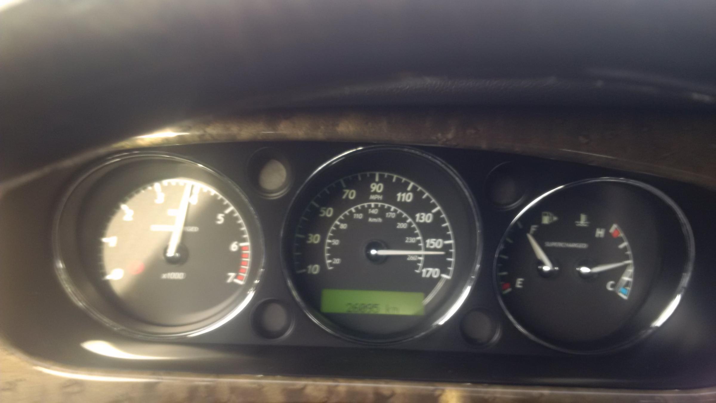

Hi, I just bought an XJR x350 and it has 50.000KM on the clock. It has never been out of London, so I am assuming it has never driven at speeds over 140km/h. I just drove it to Hamburg, and noticed that between 140 km/h and 240km/h there is vibration , it vibrates in the whole car, and only when the accelerator is pressed down, when I let go of the pedal, vibration disappears. Is it similar to your problem? I am now thinking what to do.
many thanks in advance for any help

Guys, I have brand NEW Kumhos summer tires on 19" original wheels. The vibrations i get are intermittent, it is like as if which gear I am in, and how hard I accelerated. I did 600 mile trip from London to Hamburg, and now the Jag is with my German mechanic. I don't think it is the wheels/tires. But I do think it is the stabilisers, bushes and swaybar. Because at high speeds, it felt unstable, and going from side to side . The vibration only when accelarating hard, as soon as I let go of the accelerator, it went away, and not every time

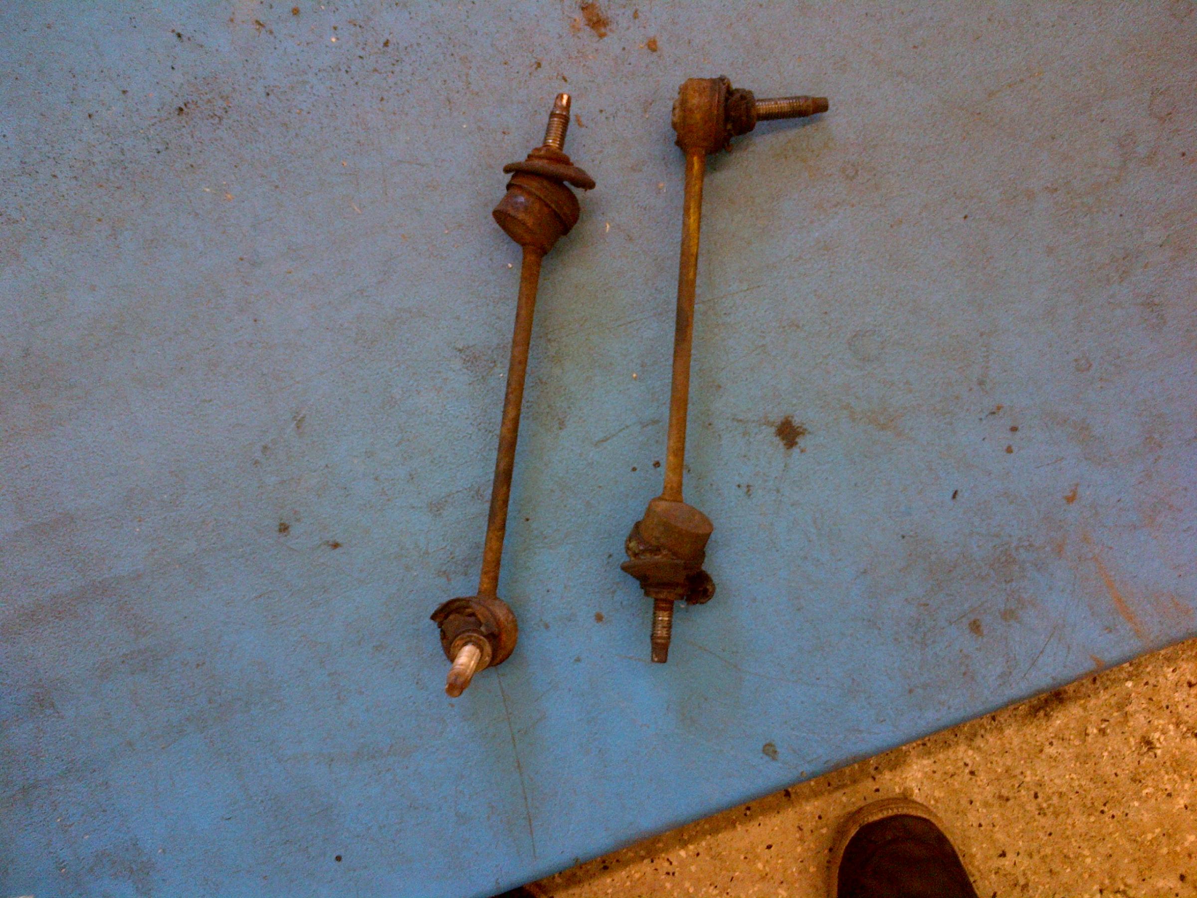

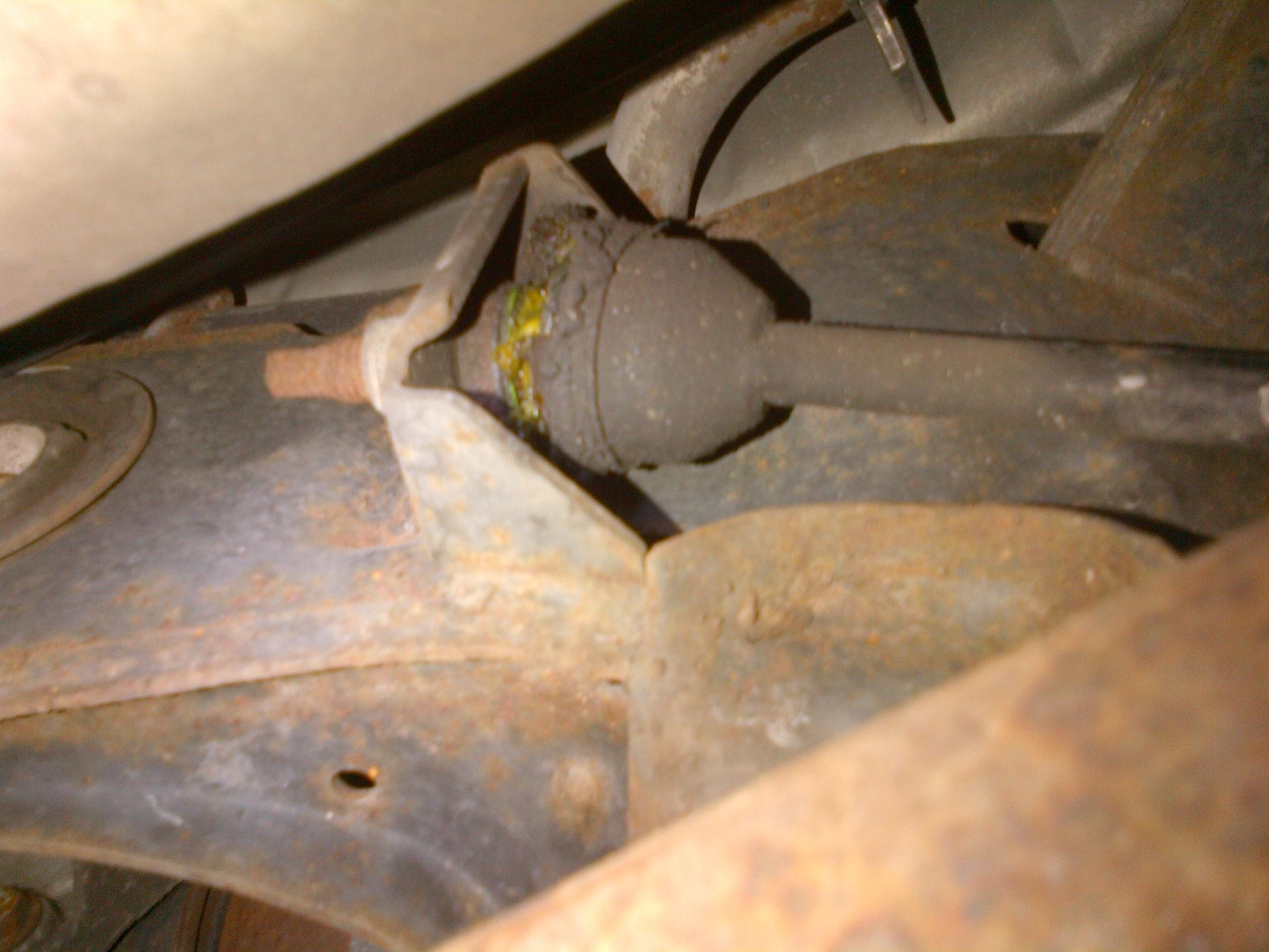

Thanks so much guys. I got it back from my mechanic, it was awful what he found. All the stabilisers, and rubber bushes were rotten, and he managed only to change the two rear stabilisers as I needed to leave back to UK. They made a world of a difference. The car was now like on rails. I did 160MPH all the way to Holland. But unfortunately when was entering the train through the tunnel at Calais, the cat overheated and burst the valve on the water tank. I hope I didn't cook the engine I will post in another thread. But the stabilisers did solve a lot of the vibration issues, but not perfect yet

So this is how the stabilisers look after the very expensive, thorough check at Belgravia Garage here in London
