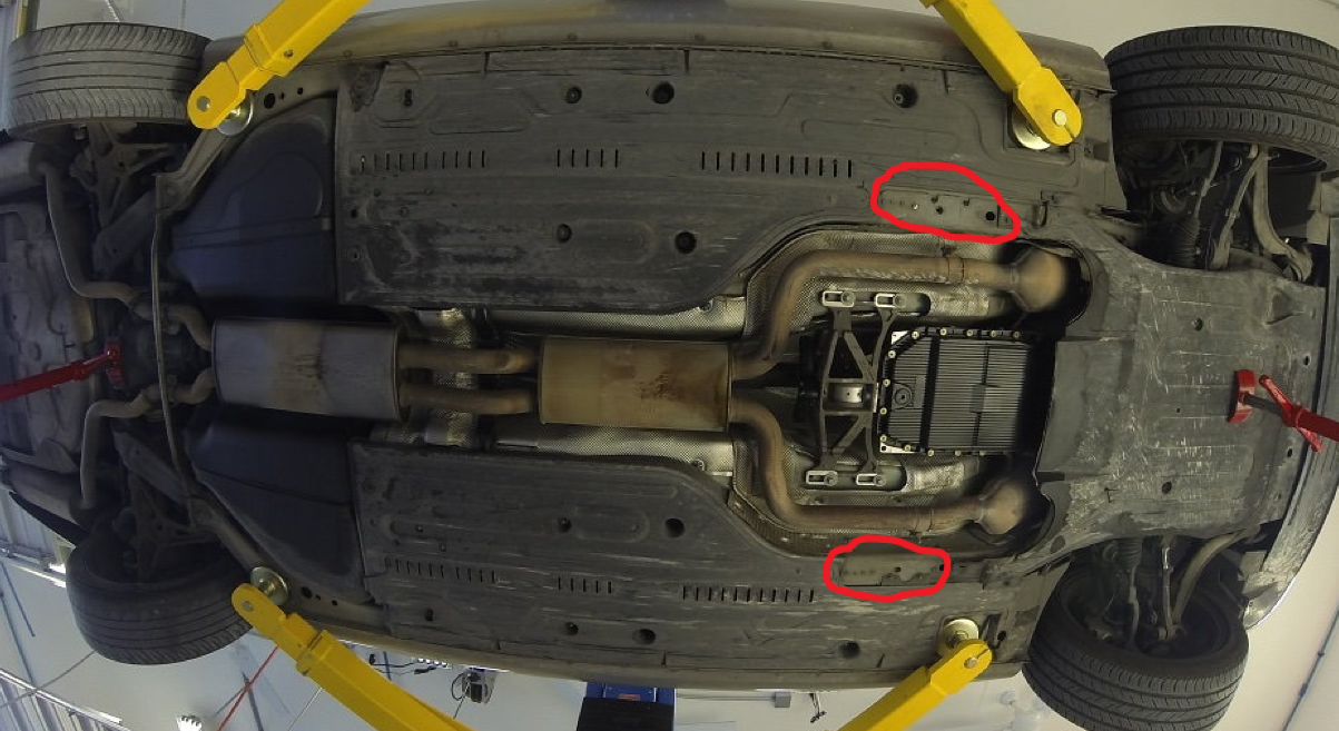

For your first question, the Quickjacks may work longitudinally with those lifting points (although my 7000TL is nowhere near long enough for the XJ8 - even the SWB - to reach both). However, I used a page from the Jaguar manual as my source of truth for where to position the Quickjacks. The page from the manual is below (and the lifting points that I used with my Quickjack are circled in red):
In the other PM conversation I am having with a fellow member, the other member sent a picture showing the car lifted with a two post lift, and which seems to show the front lifting points being ones you describe in your question. It looks like you might be able to use the Quickjacks longitudinally - IF they were long enough - since I imagine the lifting points being used in the two-post lift picture below, are only designed to be used if the whole car is to be lifted squarely at the same time. But with that said, and looking at the picture, I still think the design of the Quickjacks will make it difficult to use them longitudinally, because a) they don't lift the car vertically up, they lift it up and back, or up and forward depending on which way around you have them, and b) one end of the bottom section of each Quickjack - that is in contact with the floor - extends slightly beyond the upper part that actually makes contact with the car, and so the positioning may be hindered by the proximity of the Jag's lifting points to the wheels
Here is the picture that the other member sent to me (and I have circled the front jacking points that I used - horizontally, not longitudinally, in red): The picture does a good job of illustrating that front to back, the lift points are too widely spaced/misaligned for the width of the Quickjack, to be able to use the Quickjack longitudinally between those points).
Hope this all makes sense!

Thanks so much, Steve, for providing such detailed info; you have really clarified things.The diagrams and pictures are invaluable.
Because my R is approaching 20 years old, & I'm no chicken, it would be great for both of us if I could find the "best", within reason, method of hoisting her. A thought that intrigues me is to procure 4 - 14 x 14 oak blocks with a metal resting point dead center under each jacking point. Also, I believe soil conditions under my garage floor are such that a bay could be dug in the floor; this would require extensive structural concrete work, etc. & I can't imagine a time that would allow such a mess. However, these are subjects for another thread.

Hi, @wolvesfan , when you lift car with quickjacks perpendicular to car's long axis, I would expect car to slide relative to quickjacks while wheels still in contact with floor. Does this motion kicks rubber pads from under support points? Or, do you do something to preempt car sliding on quickjacks? I can see how lifting by pinch weld may be not an issue. With transfers arrangement, there are some questions. Whould it be too much to ask you to post a quick video clip next time you lift car with quickjacks?

Hi, Big Koshka,
I get what you're saying but it wasn't an issue for me. I'm sure there's a scientific explanation around radial shift, but from what I remember, the first few inches of QJ travel were more vertical than radial, which just took the weight off the wheels enough so that by the time the radial shifting got going, there wasn't as much friction between the tire and the ground to cause the sliding issue you were asking about. None of the rubber mounting blocks (three of them) or the piece of 2x4 I used across frame of the front QJ because the QJ was longer than the gap between the inner mounting points, shifted or moved or otherwise caused any issues. I also Googled about using the QJ laterally beforehand - and I think they even mention it on the vendor's website - and couldn't see any mention of potential sliding issues.
Hope that helps. Good luck with the suspension job! As far as purchasing the QJ's. I have no regrets. They're one of those things I consider as "better to have and not need, than need and not have"
Edit: No plans to lift the car any time soon but will try to remember to video.
Further Edit: It goes without saying that the QJ's have to be parallel to each other - whether you use them laterally or longitudinally. I just used a tape measure to measure the distance between the respective ends of each QJ - and nudged them as needed until the gap was the same (give or take an inch) at both ends - before starting the lift. If they are not parallel to each other then something could, and probably would slide, for sure.
