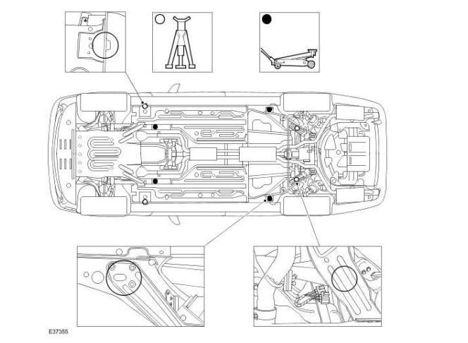

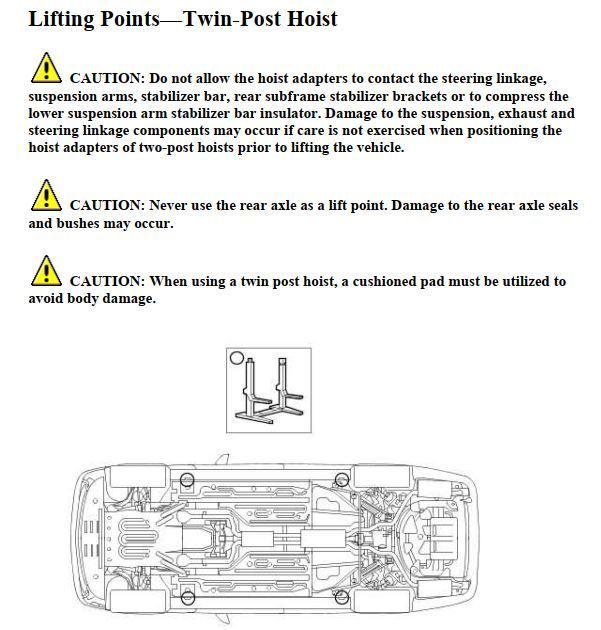

My mechanics garage has a hoist that has four figures that lift from the sills. I see where the lift jack points are, do the fingers have to be very close or is just close ok?

with a rack use the pinch welds they have arrows pointing where you need to go.
with a floor jack you need to use the front frame rails next to the cat. rears you just sort of use the aluminum subframe sandwich point

Here are the diagrams from the manual
Lifting with jacks
Lifting with a 2 post lift
Hope this helps
