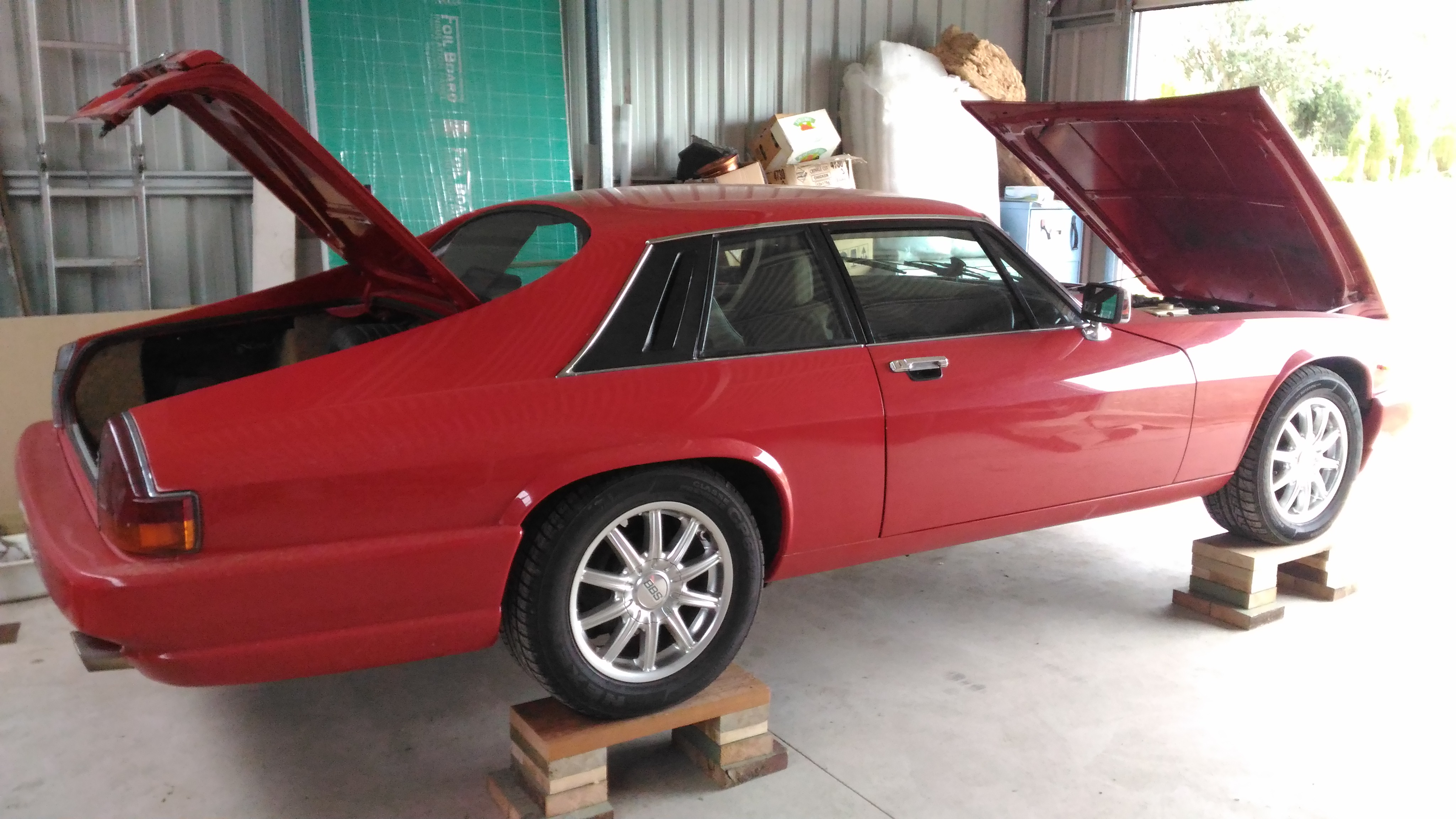

A must in an XJS DIY owners tool shop should be a high lift low profile floor jack, mine is 75mm low and 500mm up. I can get it under the subframe with a block.
I do not use jack stands. I use wooden platforms under the wheels, this way I can get the car up as high as I need
Attached Thumbnails How to jack the XJS-p_20160808_090145.jpg   How to jack the XJS-p_20160810_130125.jpg
