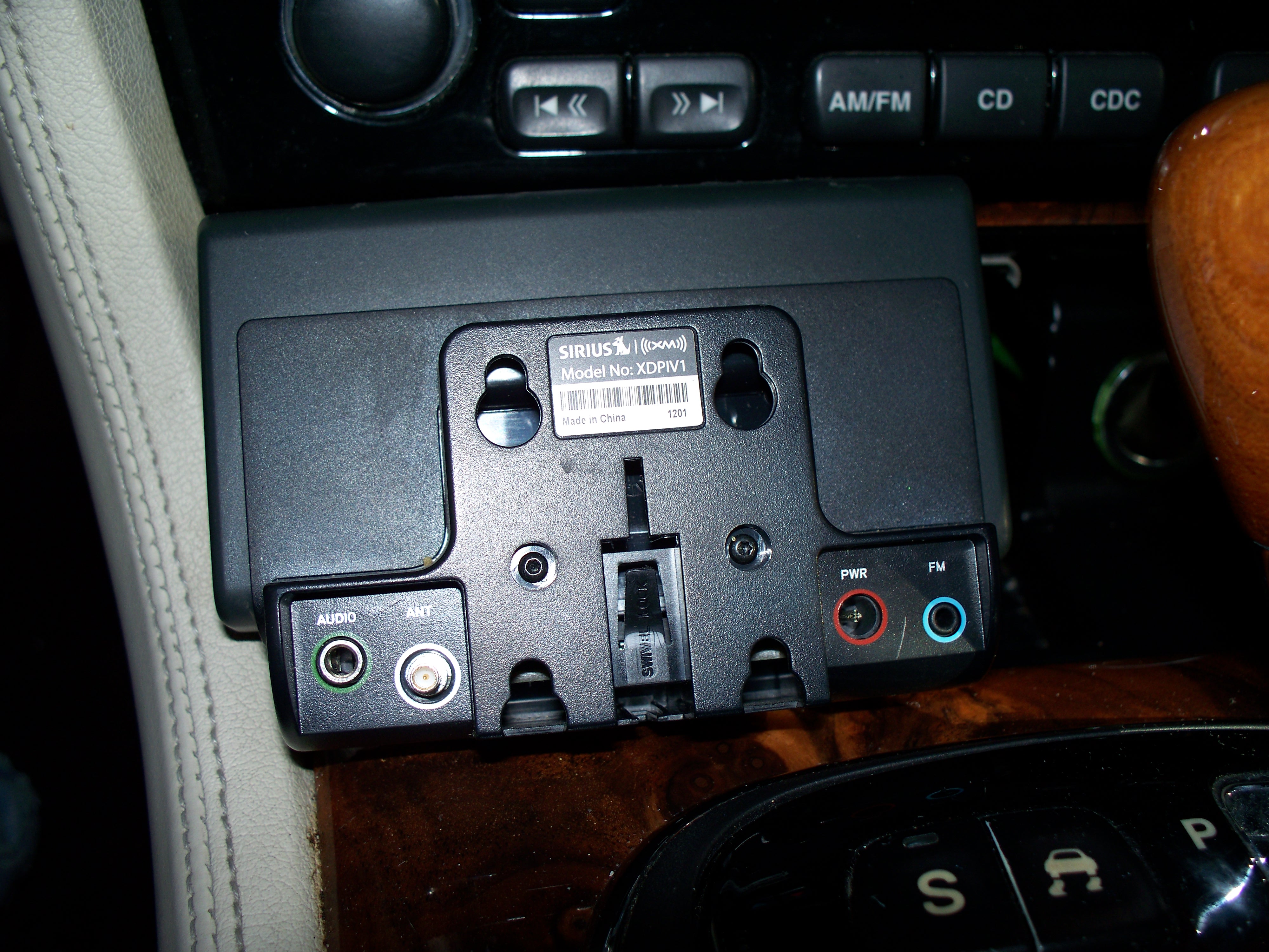

Is the antenna assembly under the left side panel where the CD changer/DVD player/GPS are? I have very poor radio reception and the car had a non-dealer installed siriusXM radio that I do not use and it was suggested there might be an antenna switching device that is disconnecting the OEM antenna.

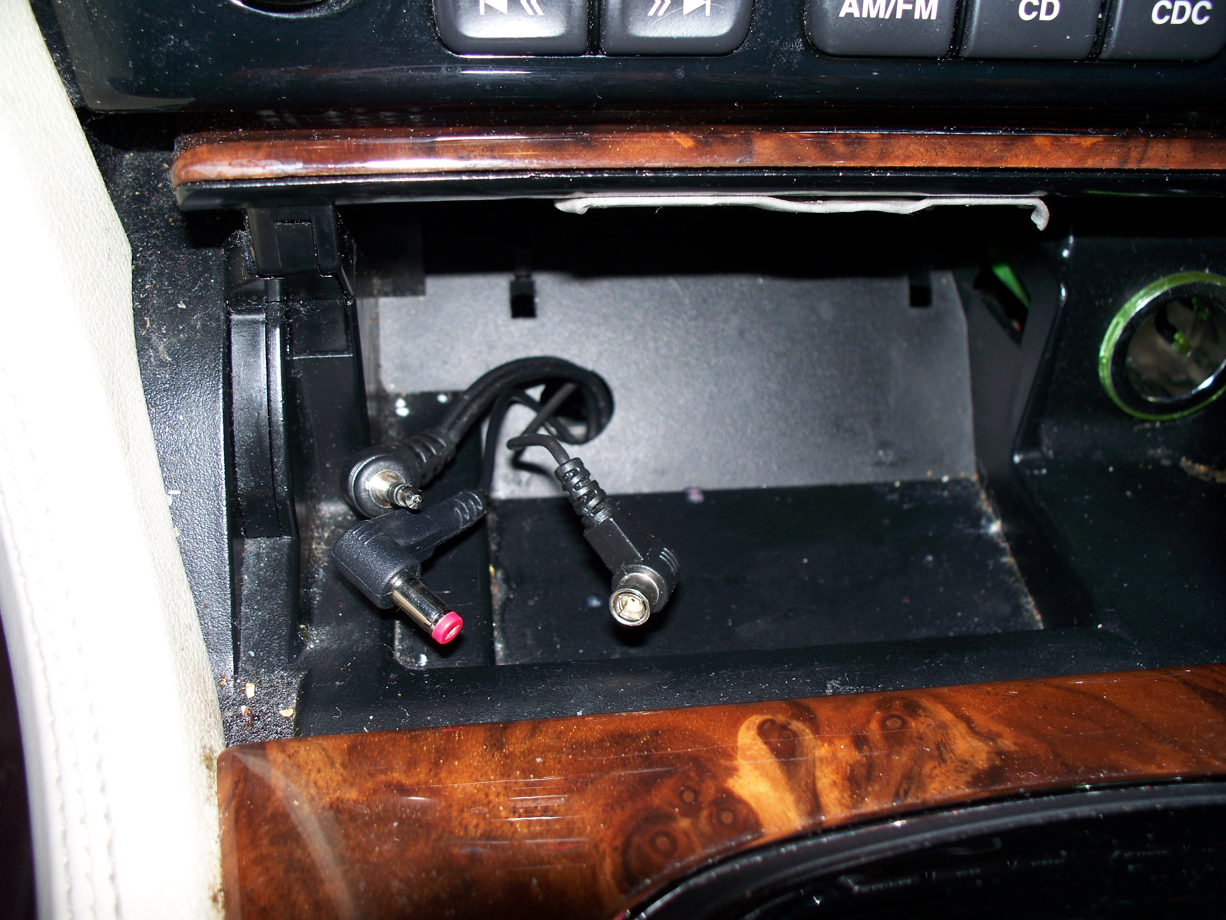

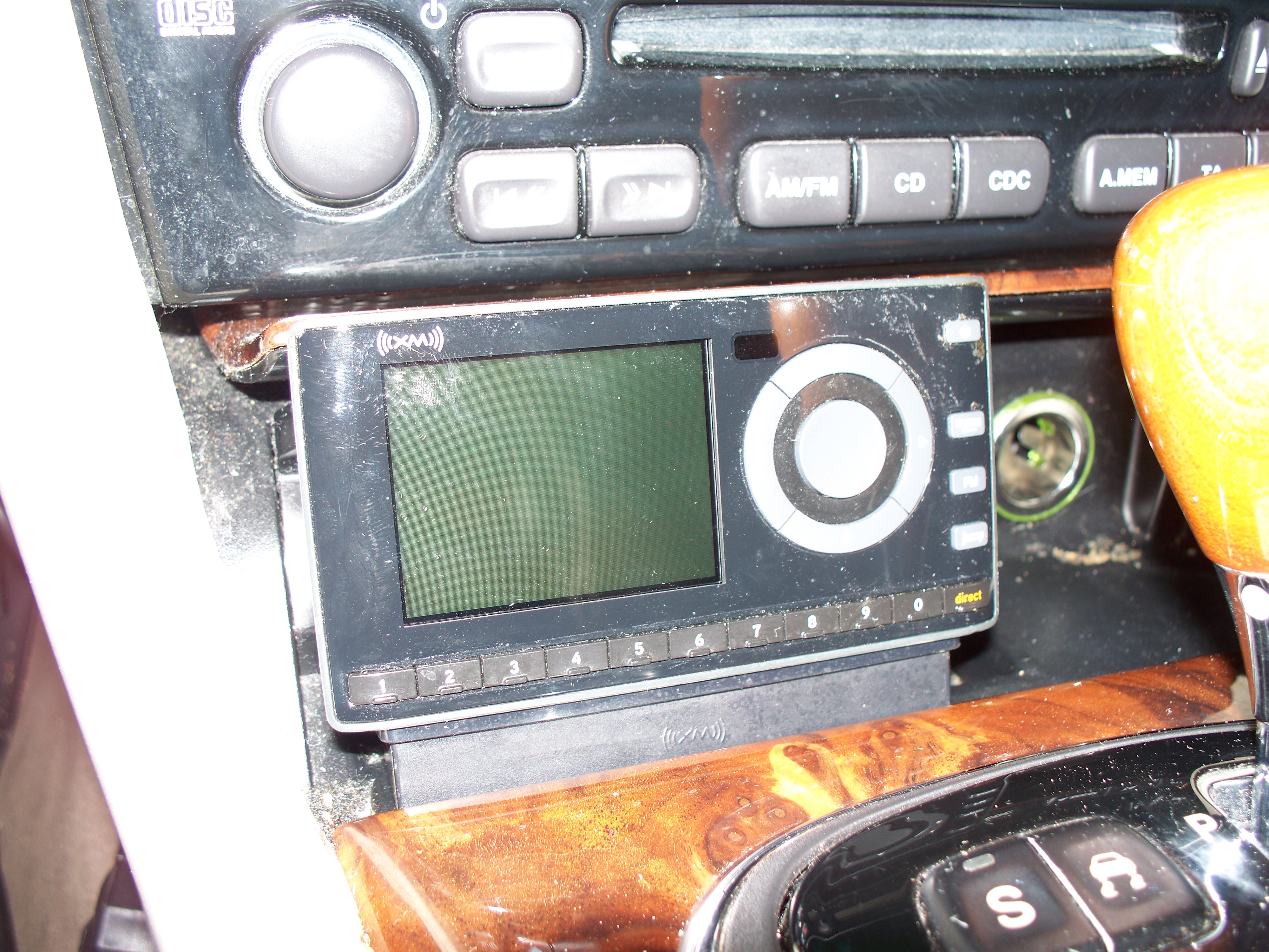

The back of the radio unit says model XDNX1 and on the holder it says XDPIV1. There are three wires in the ash tray area that plugged into the holder.
The unit will come on with a display, and I had read somewhere that Sirius would allow a free trial period to folks who purchased a car with the radio installed, but when I went to their web site to apply it said a trial was not available for my radio so I disconnected it. My wife is not that into listening to a radio while driving, and I myself prefer the CD changer, but it would be nice to get some local stations now and then.
I had also read that the antenna switcher might be behind the dash, but I've not pulled the dash off yet - will need to do that to replace the clock lamp, but have not attempted it yet.

Phil, read my post in " poor reception" today. The unit in your photos was installed by some hack. Not the Jaguar afterthought. I would rip that piece of junk ALL the way out. Then make sure you have no other units in line between the head unit connection and the connection module located behind the "C" pillar. check for continuity from front to rear. It should should be one line from front to rear. I think you will find your issue fixed, and be happy without that monster unit in your beautiful dash. Then you will beable to close the ashtray.

I read both and the installation pdf was a lot more involved than I would have thought. Are all the pdf locations the same for the XJ? I'll try disconnecting the power and control wire from the unit in the boot first (behind the right boot side panel, right?) and see if my reception improves.
BTW1, I had just set the sirius unit back in the ash tray for the photo; the ash tray is otherwise clear except for the remaining sirius connectors which can be pushed back to the hole in the back as in the first photo. Since we don't smoke the ash tray is a recepticle for pens when closed and a place to set spare reading glasses when it is open to keep them from sliding around - kind of an auxiliary to the very limited space in the center cubby.
