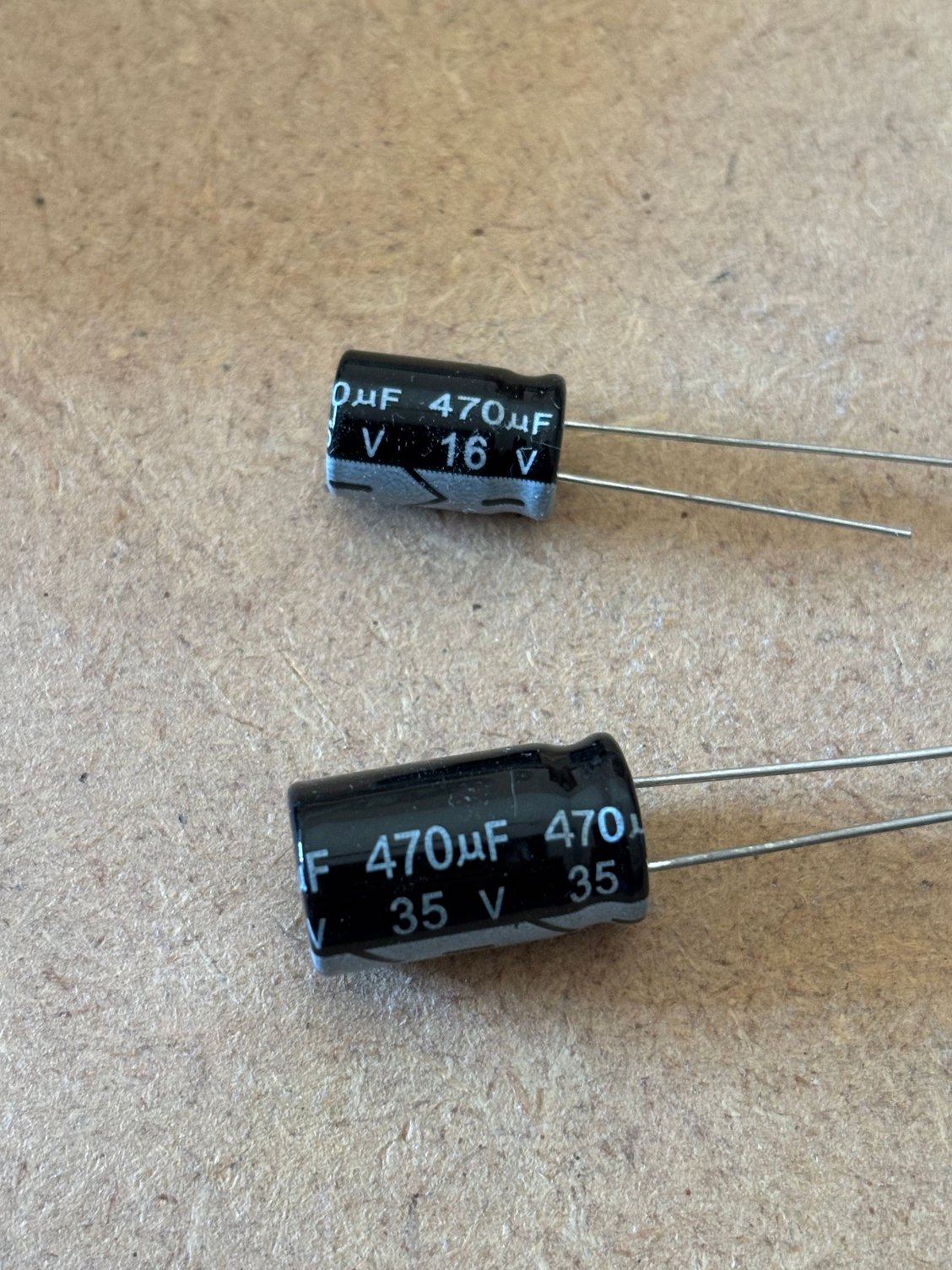

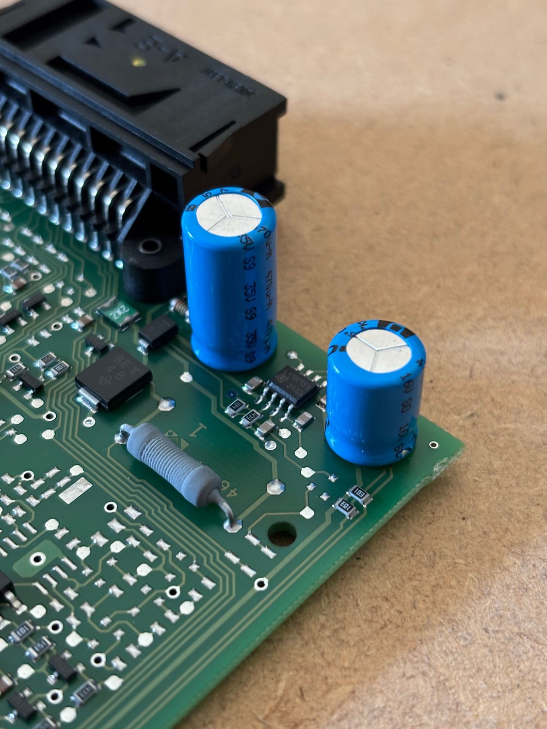

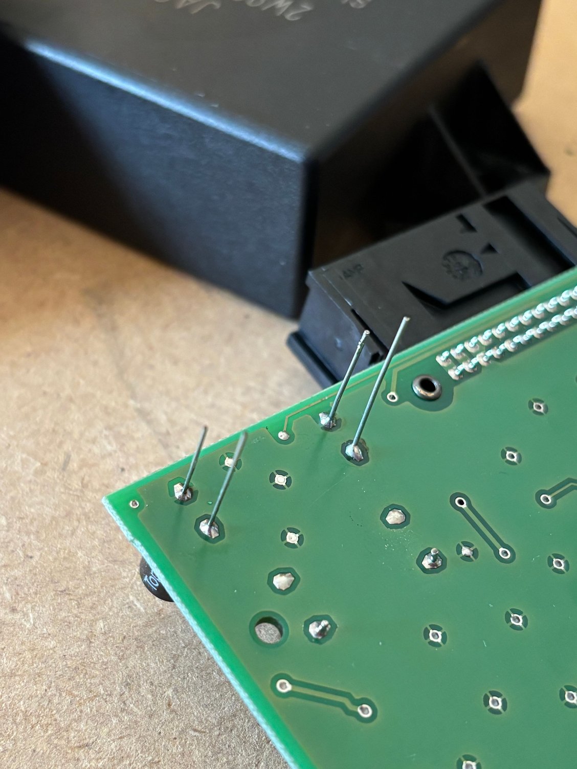

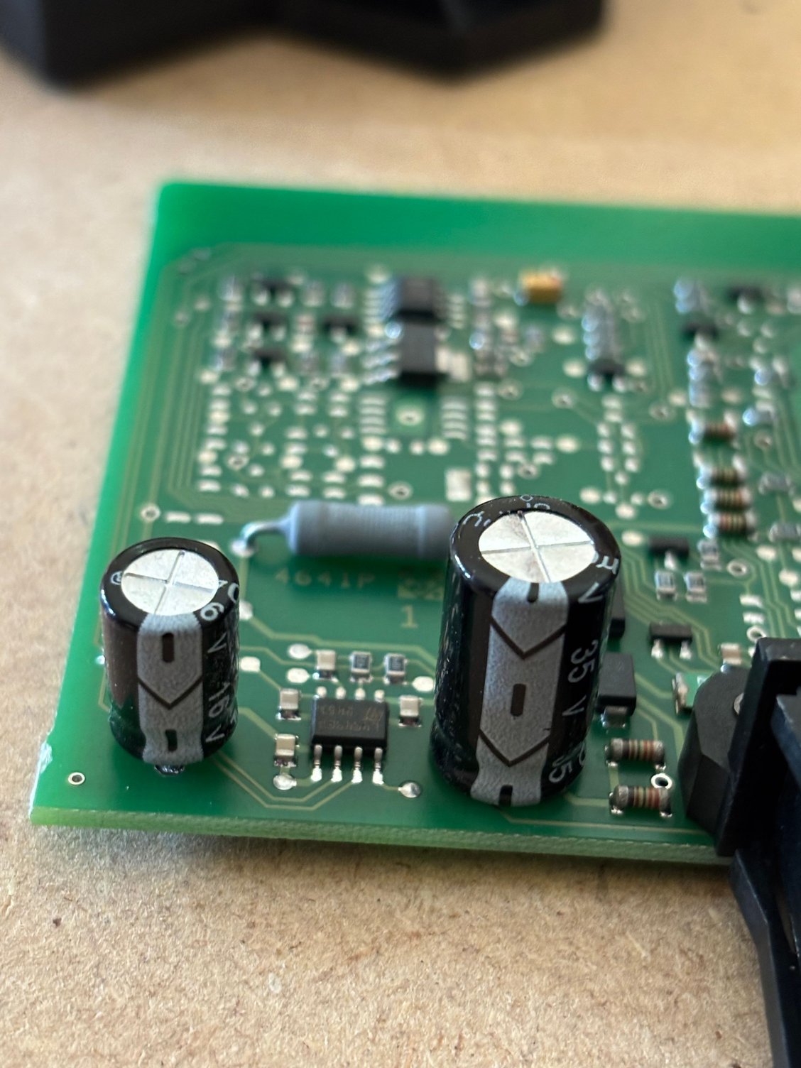

  • Goose chase part 2: Opened up the module and checked for obvious signs of wear replacing the two large capacitors on the PCB as it was the only thing I could think of that can fail in cold temperatures especially if worn out. Nothing, nada, zip! But I have a renewed module now I guess...

Capacitors replaced on the module PCB:
