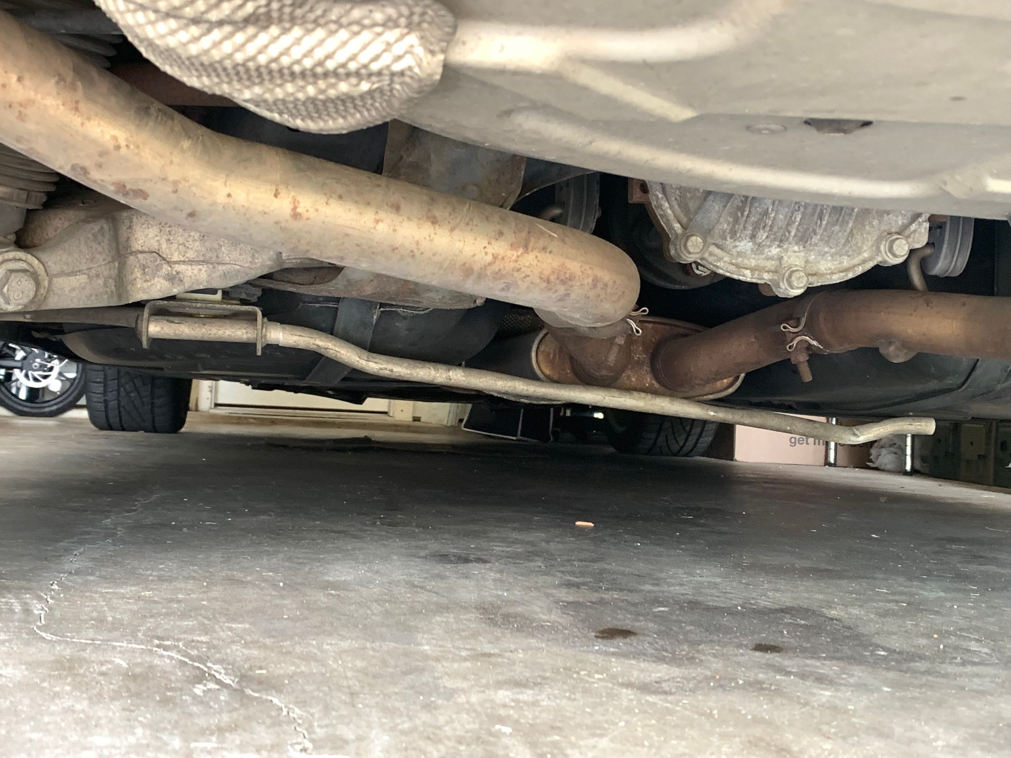

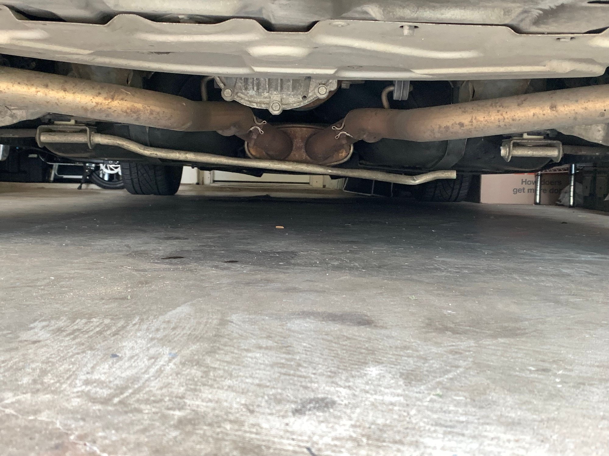

Had my car towed when I moved down to TX.
I think the tow guy strapped the car down in the rear using what to me looks like the rear swaybar. I noticed it hanging down under the rear axle today when I was parked.
does anyone know if this is the rear swaybar? It seems very thin aluminum to me to be a swaybar.
Any ideas what else it is? It dowsnt connect to anything else on the ends that I can see.

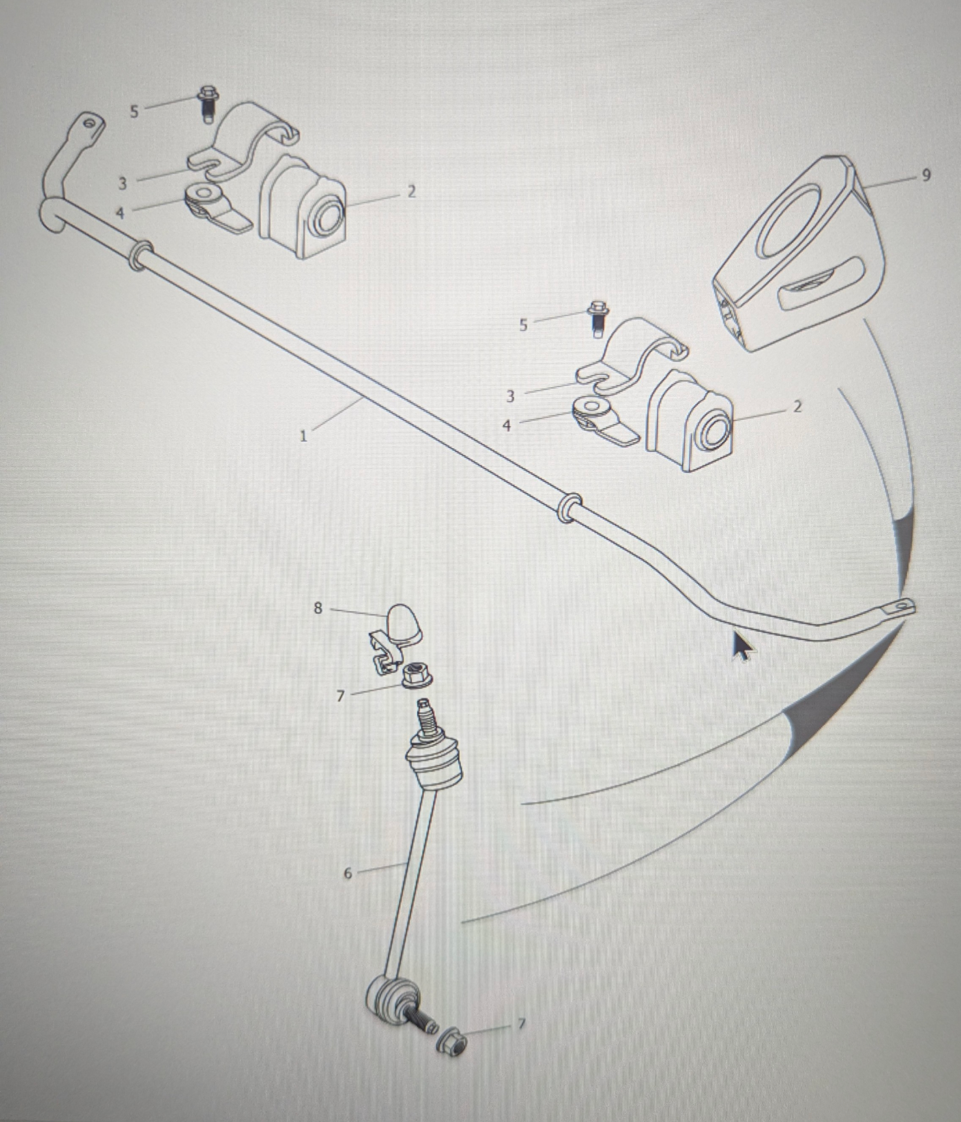

That is not the sway bar but I have to look at the parts fiagrams to see what it actually is
Attached is the actual rear sway

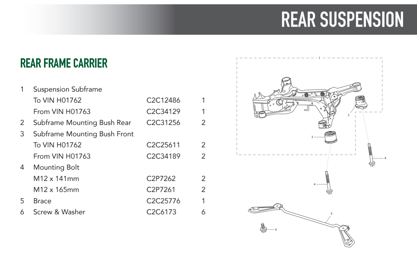

I think it is #5, a rear brace. That whole part may be replaced easily, but it is raining here so I can't take a peek under my car.
Reply 2
Jul 6, 2025 | 07:27 PM
Quote: I think it is #5, a rear brace. That whole part may be replaced easily, but it is raining here so I can't take a peek under my car.
Thats it! Super thin aluminum. Thank you!

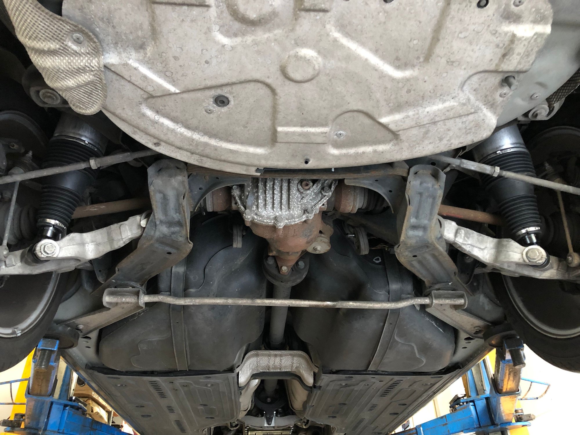

Jul 7, 2025 | 10:54 AM
If I were you, I would claim the towing company. The guy should have known that that is not the place to use for towing purposes...

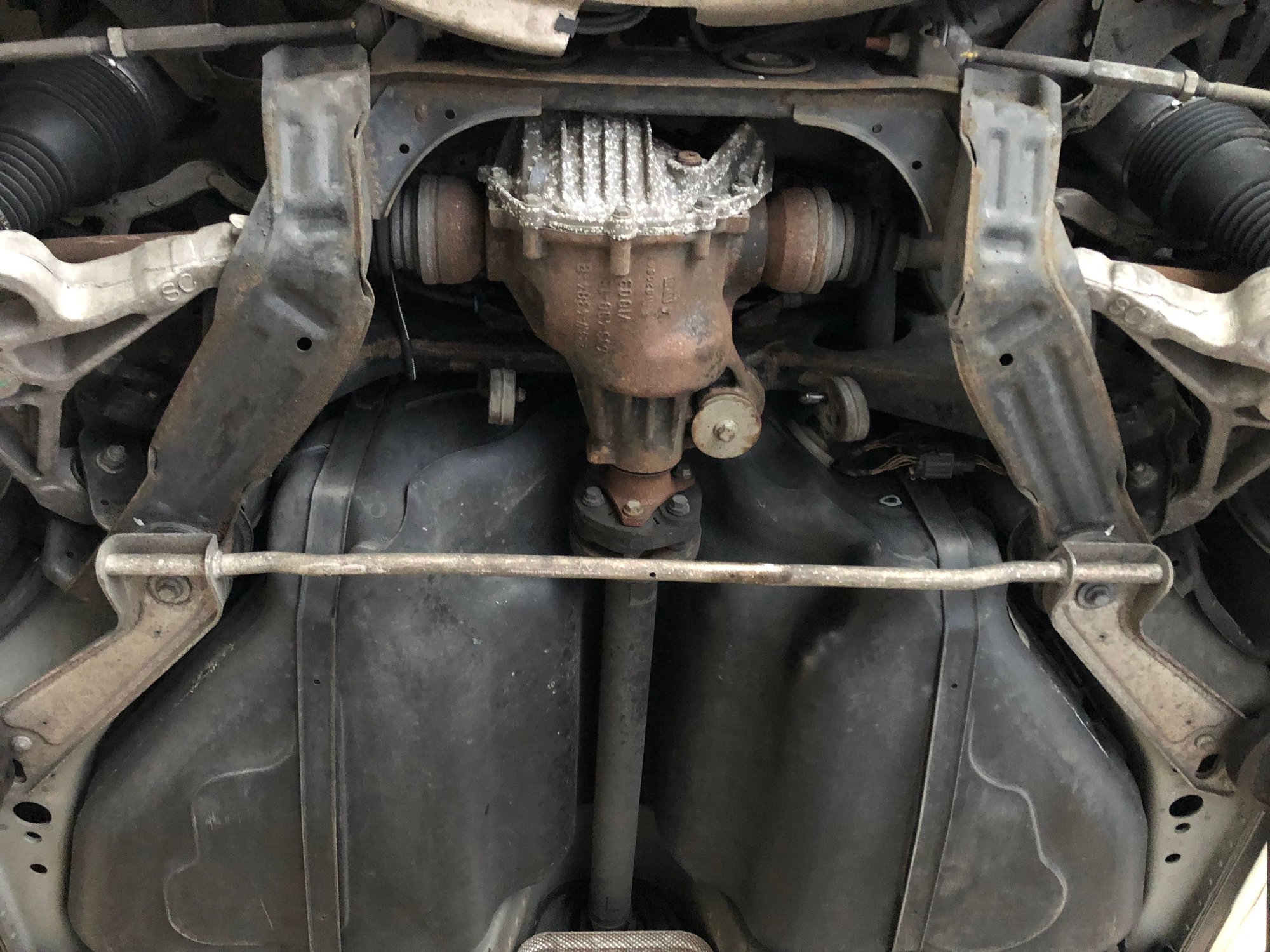

This is how the brace looks like in reality:

If I remember correctly, I took the pictures while replacing one of the catalytic converters, and for doing that, for me the easiest way was to remove everything and put it back on afterwards. The brace that got damaged on your car is actually very helpful when dismantling the exhaust system, as you can use it as a helpful hand for the middle silencers...
