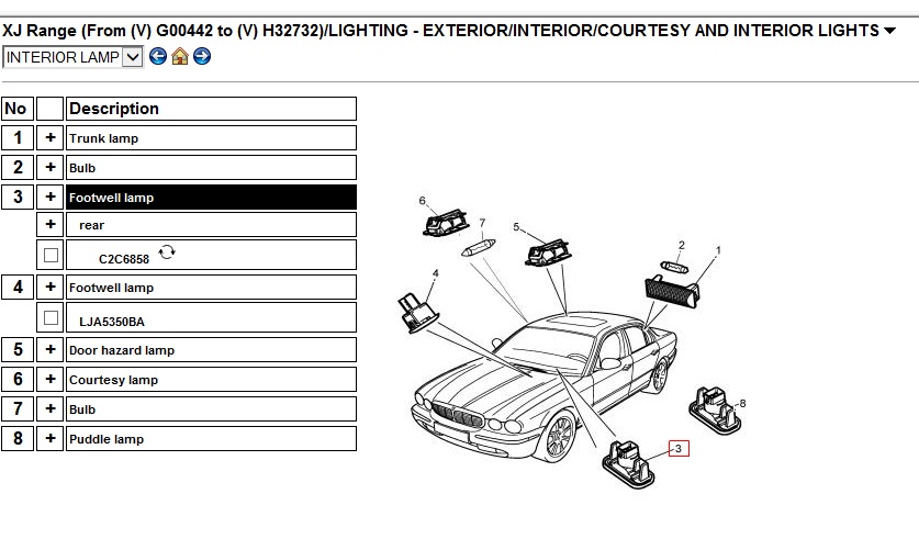

I would like to replace the bulbs in the rear foot well lamps with LED's. They are festoon style but does any one have a part number or bulb number, since the festoon bulbs are made in different lengths.

Footwell Lamp - Rear: Part Number C2C6858.
