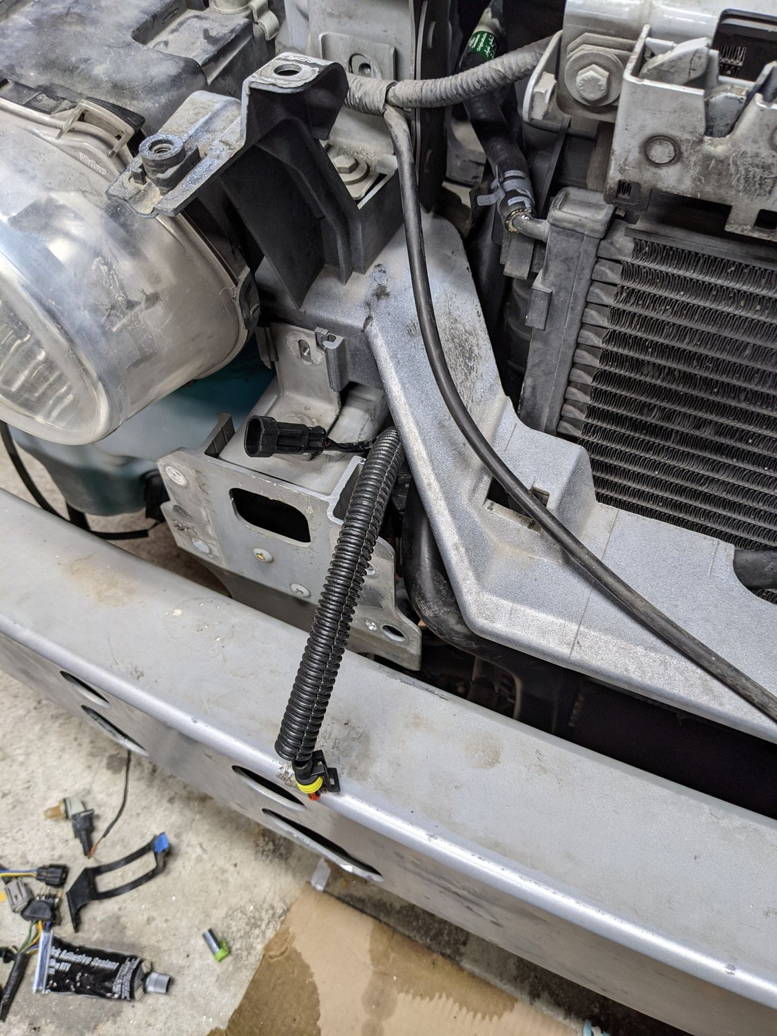

Originally Posted by jazzyjags
Did you get any pictures during the removal?
Bumper is still (mostly) detached, so I just grabbed some pictures (sorry, they are very large). I believe the suspension air pump is attached on the driver's side (something heavy is there) and so I undid all the bolts save one bolt on the driver's side. I need access to the passenger side, so with one bolt in place I can drop the bumper down. Here are pictures with the bumper beam dropped down, the rivets identified. With the beam dropped and the plastic cross support that holds the headlights removed (I haven't done this yet -- tomorrow) I believe access to the heat exchanger inlet and outlet goes from difficult to very easy. I'll know more tomorrow. Once you have the rivets mostly drilled out, a pry bar makes quick work of easing the beam free.
