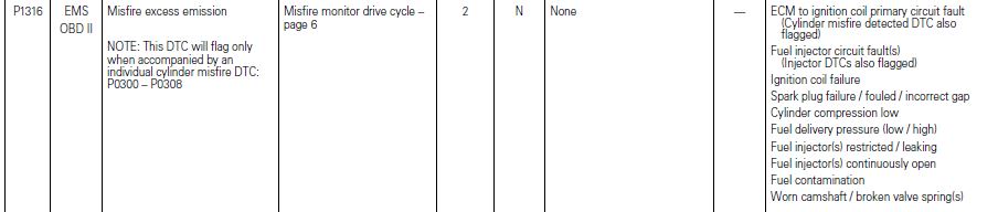

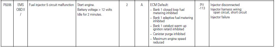

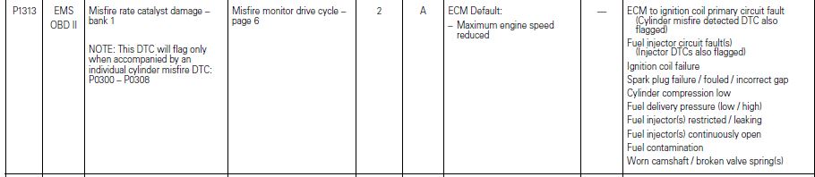

I have pasted below the code from the Engine Control Guide. For futur reference you can go to this link and download the guide. JagRepair.com - Jaguar Repair Information Resource
You have a circuit malfunction for injector number 5. It is the second cylinder on the front left hand side when viewed from the rear of the engine.
I would first inspect the wiring and plug for damage or corrosion before condemning the injector. If they are all good then the injector needs to be replaced. Try not to drive until repaired as you are causing damage to the catalytic convertot.

Thank you! per the 1313/16 codes could it be the ignition coil that seems to be a common issue rather than the injector?
