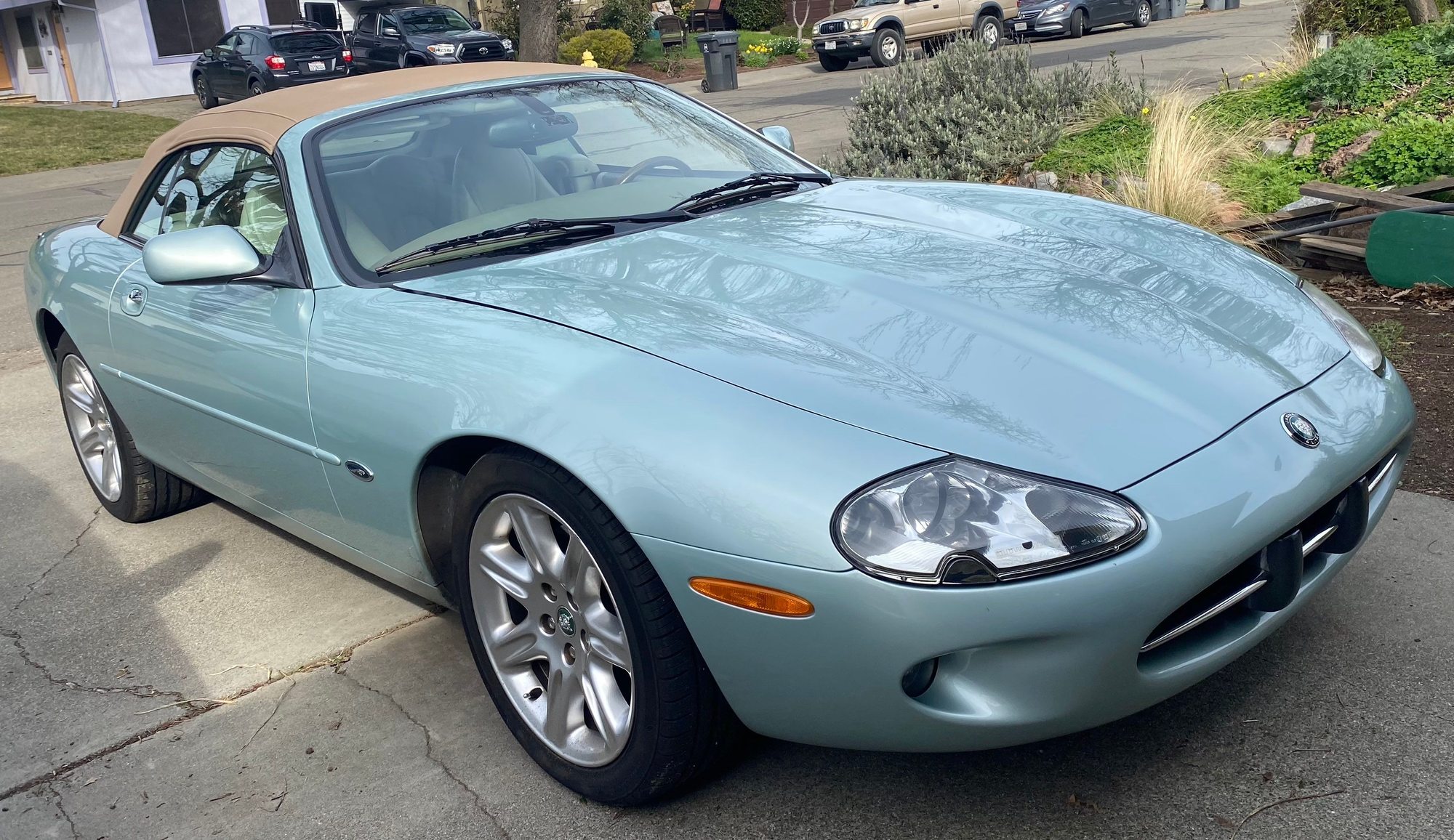

Haven't started the car for a week. Now have an oil leak coming from the left rear side on the engine. Maybe a valve cover gasket.
So I've got a 2000 Jag convertible that looks great. Distinctive color, flawless paint, perfect top, nice interior. CA car w/ 75k. Starts but RP/yellow/now red. One short slow test drive. Didn't know I wouldn't be able to pull codes. Guesstimate on repairs (tensioners, maybe coils, minor stuff) is 4k. Paid too much so I'd be in for 8k. Hard to say if this is worth doing. Googled and see many similar cars listing for 15k.
you're posting in the wrong place
go to the X100 forum

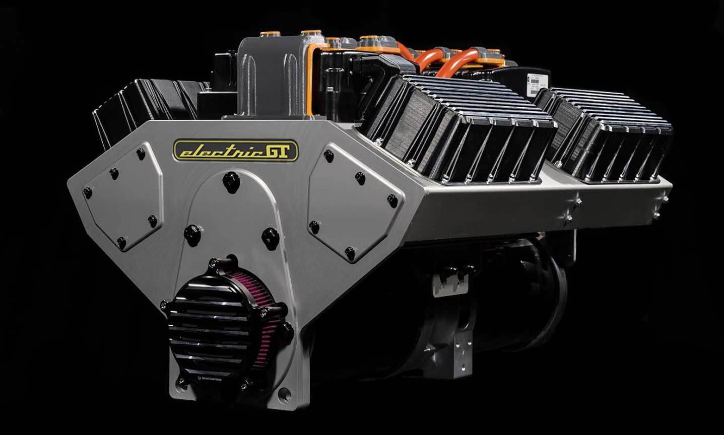

This is an off-the-wall suggestion. Perhaps not relevant to this particular car... but.
In the old days, the Jag engine was pulled out and replaced with a Chevy crate motor and transmission. What would happen if you took it to a hot rod shop and yanked the whole thing out and installed a Ford crate motor? This was the Ford era, and the X350 XJ6 is a Ford motor, so it's not too much a butcher job. In the end, an X350 is still a mechanical beast. Find out what needs the ECM and ditch it. Of course in some locations, like California, this breaches the law, which then introduces option 2
Option 2: If you are looking forward to the day ICE are banned, do this. Upgrade to electric. There will come a time when the extraordinary aluminium body of the X350/358 will be recognised for the outstanding technology in the body, and the style will be super cool.
