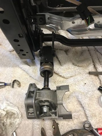

So I found a few posts about this problem but no solutions
This morning I took the motor off, took the gearbox off the seat frame and found that the screw gear from the gearbox to the seat lever was jammed at its extreme position.
Grabbed the screw drive in a pair of pliers, using a couple of layers of cardboard to prevent damage to the gear and worked it back and forth and eventually it freed itself.
Worked it in and out a few times, lubricated with silicone grease and reassembled;
This shows the gearbox off the seat frame which allowed me to grip the shaft and work it loose again
So this shows it all back together again
Hopefully when the seat goes back I'll have height adjustment of the rear of the squab back again.

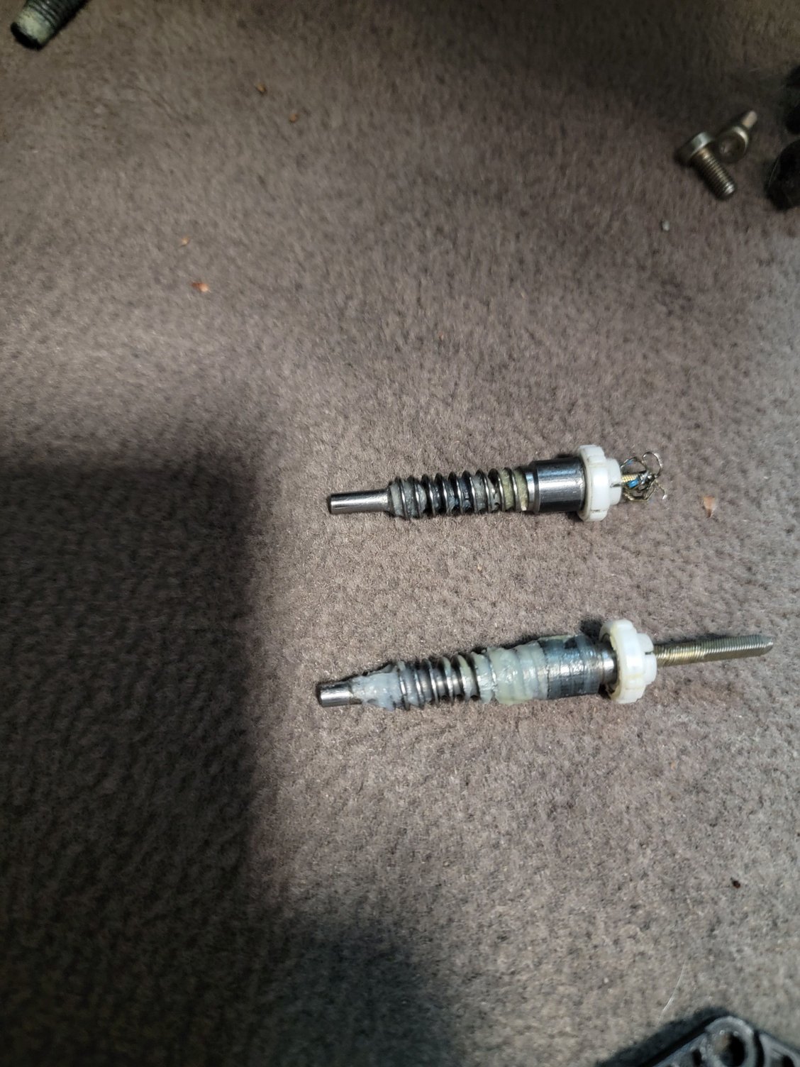

Finally got around to investigating why the back of the seat squab would not go up and down.
Symptoms were that I could hear the motor running when moving the switch, but no movement of the seat. All other directions were working.
Freed seat from floor, rolled it on its side, removed the three T40 holding the gearbox to the seat rail, then two T20 that held the motor to the gearbox. Found a chewed up square drive cable.
Went to scrapyard and removed one from a passenger side seat (Jag catalog says the whole motor/gearbox is handed and so different part numbers for left and right seat, but I figured, correctly for once, that the drive cable would be the same - and more chance of passenger seat being in better, less used condition).
Installed that, and freed off and lubricated the threaded drive rod (probably the original source of the jam that caused the drive shaft to get chewed up) and all seems well, now I have loads of headroom and my knee does not hit the key.
Hopefully the photo below is self explanatory.
So if the motor runs, then this is likely the issue. If there is single clunk when you move the switch in either direction, it is probably the threaded rod that is seized, and if there is nothing, start checking fuses, wires, connector, motor internals etc.
Good luck.
Broken and okay versions of the drive shaft.
