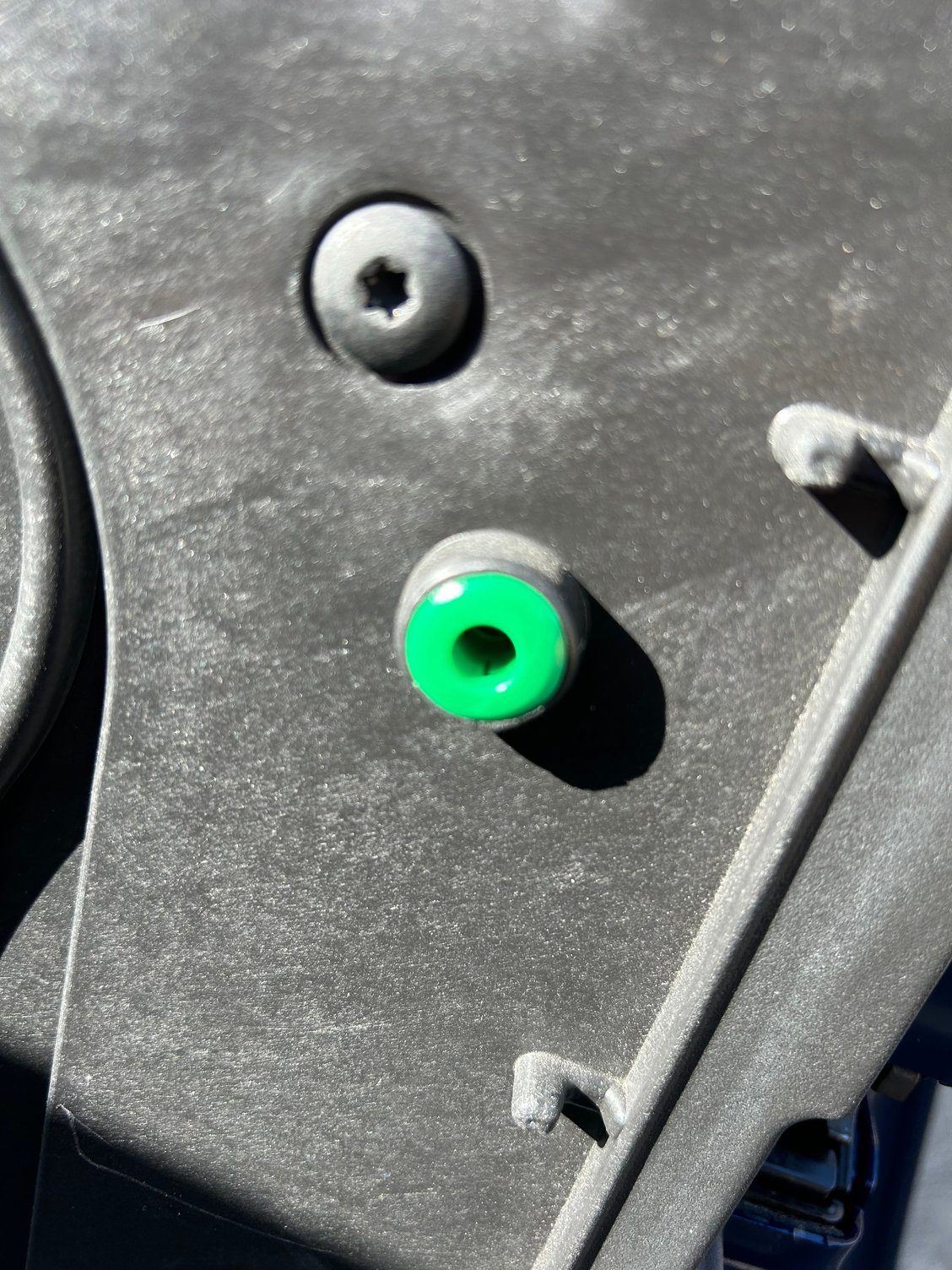

The mirror has been reinstalled. In removing the plastic trim that covers the mirror nuts, I highly recommend unscrewing the torx bolt below it on the inside of the door so that you can slide the trim piece free rather than forcing it out and likely breaking it in the process.

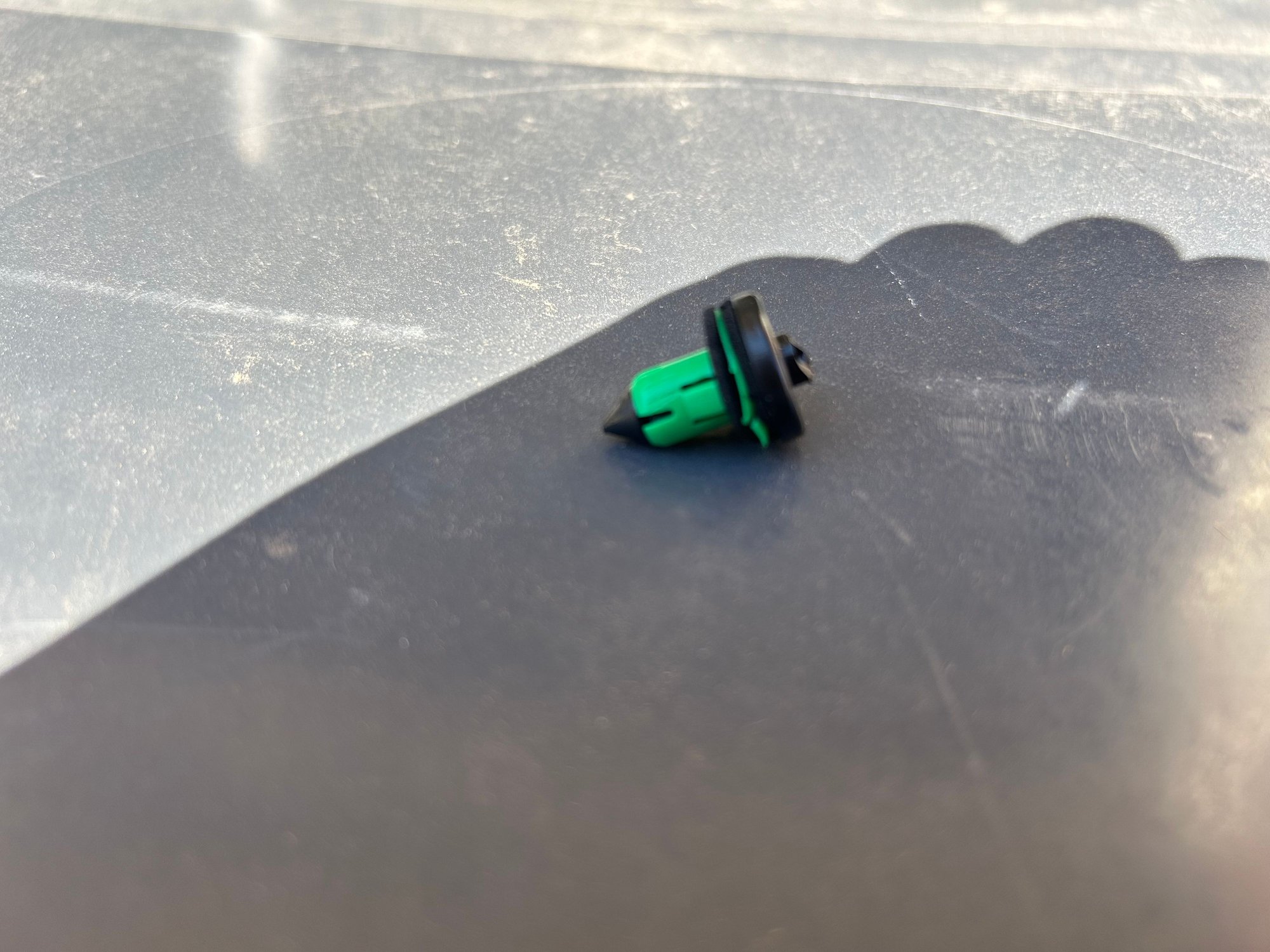

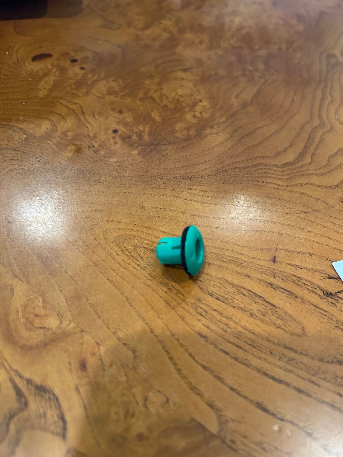

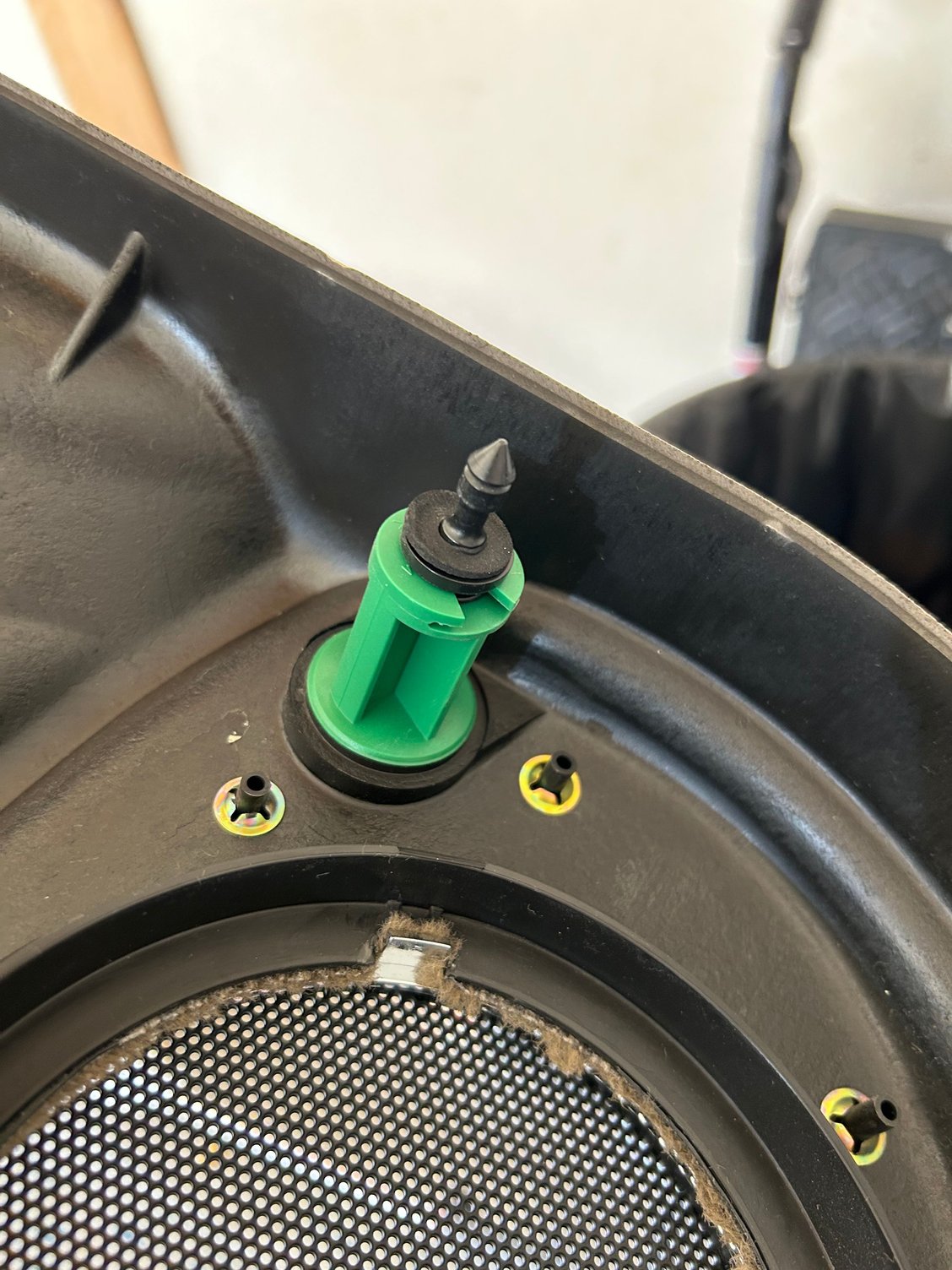

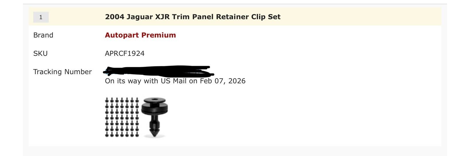

In removing the door panel, one of the black “male” clips broke. Thankfully, these are not a part of the panel itself, and I was able to find replacements on Parts Geek. I was not, however, able to find the green female clip that, again, thankfully, are removable and not part of the door. I think it prudent to have extras on hand. Does anyone know the part number? Thanks.
Male clip

Female clip
Female clip
Male clip in situ
Male clip in situ
Female clip in situ
Female clip in situ

I am not 100% sure, but I would say that it is item no. 9 in the picture of this link:
https://parts.jaguarlandroverclassic.../brand/jaguar/
Part no.: C2C19545
