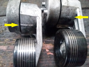

My belt for SC was squeaking too. I have exchaned idler pulley and drive belt tensioner and belt. But squeaking remained. So I take out pulleys and there is (for me) inexplicable fact (see pic, yellow arrow).
The belt wipes on the pulley body and causes squeaking. I don´t know where is error, but I used all things new, belt from Jag and other OEM. But result is the same. It seems, that the belt is long, but it is "C2C37055". Any idea ?

Pulleys are straight, problem is only in length of belt. I try another (1310 mm) lenght and maybe it help. Thanks.
