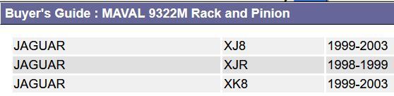

If you have a 2003 model car Rock Auto does have a rebuilt unit. It's a MAVAL 9322M rack.
Fits these cars.
Expensive but within the range of rebuilt R & P's.

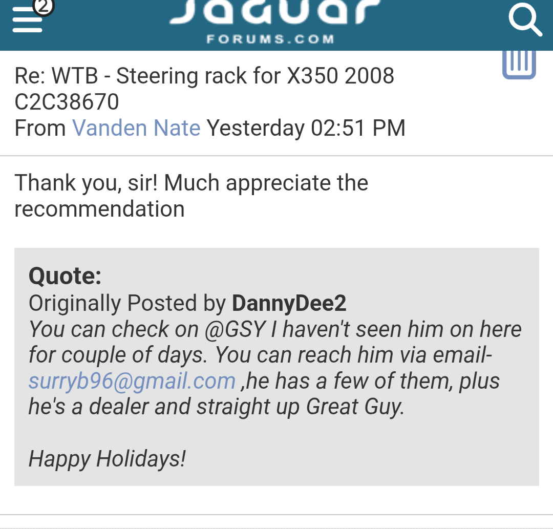

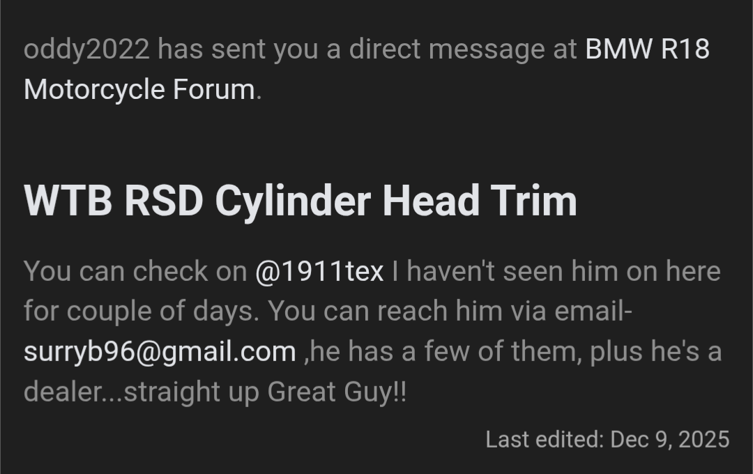

Separately, I did post on the Jaguar Forums marketplace and received some PM's to email some individuals claiming to be selling the exact parts, then requesting a Zelle payment. I found this to be a scam and reported the accounts that PM'ed me. For example, below is the PM I received as well as a similar account from BMW R18 forum some years ago, using the same language and directing to the same email address: surryb96@gmail.com and for Zelle Terry LoremanTerryL13@icloud.com
The email exchange back & forth outside of Jaguar Forums gave red flags - instant replies (ai email scam reply?) and some non-standard English + a JavaScript
Email JavaScript text that felt like a scam:
"*****PAYMENT NOTE/DESCRIPTION - JSRKindly send a picture or receipt of your payment confirmation"
https://www.r18forums.com/threads/re...-or-scam.4433/

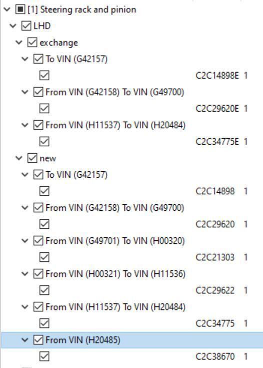

Before we get too deep into this we need the last 6 digits of your VIN. From JPART there is a few different part numbers depending on your VIN.
I may have the wrong model.
I have not checked any part numbers with Jaguar yet but what I usually see is after the cars get older the part numbers all collapse into one part number for a range of cars.
But let's get the VIN first and see what you have.
