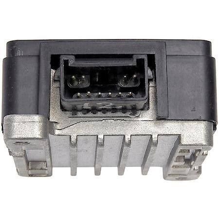

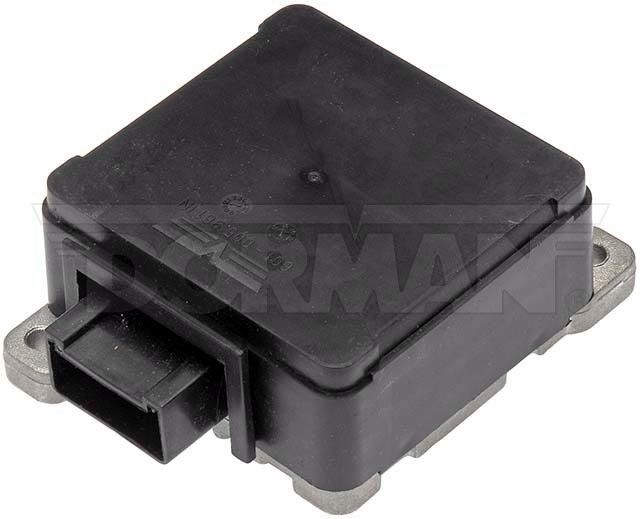

I am not sure but I "think" this Dorman part might work for your car? You have the 4.2L SC V-8 and while the Dorman application chart does not show the XJ with the 4.2L SC engine it does cover the S-Tpe R which also had the 4.2L SC engine. Plus this also fits the 3.0L V-6 as well as a number of Fords.
Does your module look like this? I don't know where this module is located in your car either but it's probably in the trunk somewhere.
If so I would take a chance and see if it would work.
Here is the plug to match up.
They are expensive at around $150 but they are obsolete from JLR and Ford. I did find a brand new one for $50 on EBay.
Dorman Fuel Pump Module
Up to you but a used one could be a solution as these are not terribly failure prone. But if it were my car and I could get a new module for $50 I would take it now!

Thank you. It looks very much like mine.

Can you do us a favor? With the cars getting older everyday and parts going obsolete please report back if that part works or not. A picture of your old module with the part numbers on it would be a great help. I know you need a few more posts before you can upload pictures. I think 10 posts are required.
That could be a critical part in keeping the cars on the road. Plus with Dorman involved the parts will be much cheaper and widely distributed. Now I have had some problems with Dorman and don't consider their stuff equal to OEM parts but if that's all that is available. Well we are stuck using it.
