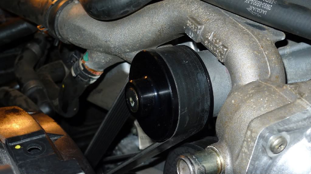

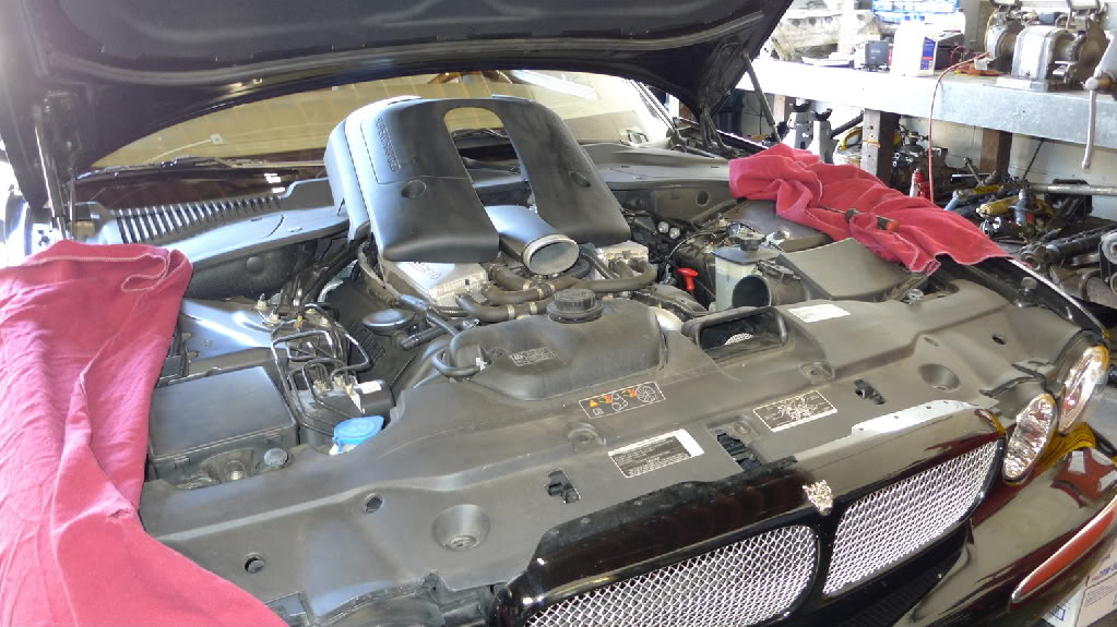

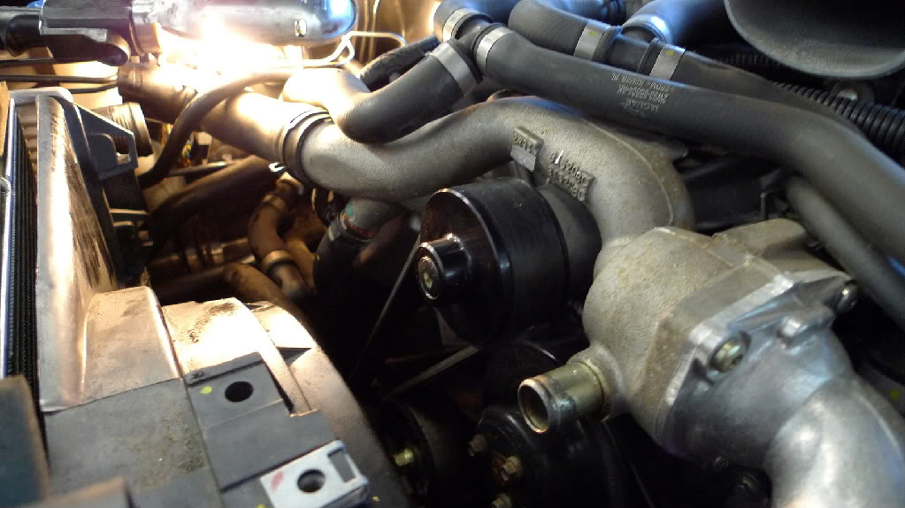

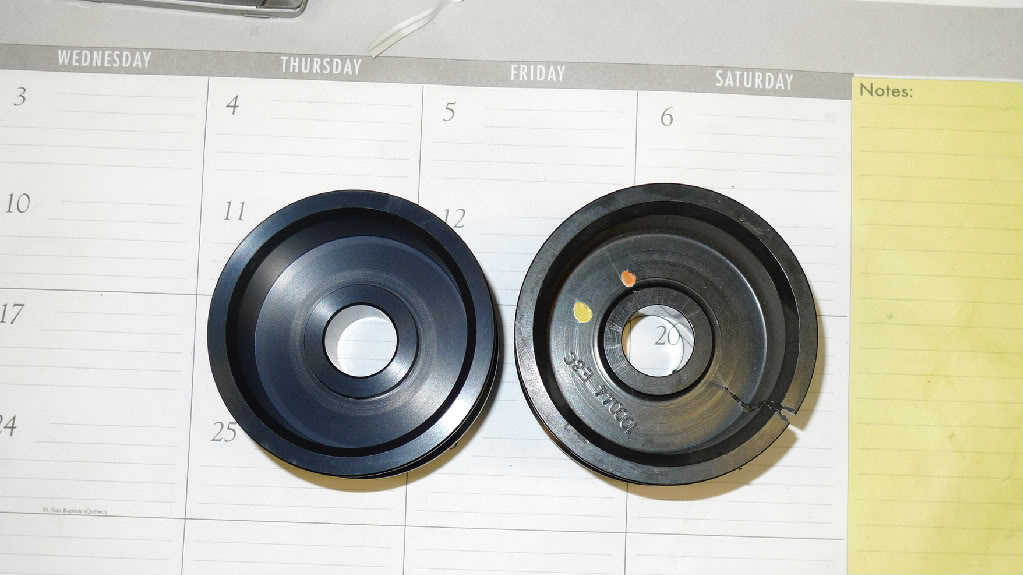

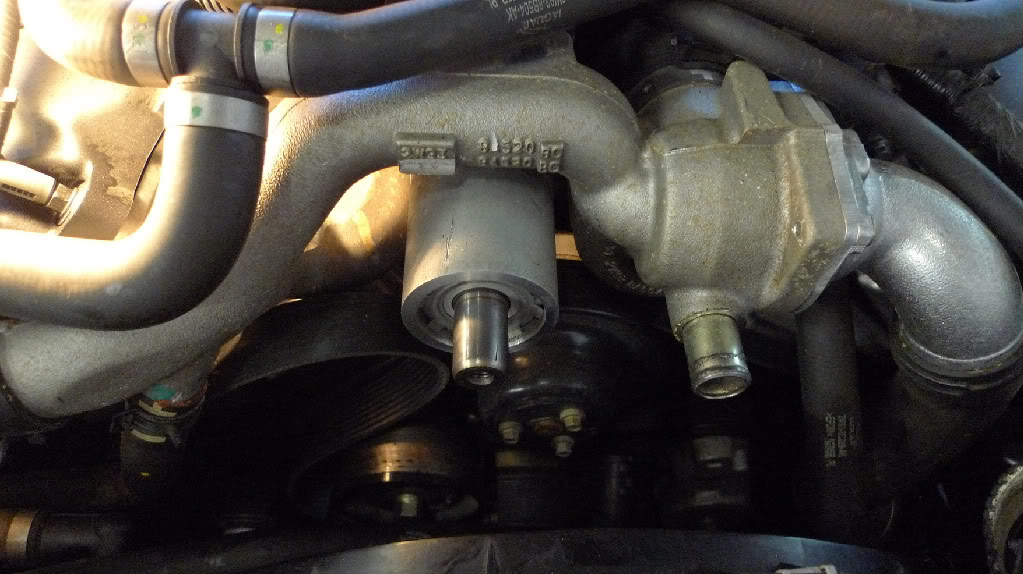

Smile Pictures of the Install!
Here are pictures from the install. The total was a hair under $400. The pulley I installed was the 1.5LB pulley offered by Mina Gallery which is an identical copy of the pulley offered by Eurotoys LTD. Chris at Mina Gallery offered the pulley to me for $235 instead of the $320 listed MSRP. The installation cost $150.
The intake tract was pulled off.
Coolant tank has been removed along with the intake snorkel.
Old pulley is off. (note the scarring on the supercharger...more details below)
New pulley is on!
Closer.
New pulley vs. old pulley.
Rear shot.
the 1.5LB pulley is on the left.
As you can see...this pulley is slightly smaller. It is much lighter though.
The shop did use a highly unorthodox method to get the old pulley off. I was under the impression it would be pulled off but they took a cutter to the old pulley and basically cut it off. There were some slight incisions left on the nose of the supercharger that I was initially uncomfortable with but I have had no problems thus far. Other than that, the installation went smoothly. One word of warning though, installing this pulley means you have to remove the coolant tank. When this is reinstalled at the end, MAKE SURE YOU HAVE THE SHOP BLEED THE COOLING SYSTEM. My shop forgot to do this and my car started overheating as soon as I drove three lights away from the shop. Coolant spewed all over my engine bay... (x_x)
Even with all the hiccups, the people were very friendly and helpful. If you live in So-Cal, I would recommend going to this shop. They are more familiar with XK's. I am the first XJR they have performed a pulley install with. Hopefully they have learned from this and the installation for future So-Cal XJR owners will be faster and smoother.
I may be visiting a Dyno tomorrow to see what number I put down. If I do make it in time before the shop closes, I will try and go sometime next week as the owner will be gone this weekend. If I do end up going, I will post the dyno run papers as well as a video. The stock car should put out somewhere between 330RWHP and 340RWHP. These numbers were obtained from looking at S-Type R and XKR stock 4.2L dyno runs. I am not expecting too much more than this number. I have to keep in mind that I am going into this with almost 7,500 miles on the oil...and I drive my car harder than any normal XJR owner. I frequent all of the neighboring canyon roads (Mulholland, Piuma Road, Stunt Road, Tuna Canyon, Latigo Canyon, Yerba Buena, GMR etc...) and this engine is pushed constantly. If I net anything over 350RWHP, I will be happy.
