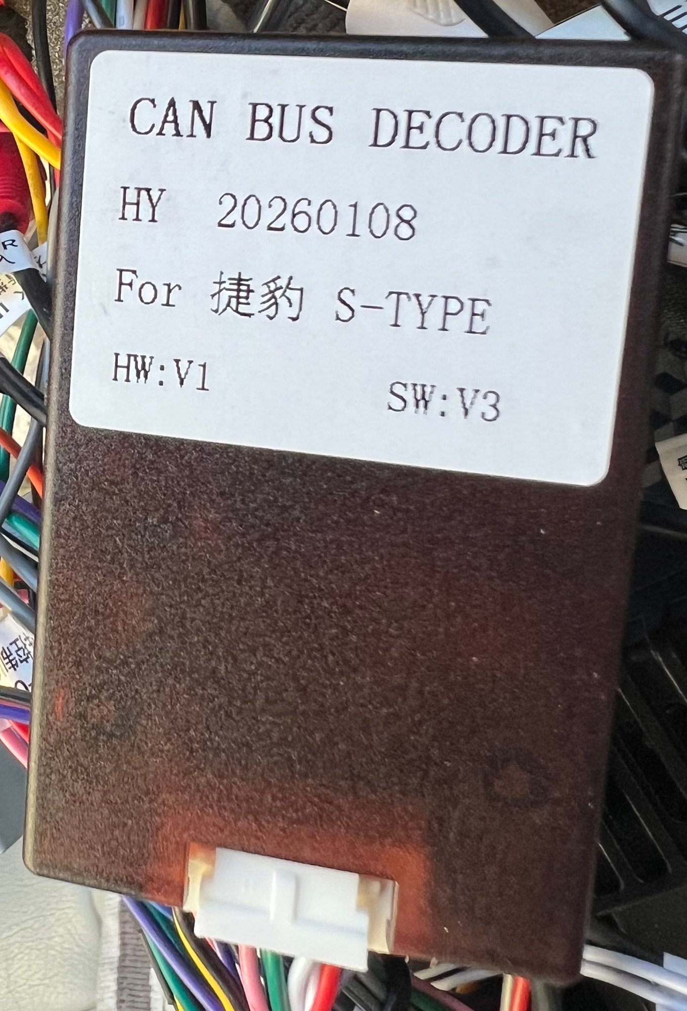

I did notice the can bus unit decoder supplied says “S-Type” (which my car is not). I have contacted the vendor to see if this is correct or whether this is the reason my aircon is freaking out.
Thanks for the assistance guys.

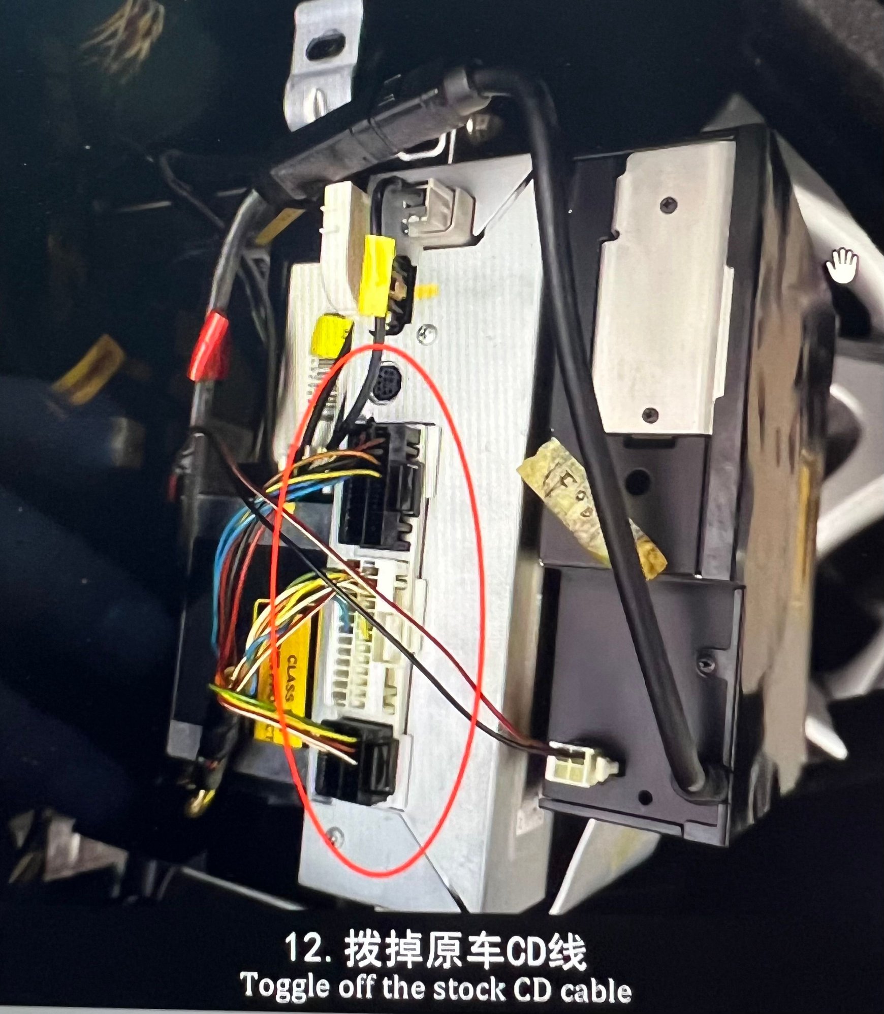

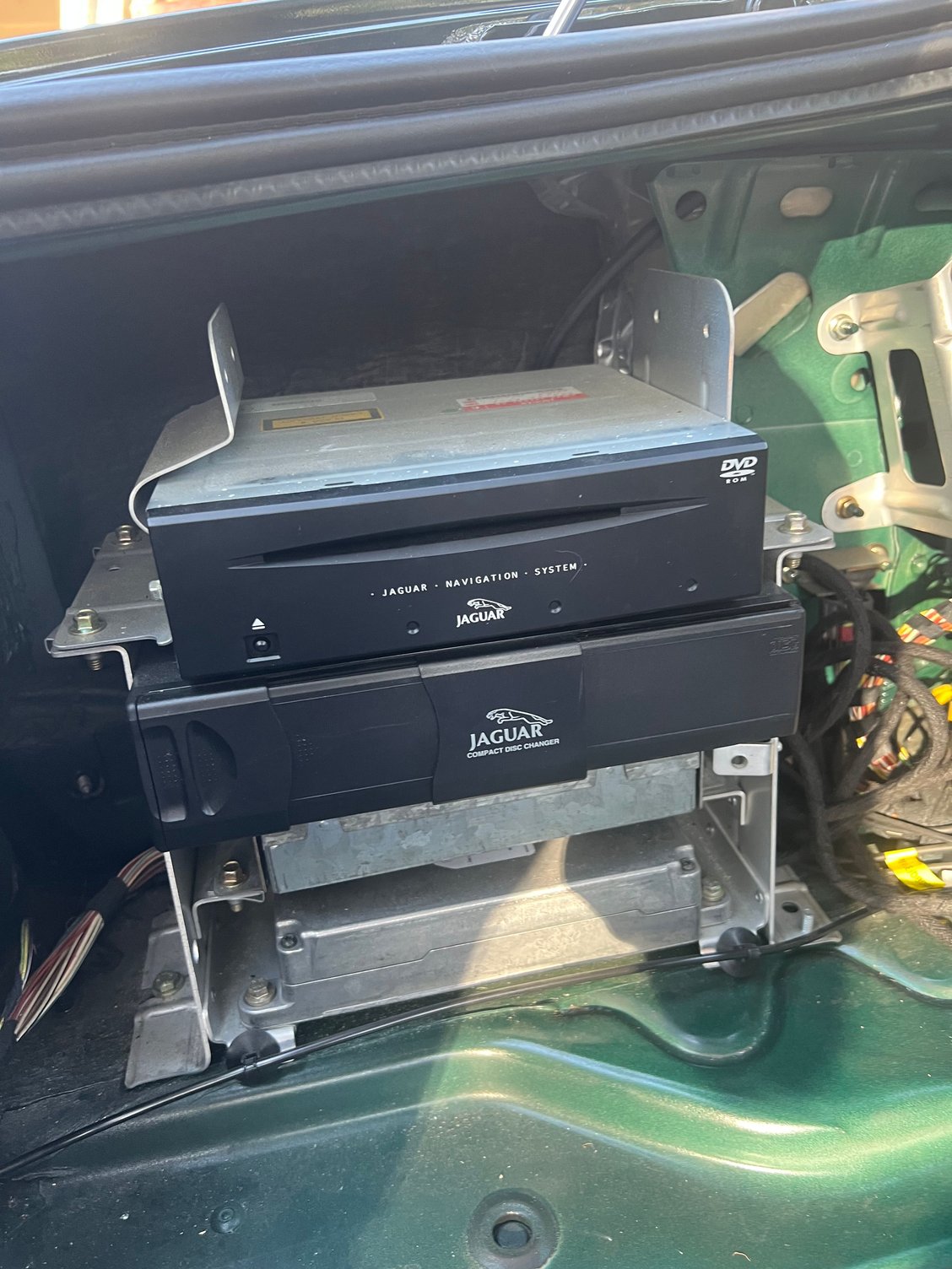

The issue has been solved ! The mystery modules in the trunk / boot are the ones that are no longer required such as CD changer, sat nav, phone.
Once these were disconnected the aircon settled down and the controls now work perfectly.
The original vendor was very helpful and had me try a few things (selecting XJL on the car selection) before the tech said unplug these units in the boot.
I have attached pictures.
Picture 1 from the vendor

CD changer, satnav and old phone modules

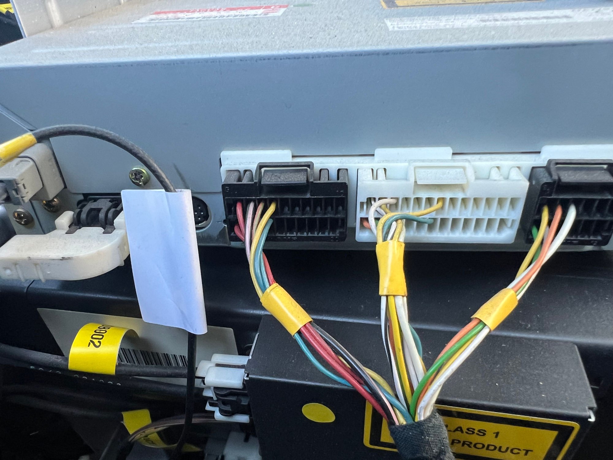

Back of the satnav unit, same as the one they suggested unplugging

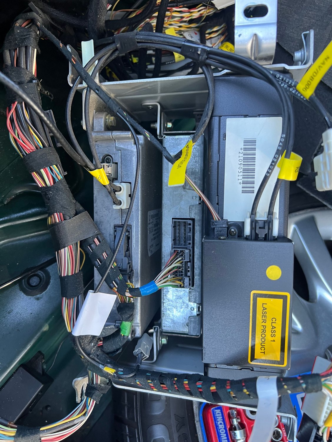

Back of the cd changer and 2 phone modules
