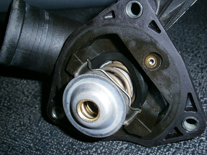

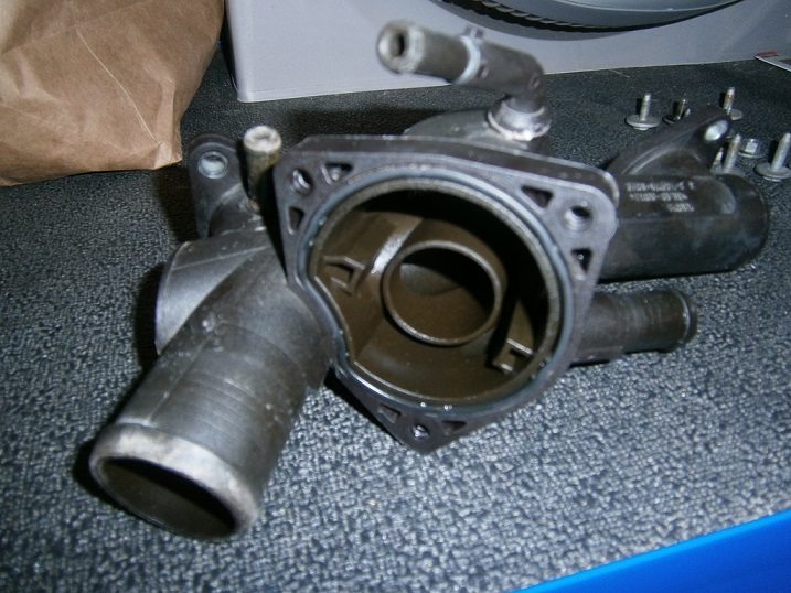

Anyways, when I took off the thermostat housing I noticed that the rubber ring around the thermostat pressure end was actually peeling up out of its setting. I had no hot water issues but just goes to show that with age the thermostat can be an issue even before it causes big issues.
Attached are pictures of the thermostat where you can see the rubber ring lifting up, another picture showing the thermostat taken apart and the rubber ring tearing lose. The last picture shows the water distribution unit and the front is where the thermostat housing screws on with three screws.
