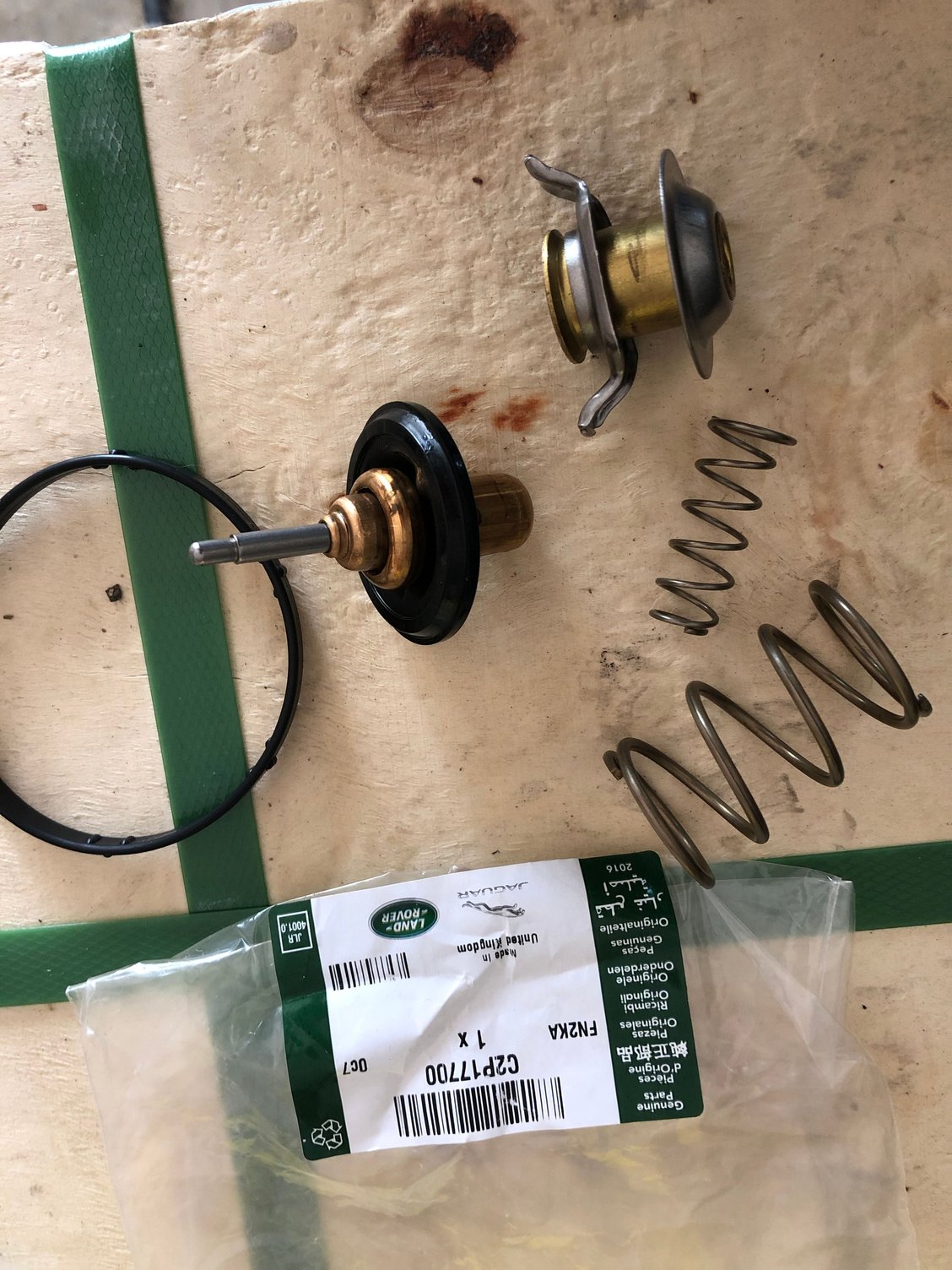

Hi everyone,
So I ordered a new thermostat, part #18 here
https://www.jaguarmerriamparts.com/p...iagram=4725045
But didn't expect that it would come in pieces - clearly its been awhile since I replaced a thermostat on anything, but I don't remember them being a $45 part and I don't remember having to put one together... far as I know they're just little UFO-shaped things....
So does anyone think I may have gotten the wrong part? I am sure I can figure it out once I take the car apart, but I would rather know what I am dealing with - is this normal? is there a clearer diagram of how these go together?
here are the parts as I received them:
guess i thought most thermostats looked like this:
generic thermostat?
Thanks for your thoughts in advance.

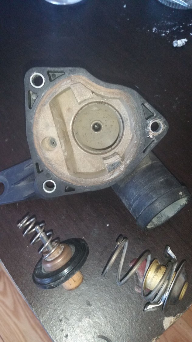

Oh my.. IMO, part #15 would have been the best choice. I can't provide assistance on the assembly of the part but I do know that you have to cram it all into #17 and twist it. At least that's what I gleaned from inspecting the inside of mine, which had blown apart almost entirely. Hopefully someone here has refurbished theirs before and can be more helpful than I.
EDIT: Here's my best guess. I happen to still have my bits and pieces

Thanks NH - yeah, probably should have just gone with 15, but lots of plates in the air money-wise, so hoping this will work - if not, i can suck it up and just buy the assembly... Looks like it should be fairly obvious once I get 17 off.
Thanks!!

My last thermostat was the same and it seems to be the latest version Jag uses; https://www.jaguarforums.com/forum/x...k-like-169805/
Make sure you get the inner spring the correct way around; https://www.jaguarforums.com/forum/s...r-68km-154317/

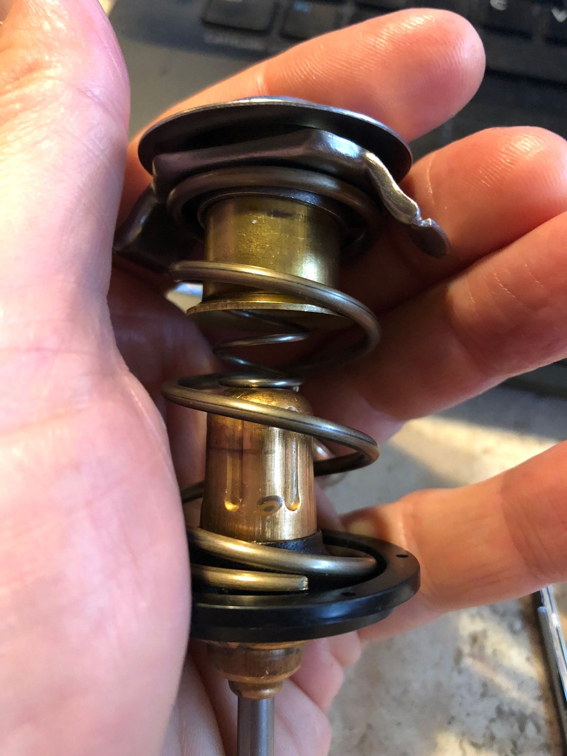

here is my best guess after reading the post that woox4 referred to:
That spring takes a hell of a lot of force to compress, hope that assembly is strong enough to hold it together - i suppose it must be; otherwise I'll just get the whole thing and send this back. Or take the old one-piece out and try to match it down at AutoZone.
