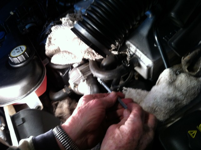

2. Remove Hose clamps on plastic supercharger duct and airbox top
3. Thermostat Housing

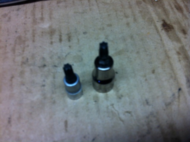

10. T30 sockets - 1/4 and 3/8 drive - one from SEARS one from AUTOZONE

11. T30 sockets - Comparison
