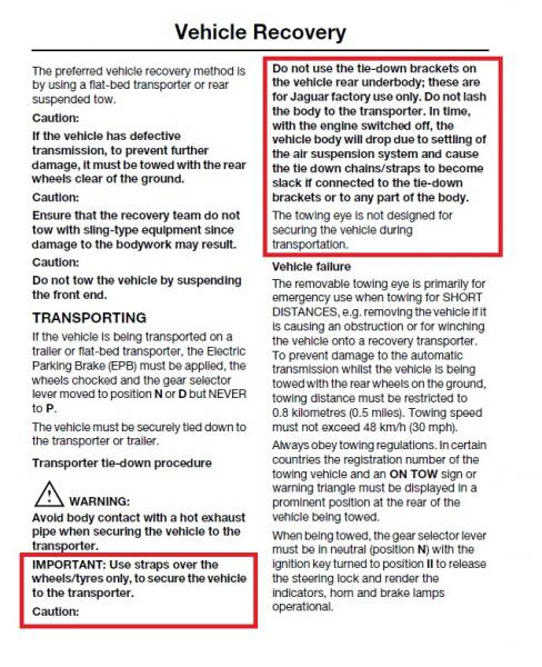

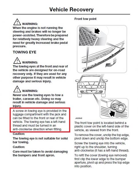

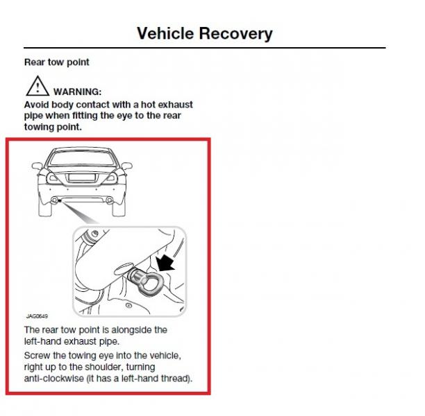

Old Jan 22, 2013 | 10:06 AM
Likes: 17,009
Not difficult to winch on.
Your main concern should be where and how they attach the winch to avoid any possibility of bumper damage.
The correct method is to attach the Jaguar Towing Eye from the Tool Kit:
Note the sections I've boxed in red regarding attaching the Towing Eye and tying down the vehicle for transportation.
Any idiot can drag a car onto a flat bed. Some of them can even demolish a wall when they deliver the the car to your home as I found a few years back with an X308.
