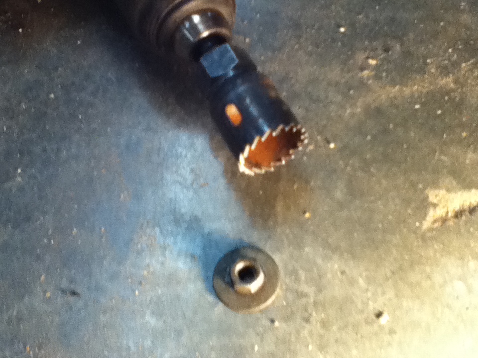

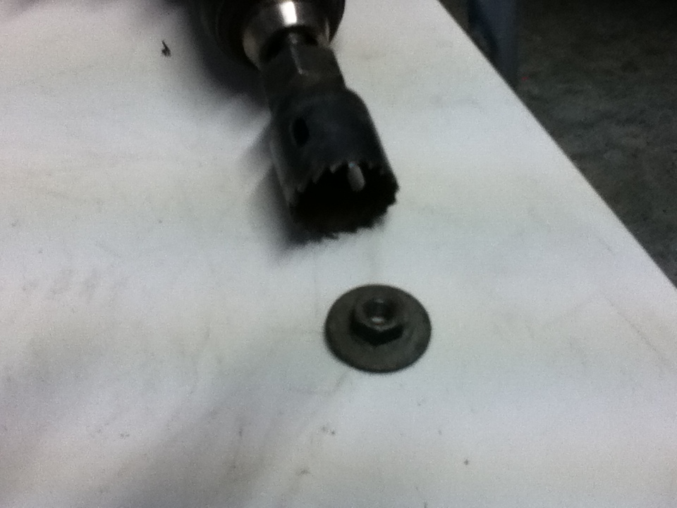

As related in a different post, I needed to replace the fuel filter on my '05 XJ8L, but a 1 hour job turned into an overnight PIA when two of 4 studs holding the under-body plastic cover were corroded solid with the nuts/fender washers, all up inside conical plastic stand-offs where they were almost unreachable. The studs were in threaded inserts and the inserts were spinning while the nuts stood tight.
I solved this dilemma by selecting a 7/8 hole saw whose I/D was close to the O/D of the fender washer on the studs, took out the pilot bit, and ran it at medium speed until it drilled through the plastic at the top of the stand-off, and the plastic pan dropped away.

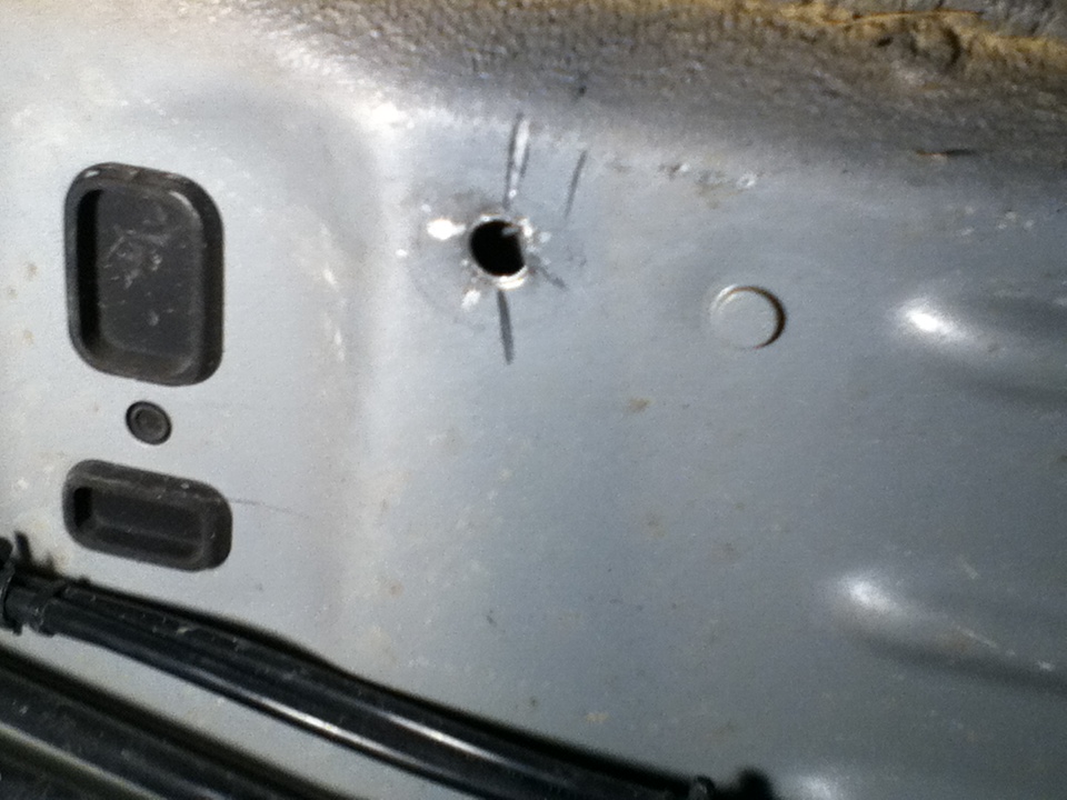

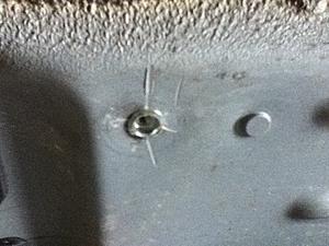

That exposed the rusted studs which I burned away with a cutting wheel in my angle grinder, leaving just the insert to deal with. I cautiously cut a cross in the face of the insert, leaving 4 quadrants I could chisel off, leaving the top of the insert and a bit of the original stud to drive upward out of the hole, into the insulation above the sheet metal.
I have a Shurebonder Quick-Thread kit from the home center, whose largest size, 1/4-20, calls for a 25/64 hole, the exact size remaining in the sheet metal of the under-body. A quick thread insert install, a spritz of grey primer, and the plastic tray was ready to go back up. I needed to use an over-size fender washer and a 1/4-20 machine screw to fit the now oversize holes in those 2 stand-offs, and a bit of anti-seize compound on all the bolt threads under the car, and down off the lift.
