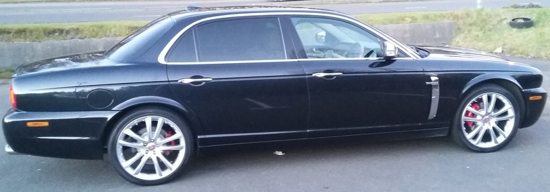

Ok so here's my car as is with the 20" Callisto's on her......

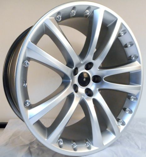

looks pretty good, but, I'm thinking of a change to these
Now they come as a staggered set, which I DON'T want, so it's either fronts or rears, depending on which may be the best fit / look, so looking for any advice
My existing Callisto's are 9J with std 255 35 20 tyres on them
My choices ( assuming they'll both fit are as follows )
I believe that I'd like my wheels to protrude a little more ( I think I can get away with perhaps another 20mm there or thereabouts, need to check )
Fronts in 8.5J fitting with the same ET49 offset same tyre would be as follows, The rim / tyre will move away rom the strut by 6.4mm and also inwards by 6.4mm
I'm thinking of 20mm hubcentric wheel spacers to get it back out by about 15mm for a more aggressive stance.......

re the spacers, see here
20mm Hubcentric wheel spacer kit
These are precision fit 20mm Hubcentric wheel spacers, In this kit you get 2 spacers with studs and shallow head nuts
The spacers are a nice one piece billet aluminum with a 5x 108 PCD with a centre bore of 63.4mm and the studs are M12x1.5, Please note that the stud on the car can not be any longer than 20mm coming out from the disc, Spacers are made from CNC machined 6082 Aluminium
This is where I think I may have an issue
Jim

Jim, the rears from that set will not work at all on an X350...
9.5Jx20 with ET26, bad news... I ran 9.5Jx18 ET36 off an X150 XK on my XJR and they rubbed the rear wheel arches, so with another 10mm from that poking out you'd have even more trouble...
The required offset does change with the rim width.
So for example with Sid's car, you have to keep in mind he's running 8.5" rims, whereas your Callisto's are 9"
Adding 10mm is no problem and looks great. 15mm is maybe pushing it depending on ET and width, if you want to avoid rubbing.
For example the stock 9Jx20 ET49, if you changed that to ET39 it looks nice and you won't have rubbing issues, front or rear. Going past that is where you have to start playing around with clearance.
If you change to an 8.5Jx20 and you want the face of the wheel in the same place, then it needs to be about ET42 - ET43, then for your extra 10mm poke out ET33. But the face of the wheel would be in the same position as the 9J with ET39.
If you have an 8.5Jx20 ET49 and run a 20mm spacer, that makes it ET29, which is going to give you rubbing issues. 8.5Jx20 ET49 with a 15mm spacer would be better for clearance.

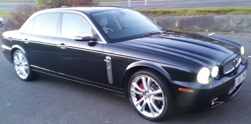

I guess I may be going for this look, see attached pics.....minus the lowering though, that's not my scene at all.
Funnily enough, I have also considered blacking out the chrome window surround too.....that's a maybe??

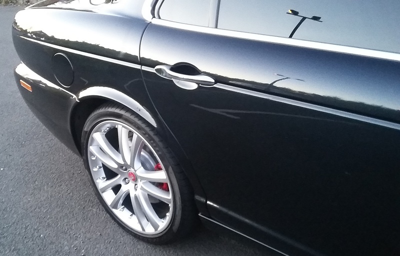

Hope you get sorted out Jim - That's a pic of what I have now, but that should mean even with the spacers yours will fit, only looking at the outside as you're not going wider. If I understand correctly when I had the 9J ET49 Cremonas fitted with 20mm spacers that was an effective offset of 29, which fitted without problem, but I'd say that would be as far as you could go and I'd say 9.5J would cause some interference issues...
The only other thing is when fitting the spacers try and find a good 6 sided 19mm socket with thin wall as the shallow nuts to mount the spacers are pretty easy to round off..

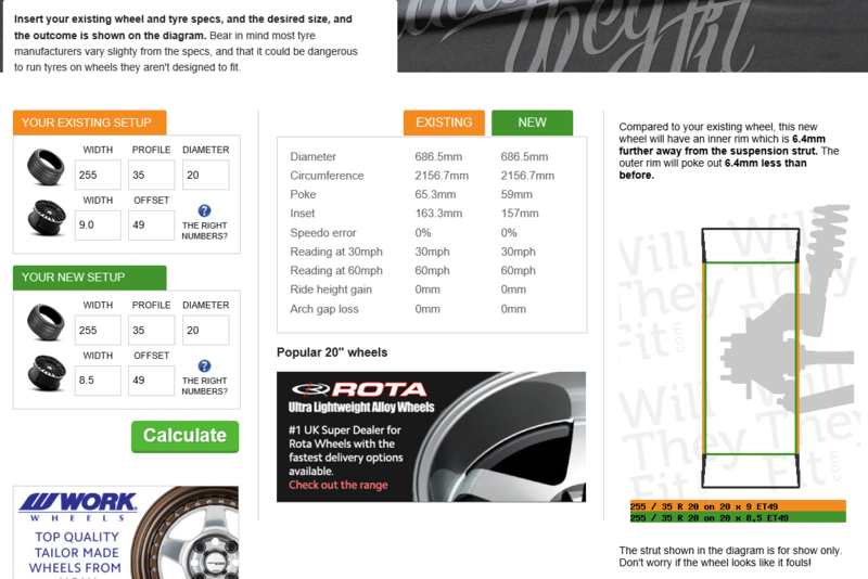

Old Mar 9, 2016 | 05:26 PM
Simon - Thanks for your help, really appreciate it
The wheels are 8.5 J so losing around 12mm there overall, The outer rim will poke out 6.4mm LESS than before, adding the 20mm spacers should take it out from original by about 13.6mm or so, which I think will be fine
Wheels are here and waiting for wheel spacers to arrive to try fitment and check
