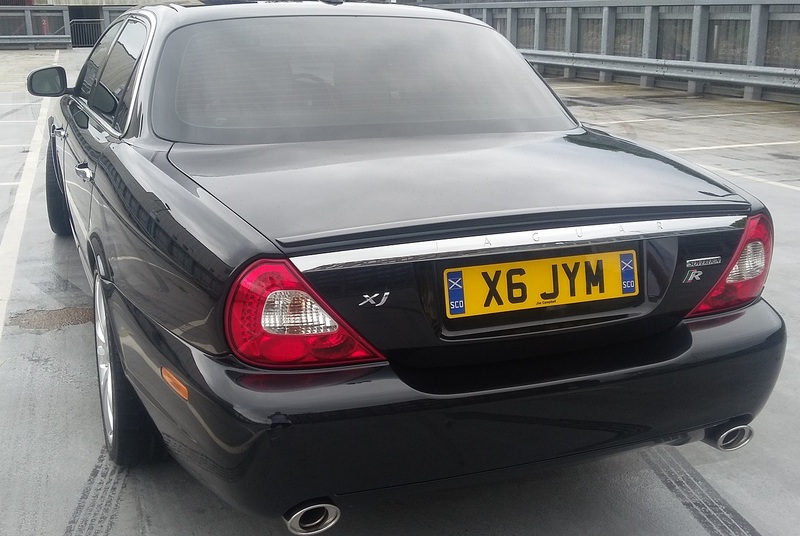

Quote:
Velly sexy..... I might have to treat myself to a pair for fathers day lolOriginally Posted by JimC64
Car now looks like a different animal altogether with these on, from the rear anyway........REALLY LOVING the look.JimC64
close

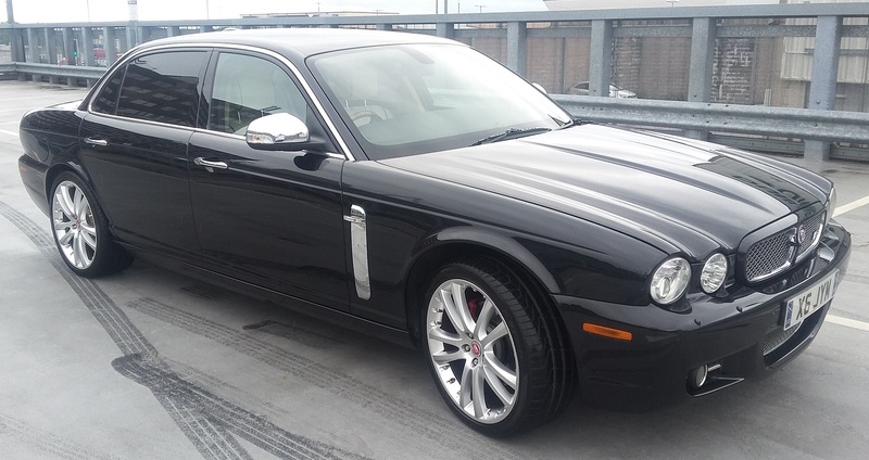

As some of you know I had the car detailed around a month ago, they did a really good job too, very well pleased.
In the meantime it's suffered a scratch or two and there were also some RDS that were unable to be removed. In an effort to firstly repair these little scratches and or to preserve the finish achieved by detailing so far, and moving forward..........
I spent several hours today, firstly washing and drying her, with the intention of applying Poorboys Blackhole ( a filler glaze ) and then topping it off with Chemical guys BLACK wax ( designed specifically for Black coloured cars using nano technology )
The Poorboys Blackhole I know well, an amazing product and one any black car owning enthusiast should try. I was interested to see the CG Black wax and how it performed too.
The PB Blackhole smells gorgeous and is easy on / easy off. Having said that I forget sometimes just what a LARGE car she is, took around 2 hours. The Chemical Guys BLACK wax is
also easy on / easy off and also took around 2 hours, suffice to say my arms are hanging off, lol
As the weather was definitely not playing ball, I went to the local car park under cover, it's usually deserted and most enthusiasts use it for this and small DIY jobs of one sort or another....
Anyway, here's the results for those that are interested....
Reflection shot in door panel of the car park shows decent results I think....
I'm hoping it'll help to protect the finish for a few months before re applying, topping it up for maximum protection through the winter.

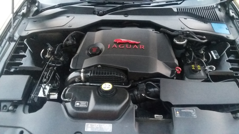

Well, first time I've had the "Red warning light" & service required message in the info display.
After checking my oil as a matter of urgency I found that the levels were at the max line, this after only around 6 weeks and approx. 4k miles of driving!
This is a little earlier than usual?
I put it down to perhaps it being a little over the halfway line when done last time and some fairly serious mile in such a short timescale, I hope!!
Anyhow, oil & filter changed again today for very reasonable money at National Tyres so hopefully all good for another wee while.

Gave the engine bay a wipe over tonight and added the leaper to match the JAGUAR lettering. A little spruce up and the addition of the leaper makes a nice subtle difference I think, well pleased.
Jim
