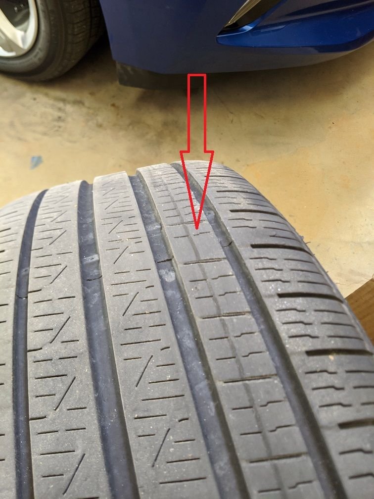

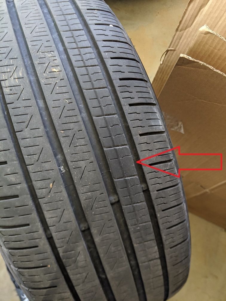

Update: I was finally able to get my offending front wheel to a specialty rim shop. He took a look at it and in 30 seconds showed me the tire was out of round and the rim was fine. The computer readout quantified the tire radial runout at 0.035 inch, with the inside of the rim having a runout of only 0.005 inch. Rim is as close to perfect as Jag could have made it. However, just watching the tire rotate around slowly you can see it bounce up and down. Two distinct marks on the tread where it has been wearing incorrectly.
Dug up my tire receipts, this set of Cinturato P7s was put on the car in May 2016 with 99k miles. Next invoice was from January 2017 where I took it back complaining of a highway vibration at 104k miles. It seems like this tire was out of round since day 1. But apparently it was on the rear of the car initially so I didn't notice it until it got rotated to the front. Currently at 133k miles.
Took it back to the tire dealer, he is warrantying it 100%. However the tires have approx 35k miles and 50% life on them. Matching a 50% tire with a 100% tire is going to keep me up at night... so I'm going to have him get a 2nd new one. Will trash the out of round tire, and keep the other 50% tire as a spare in case one of the other 2 self destructs. Although I hate the idea of buying tires piecemeal, I think this will be the best solution.
I have to say, I need to remember to never buy Pirelli tires again. I have had nothing but issues with them. My last set on this car were PZero Nero, at least 2 were replaced under warranty for out of round defects within 15k miles, and by 30k miles they were trashed. The only reason I went with the Cinturatos was because they were prorated so much from the old set. And my tire guy assured me these P7s would work better.
It's sad that this tire shop has gone downhill in service. 3 times they road force balanced and told me the tire was perfect. If they had just looked at it they would have seen the issue. And twice now I've found chips in my rim paint where they've chucked the wheel into the balance machine. Too many strikes against them at this point... time for me to find a new tire shop.
