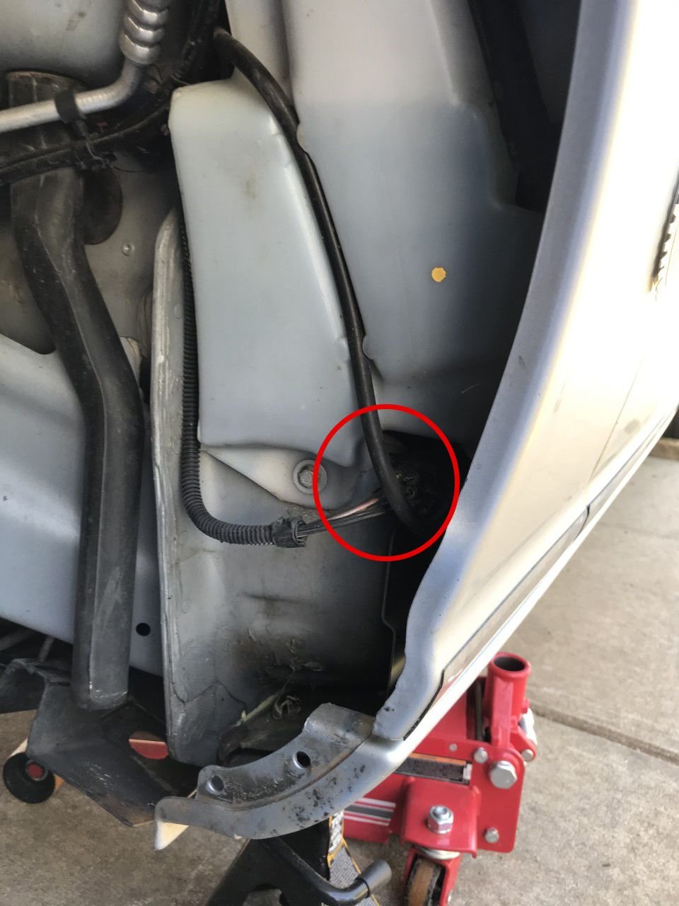

is the filler cap for the windshiled washer placed like in the picture (left lower corner)? I ask because Jaguer changed the location of the windshield washer reservoir during the production, but I seem to remeber that it was after 2005...
If yes, then you need to remove the right front wheel and the wheel arch liner to access the washer pump(s). If you have headlight washers, there will be two pumps. The smaller one is the one for the windshield washer.
If the filler cap is on the driver's side in front of the windshield, then I suppose that you need to remove the leftfront wheel and the wheelarch liner to access the pump(s),

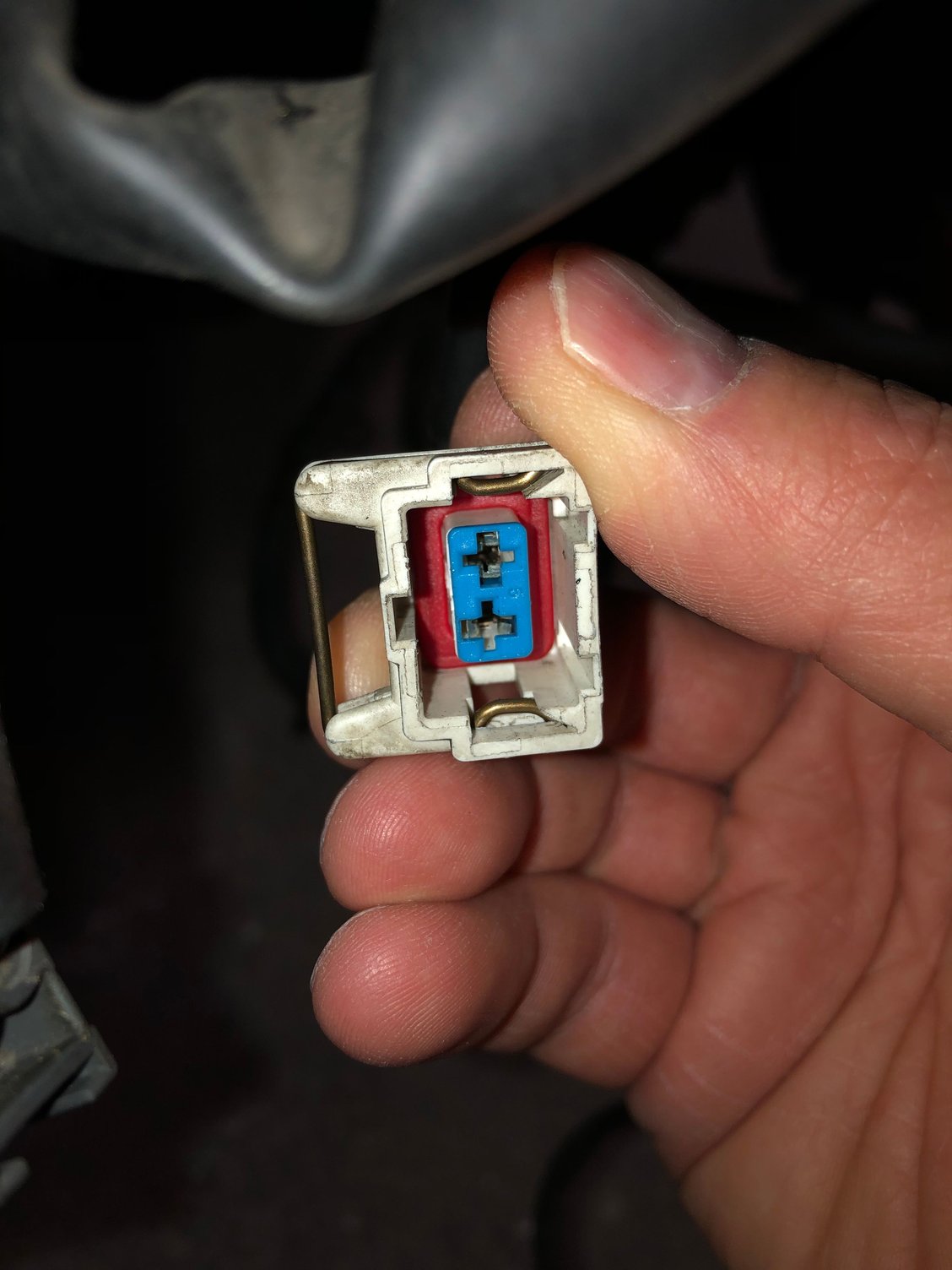

When you check the pump(s), also make sure that the pins of the electrical connectors make proper contact. I had the issue with the connector for the headlight washer pump. After checking fuses, the wiring loom (which is a major hassle) and what not I found out that the pins in the connector where not making proper contact.

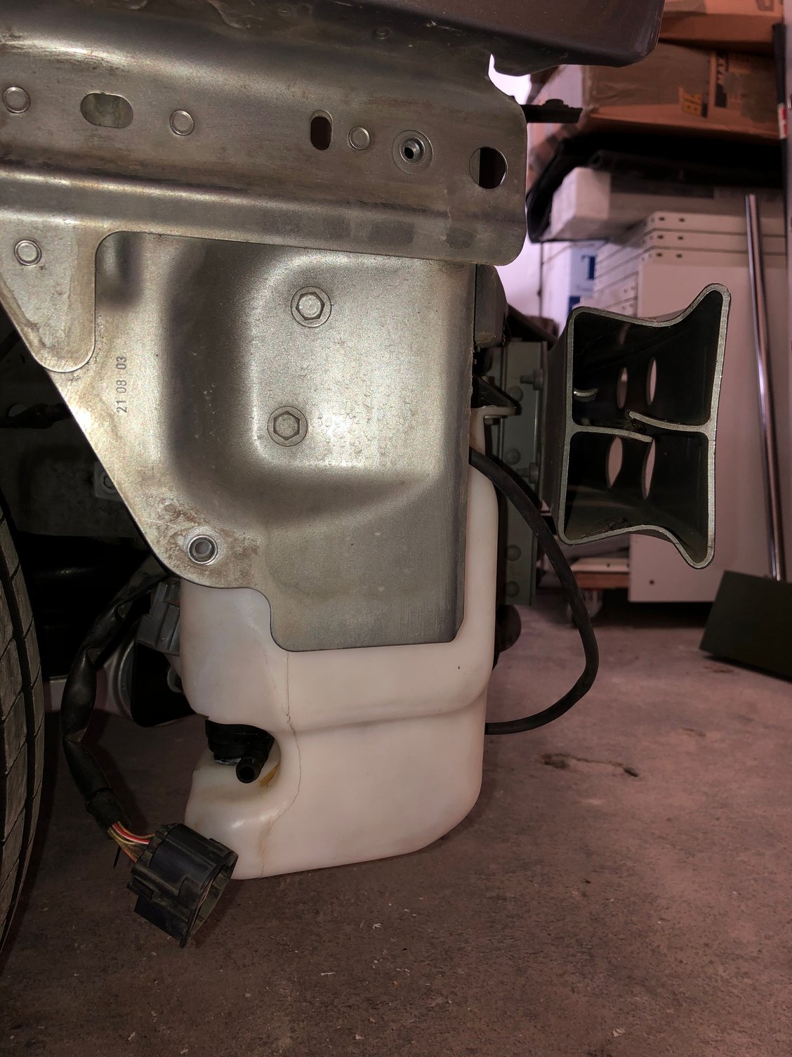

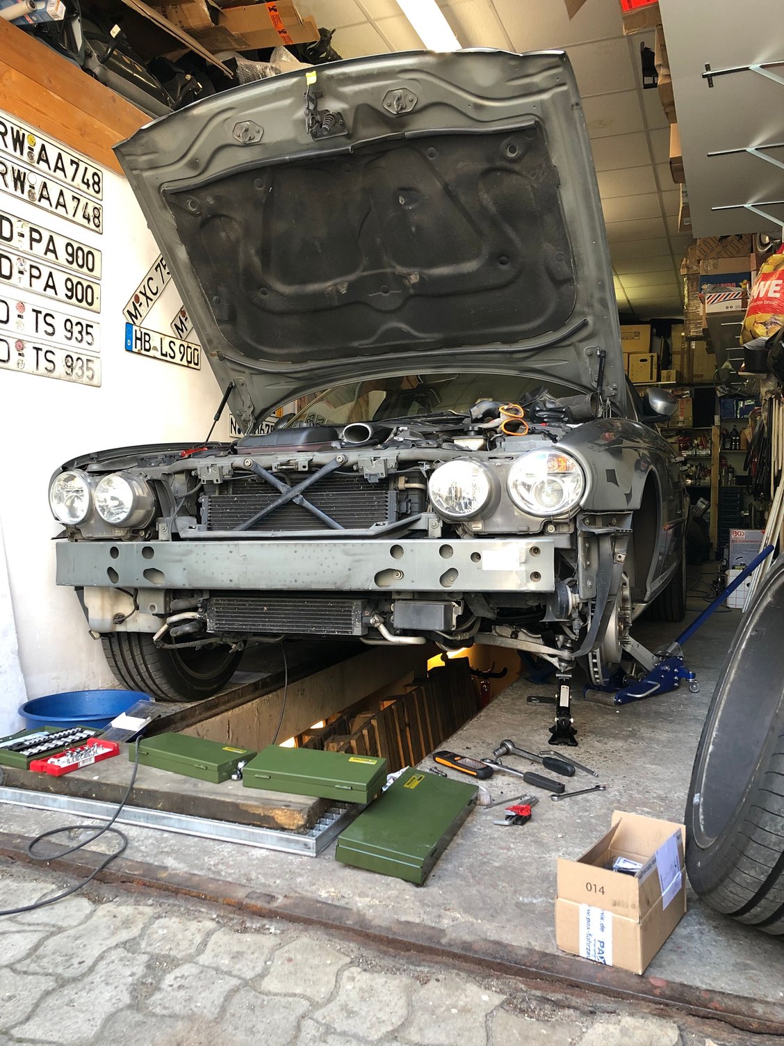

I have searched the pictures that I have taken during the works done on the car, and the only one of the windscreen washer reservoir is the following:
It was taken wit the bumper cover off and you can just see part of the headlights washer pump, but I remember that accessibility is quite good with the wheel and wheelarch liner removed. Both pumps are on the rear of the reservoir towards the wheel.
On the front of the reservoir you only have the electric connector for the fill sensor, as you can see on the following picture:
Sorry, but currently I do not have better ones. I hope that they help at least a little bit.

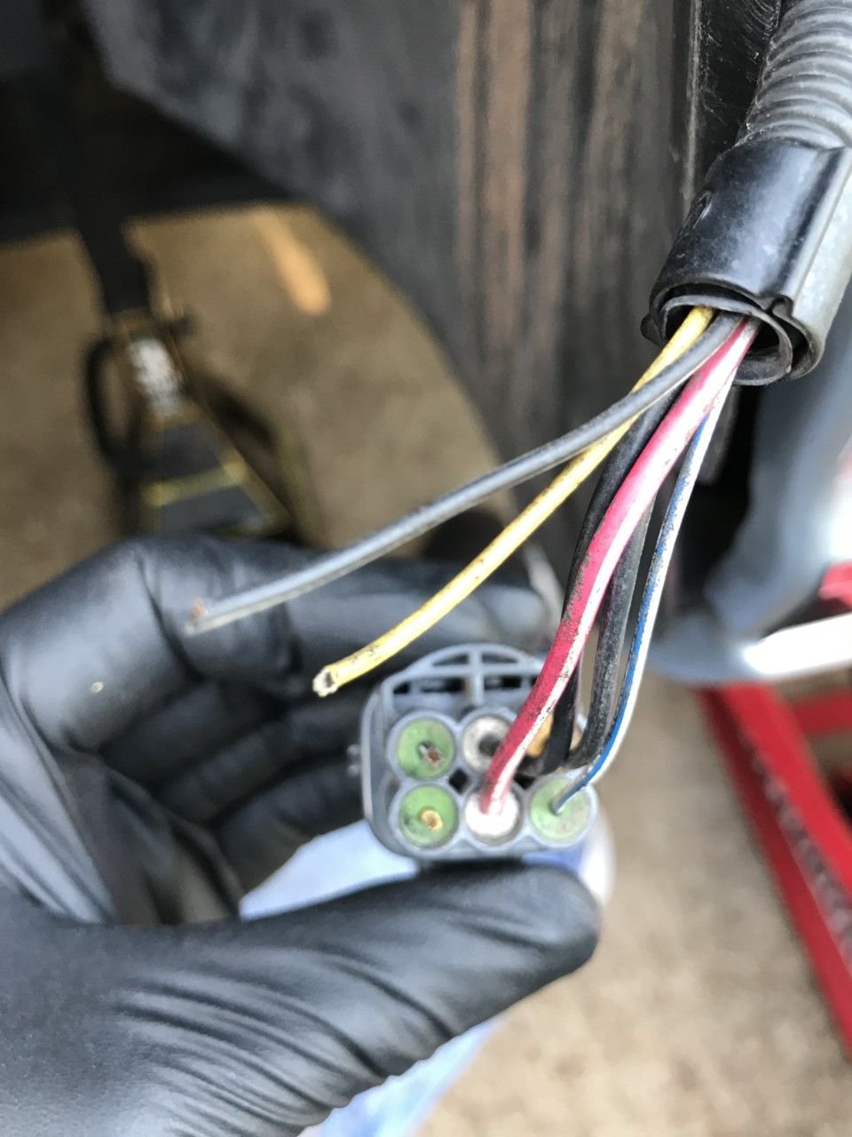

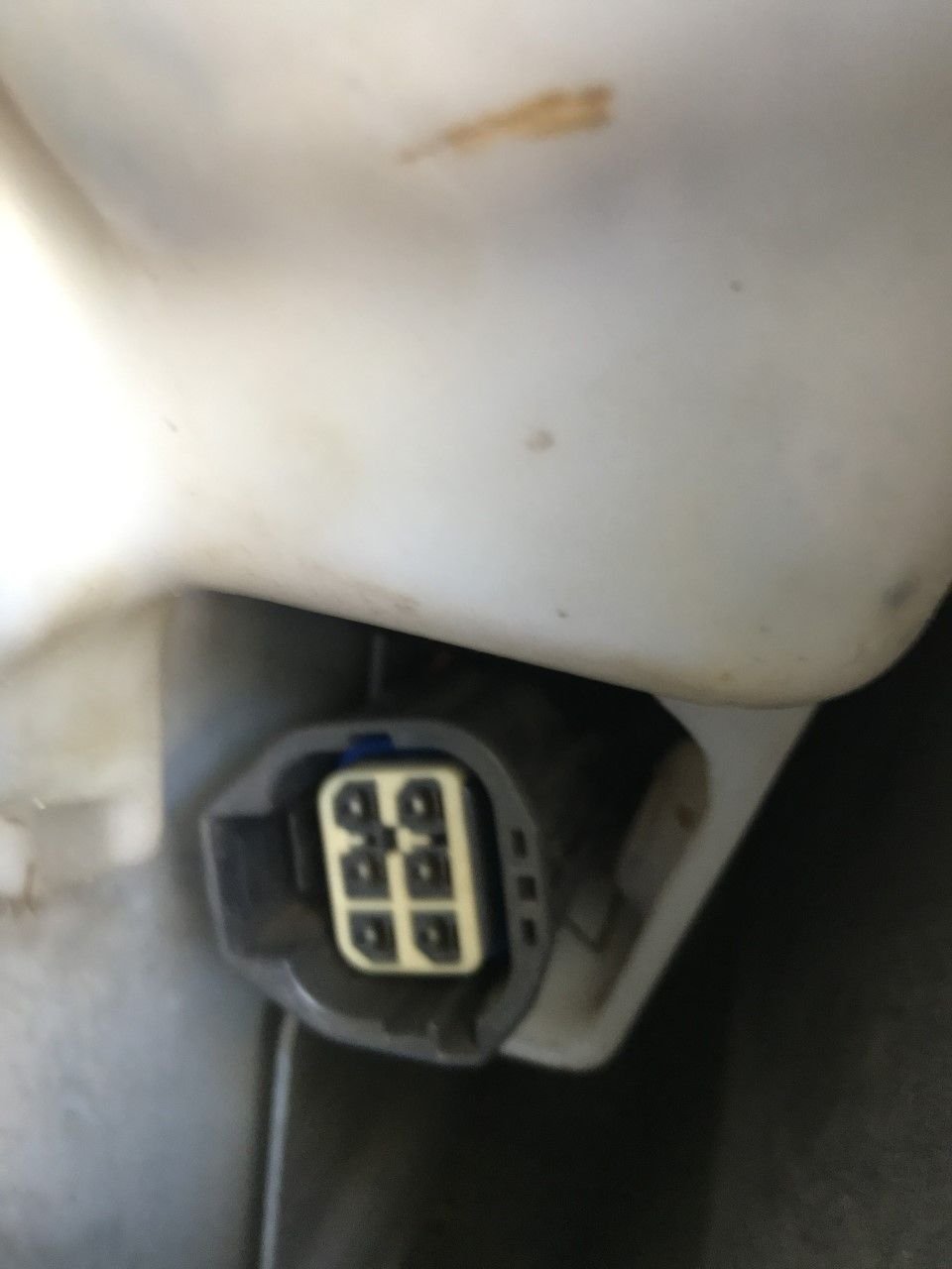

Mine is a 06 Vanden Plas so the tank is located inside the drivers fender behind the wheel well cover. Attached image shows the pump and connector circled in red.
Close up after the connector was removed.
My problem was just a couple of broke wires. Pump was fine and once I repaired, all worked fine.

In my case, both pumps were defective and needed replacement (I had tested them outside of the car), so I would not discount it. Plus, as stated above I my car had suffered the defective connector shown above.
As you have the reservoir on the right hand side of the car, you should have the same connectors as my car has. The white one pictured above is the one for the headlamp washer pump. If I remember correctly, the windscreen washer pump has a different connector.
