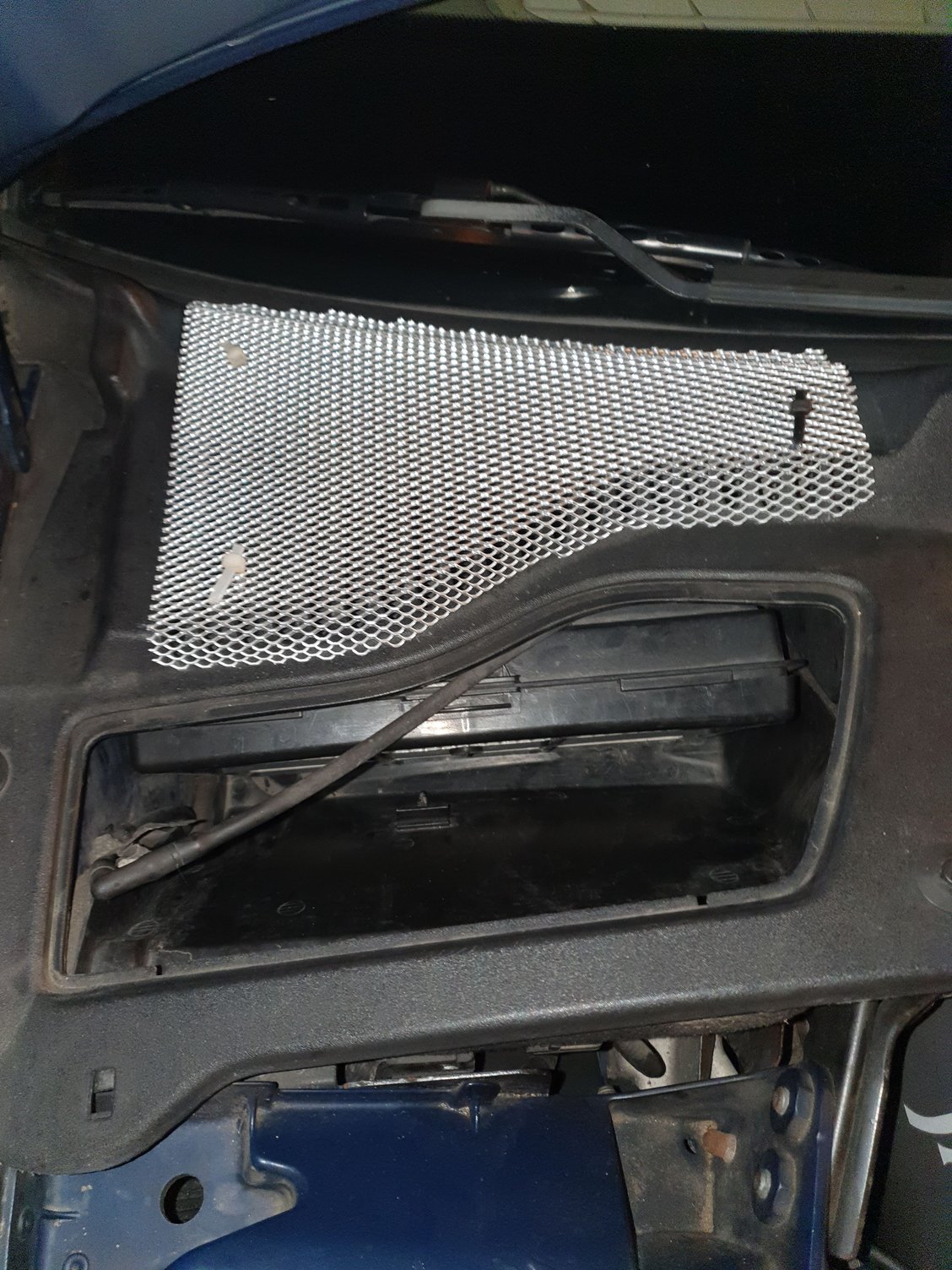

I formed an aluminum mesh grille to prevent leaves and acorns to enter the cabin filter box . Initially planned to have it underneath the Plastic tray but then again I would end up with having to empty in between the vents . So this is what it looks like

I like it, a great idea

Nice!
