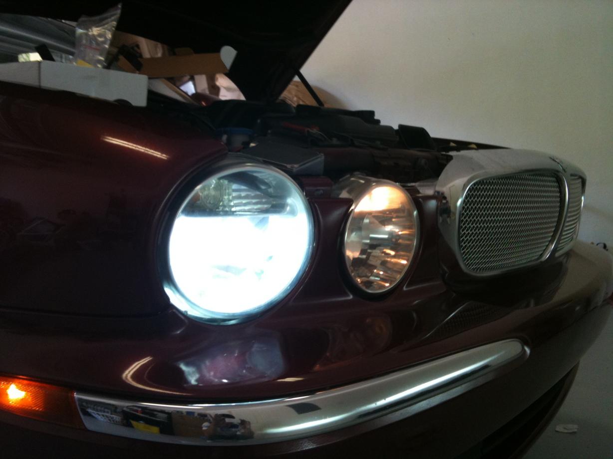

well I finally managed to put my HIDs on and they are awesome so far =D here is a pic, you can also notice my new front grill

That looks awesome.

Thanks to you sir! =D
