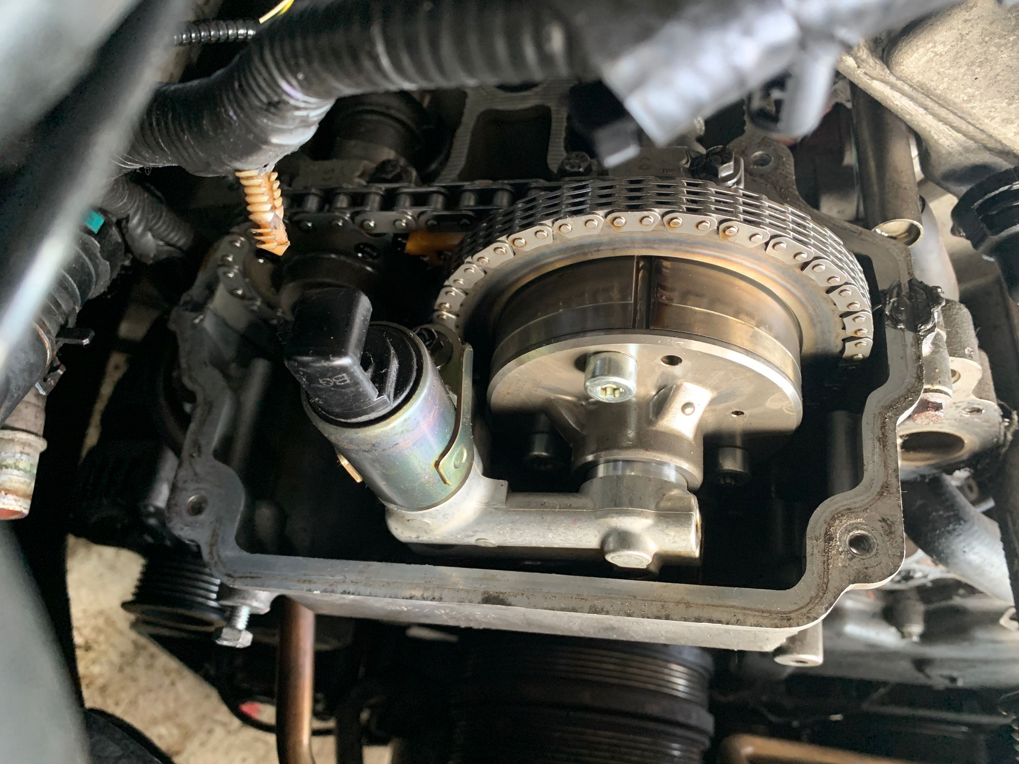

Being back from my one-week vacation I was able to stop by at the garage to see if any progress was made. The lid had been taken off of the supercharger and this is what we found:

The cylinder heads had also been removed and I was told that the chains are also loose and need to be looked at
Old Oct 9, 2023 | 12:14 PM
NBCat's Avatar
Posts: 6,067
Likes: 2,982
The primary timing chain on the AJ33/AJ34 has not typically been a problem area. When the shop says the chains are 'loose' are they describing the secondary timing chains driving the exhaust camshafts?
It's not possible to tell from the photos the condition of the secondary timing chains or tensioners. I have seen the secondary timing chain tensioners fail on the AJ34.
Old Oct 9, 2023 | 12:26 PM
CTDavies's Avatar
Joined: Oct 2023
Posts: 22
Likes: 8
From: Weeze
He was specifically talking about the chain held by the yellow tensioner. I think I'll have them all looked at just to be on the safe side. As I said this afternoon, this should be the last car I have bought in this life so it needs to be reliable for at least the next 40 years. I am now 63 years old )

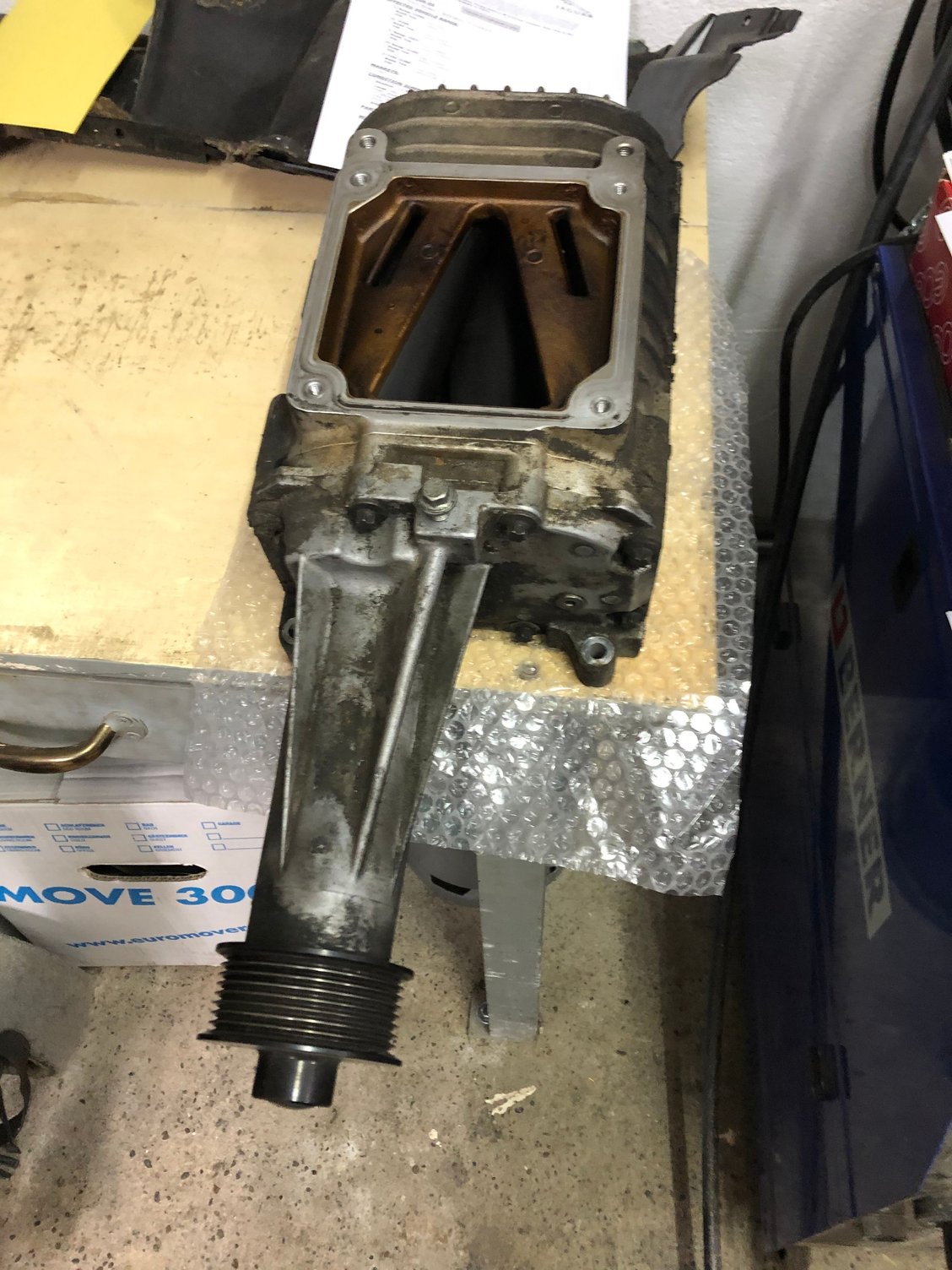

The surface of the supercharger blades should be all black, it looks like the coating is dissolving. As far as I know,the coating can be redone by specialist companies.
This is how the supercharger of my car looked like with about 177,000 km on the clock.

The damaged supercharger was packed and shipped to XK8 Store in Austria yesterday for a complete overhaul. As Christopher said at XK8 Store the rotors will be sent to the US for re-coating. In all I was told to expect two months for the whole deal.
@Thomas-S. we'll also replace the valley hose.
As has been mentioned before: disconnecting the s/c drive belt didn't stop the rattling noise. The mechanic thinks the timing chains might be rubbing against the housing due to loose/worn tensioners. This would mean opening the entire front end. I will keep you updated.
