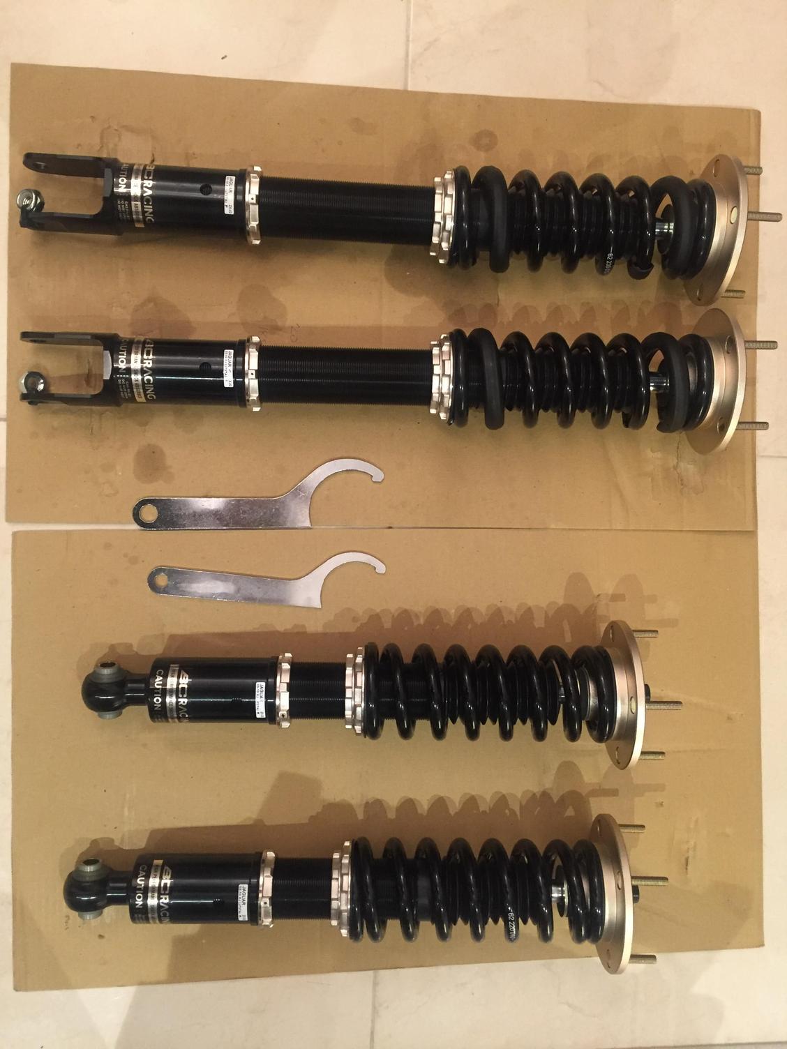

I fitted BC Racing Coilovers back in September 2002. They had a free shipping offer at the time, so for me here in Dubai, it was a no brainer!
Simple to fit, they allow you to choose your ride height and offer 15 positions towards soft and 15 to firm. I have them set 2 places back towards soft.
Obviously I suspect the ride is not as cushioned as the original Bilstein Air Springs? However, at 17 years of age and given the prohibitive cost of OEM replacements, the aging Bilstein Dampers were becoming increasingly poor? All of the alternative air springs do not offer the CATS handling, so in my opinion, Coilovers become an option?
I would certainly recommend the BC Racing BR Series coilovers!

No, 3.5 V8 long wheelbase. I would imagine that you would bias your ride more towards firm to replicate your XJR ride?
