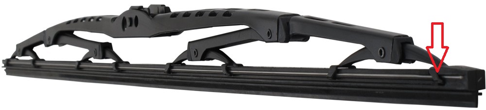

As a very good aftermarket wiper replacement the rubber blades from Bosch Microedge blades, 19” 40719A, 24” 40724 work well. I paid less then $25.00 Can (aprox $20 US) from a local Auto Parts, Lordco.
On my 2004 XJ8 the OEM wiper blades are Trico. On the Trico web site they list the replacement numbers, 15-240 & 15-190. I ordered these through a local supplier but when they arrived they were very different in design and style from the original and as much as we tried could not fit them onto the ‘J’ wiper arms.
After much research, including fitting Honda CR-V 19” refills which worked well on the Pass. side, unfortunately they don’t make the same refill in 24” to fit the drivers side, I found the above Bosch blades as refills. The Bosch come as complete wiper blades which include the frame and rubber wiper edge. Only the rubber edge is used, not the frame. This retains the look of the OE.
Replacement can be done on the car but its best to completely remove the old wiper blade including the centre hinge piece that contains the washer heads.
Remove the rubber blade from both the old and new wiper blades. Take care not to damage the new rubber blades particularly around the indentions the frame end claws go into and metal side strips. A little KY Jelly or other water soluble lube helps.
The new blades should slide perfectly into the claws of the old frame. Use a little lube if needed or slightly spread or squeeze each claw with a tool. Make sure the metal side strips are properly in place or they will work loose as well as the end claws are properly fitted in the indentations. Then refit on to the arms.
