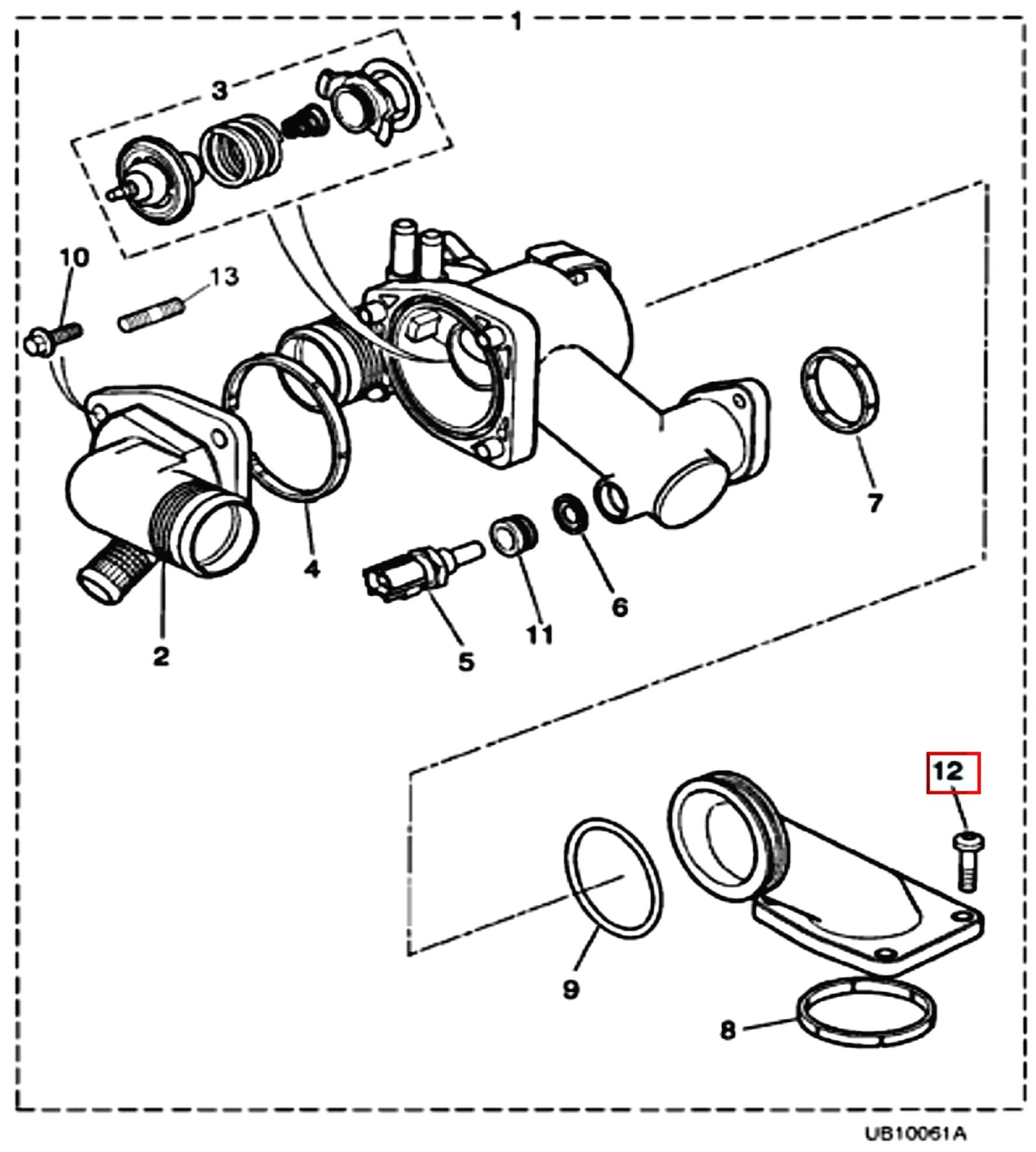

streamsaver....... I have periods when I can work on the Jag. I got everything off and cleaned all the covers & parts. While things were off, I flushed the engine, radiator & heater core. I used a hose but immediately blew everything out with compressed air. I cleaned the engine. I had decided to change the battery, so I cleaned the boot and added Hercules bed liner in part of it.
I'm ready to return to the thermostat. My thermostat is not assembled. I've attached two dwgs (same) except one shows it assembled, one not assembled. My old thermostat was impossible to get apart without destroying it. Do I have to compress it prior to installing it? Is there a detail for that?
Thanks streamsaver
Shown assembled
Shown unassembled
The few videos on Youtube don't show the 350 & show them already assembled.

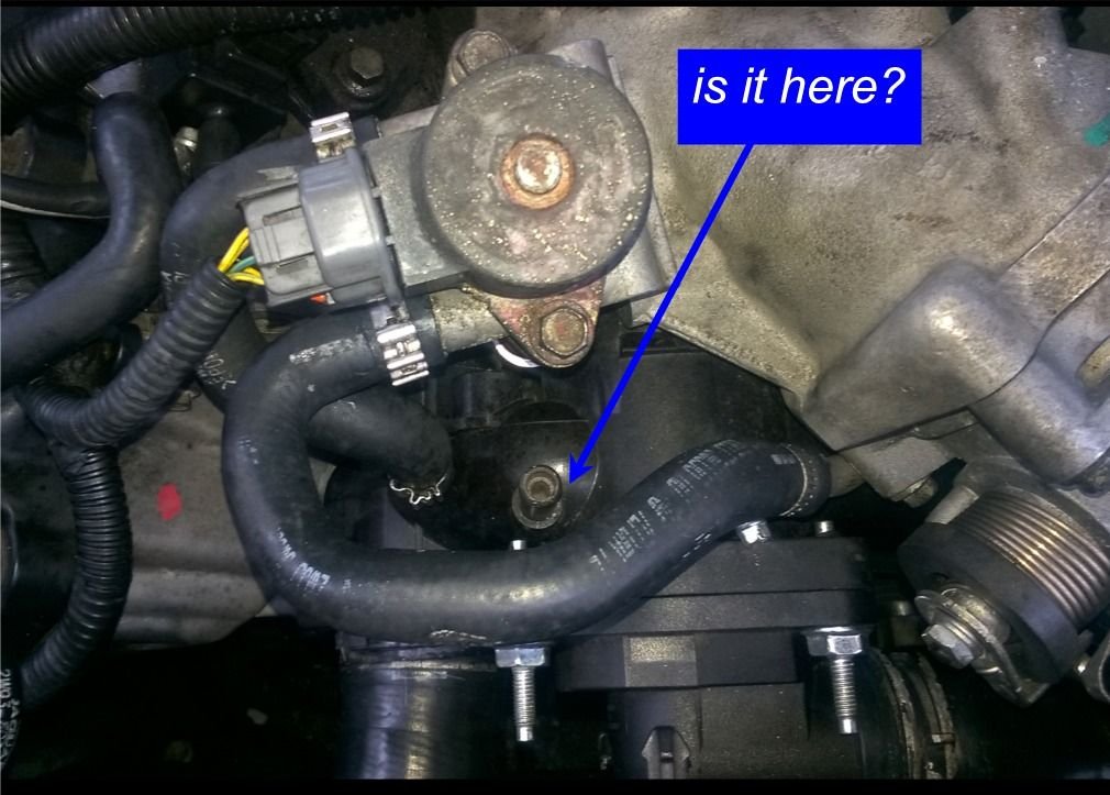

Need help identifying where this goes.
I have a photo showing a wire that screws into something. I have another photo showing where I think it might go, however,
it's still routed as it was, and doesn't reach this area. Can someone tell me, or show me where it goes? Thanks, streamsaver

Is it a wire, or a hose?
Looks a lot like the air hose, that goes to your air shock.

Thanks Wingrider, I don't know. I'll try to look at that on JEPC

I agree with Wingrider….Compare it with the same hose on the other side?

Thanks EsRay &
Wingrider,
I checked out the other side and have the same loose part. At some time, I assume, the hydraulics must have been changed. There is no place to attach them. Thanks, Gary
