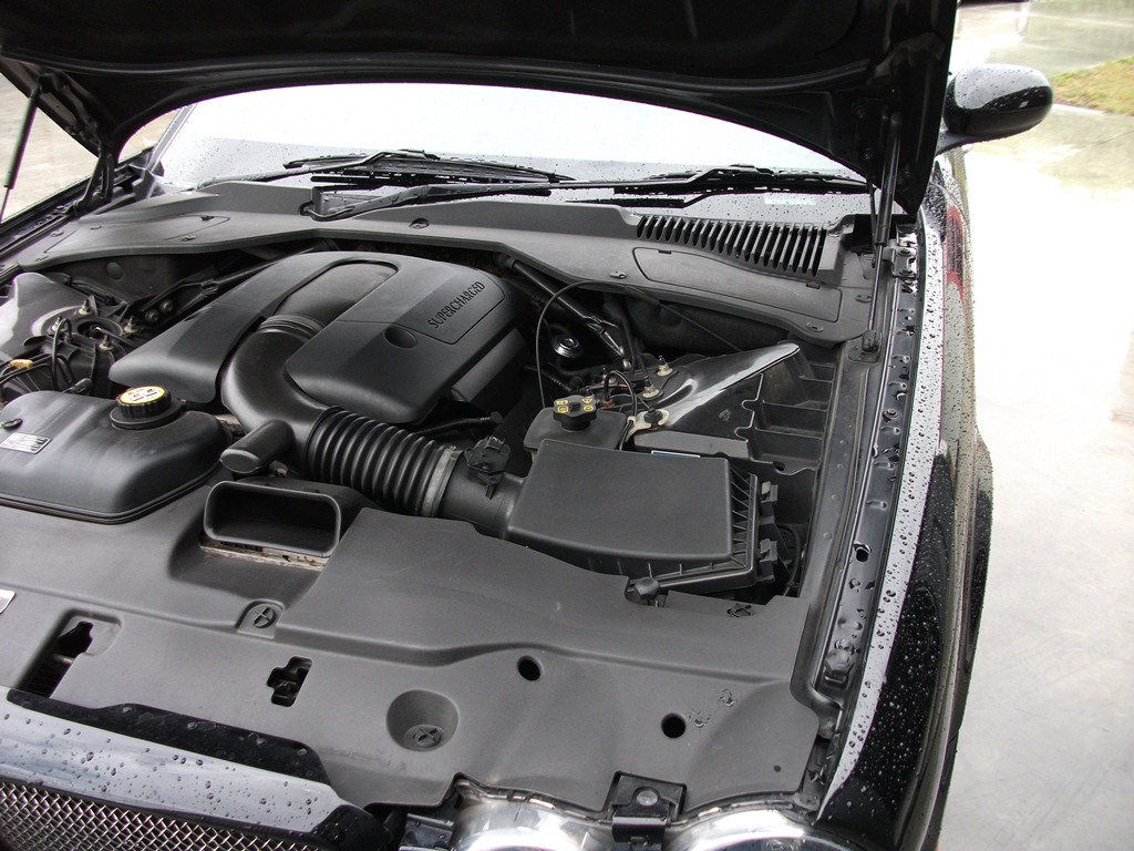

I know this this is a dumb question, bc under the hood I dont see the sc, but when I bought my car recently it was listed " 2004 Vanden Plas Super V8 portfolio ". After reading the this thread , a 'super V8' is for sure super charged. I know what a sc looks like and I am sure Id know if I had one. The intake is that black cross over dome shape..
Point being, is there a place I can run my vin to see all its options?
Judging by your photo you 'just' have a Vanden Plas, not a Super V8. The attached photo is of the supercharged engine.
A dealer should be able to provide the full factory build spec for your car.
