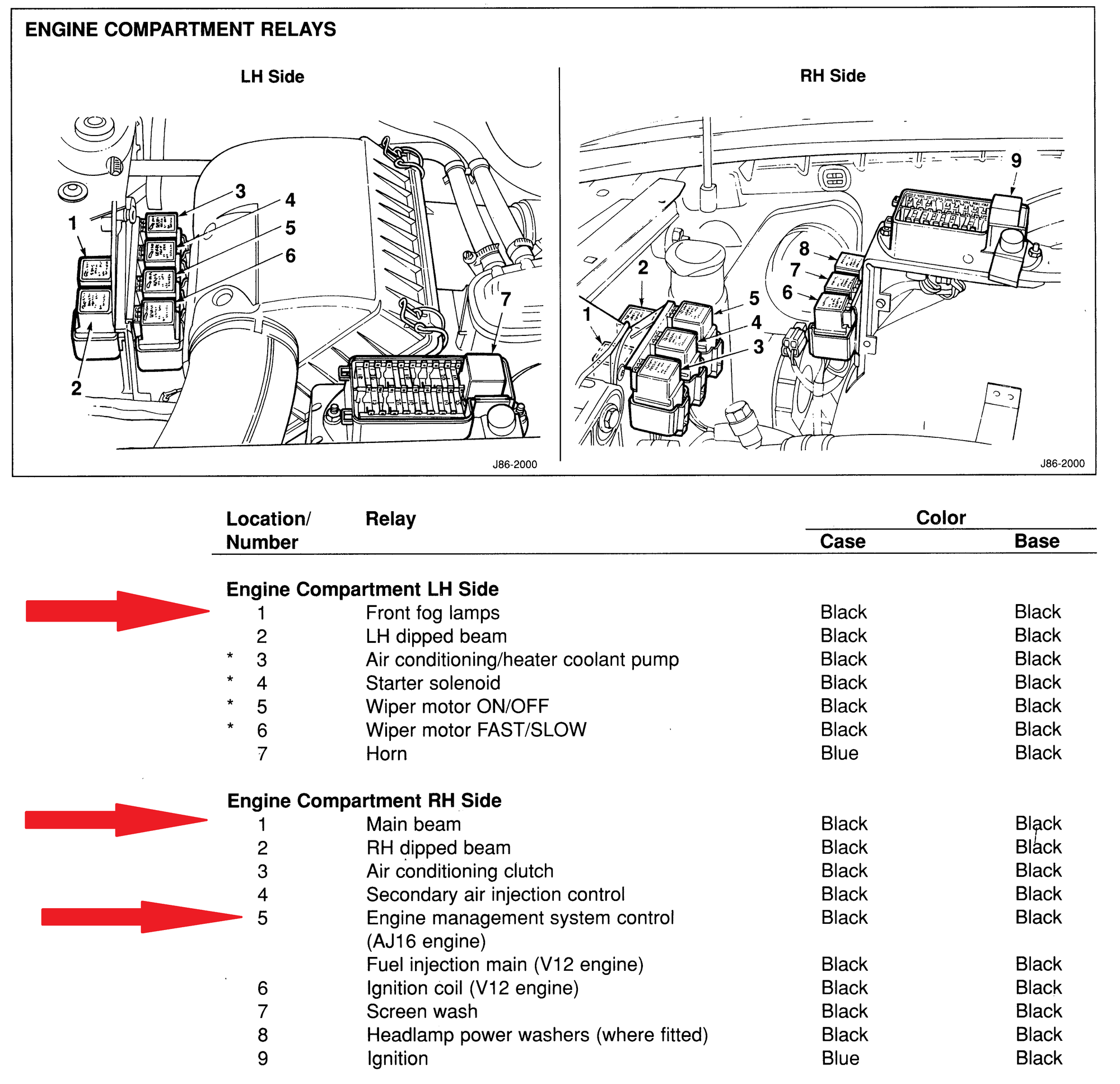

Reset the inertia / crash switch as this may have tripped by pressing with your thumb the rubber bulb . They don't always reset so you can remove the connector and put a paper clip between the 2 white wires .
Does the starter relay # 4 click by putting your finger on it ? if not put a meter on the White/ Pink wire at the starter relay socket as this is supplied constant power from fuse # 12 / 10 amp RH Engine fuse box which is supplied power from ignition positive relay witch is the one in the corner of the RH Engine fuse tray . The Green / Orange wire is the control ground to close the relay .

Edited above post . Keep in mind the engine ECU will act up below 11.5 volts . The relay can be hard to remove so penetrating spray helps .
The White / Yellow wire controls the ignition positive relay to close it . It goes through the inertia switch and the ignition switch to proved a ground . Environmentally protect the repair on that wire for the future
