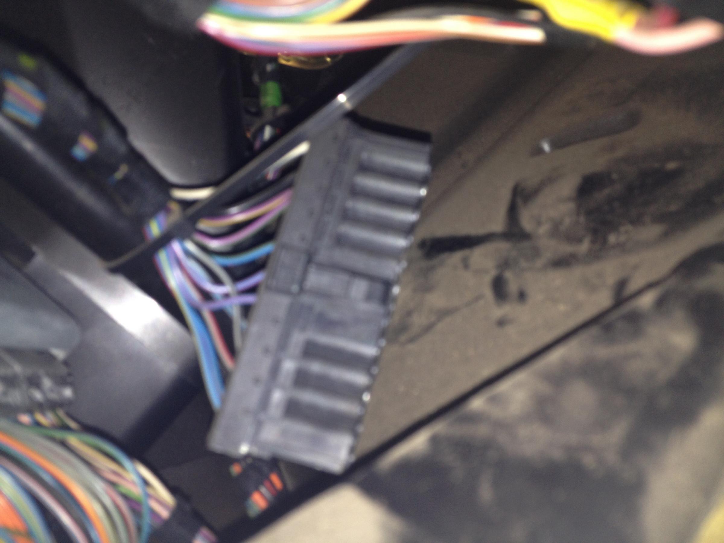

Was told to plug in the code reader under the steering wheel is the attached photo the plug for the code reader?

It would sure be nice to see the business (contacts!) end of that plug!

Hi im sorry im confused does this mean its not the code reader plug
