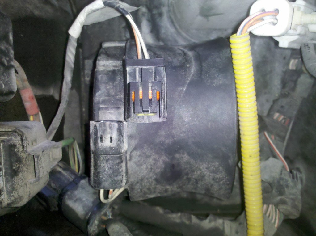

Here you go! Dig down in the right front corner (LHD) near the windscreen washer bottle and find this little round noise-maker and unplug him as shown. You may want to bag-it-n-tag-it to keep moisture out. I kinda like the little chirps myself but it sounded like that was where the noise came from so I unplugged it and did a lock/unlock sequence to check. You can still hear some relays click in that area as well as the doors locking and unlocking, but otherwise silent. I am not yet in a configuration to crank it up and do a start - no notion of whether it affects other security system functions or not.

I unplugged mine for the same reason.
However I believe it's the same unit that sounds when the alarm is triggered, If so it means you won't be aware if someone tries to break in.
