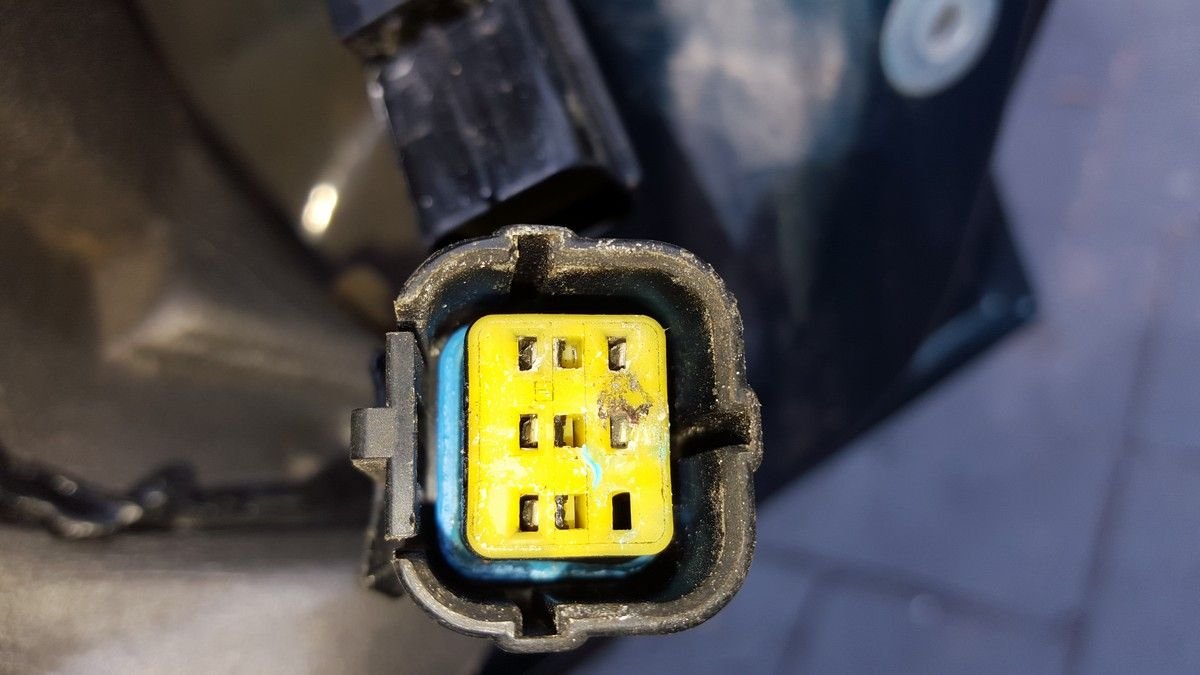

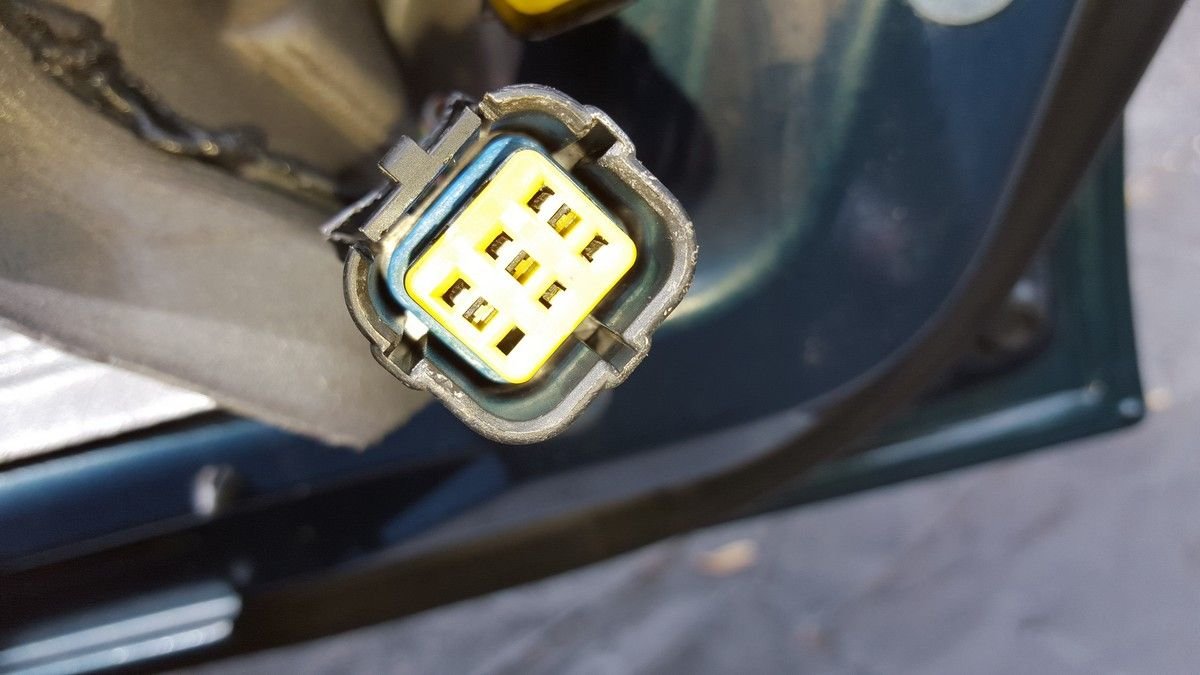

I had a similar issue with random alarm triggering (but not with relay buzzing) which I traced to RH Rear door with the help of IDS. I found that a connector for the handle/lock was a bit corroded. Cleaned it up with contact cleaner and a stiff brush and has been good for a couple of years now. Pictures attached of before and after cleaning.
