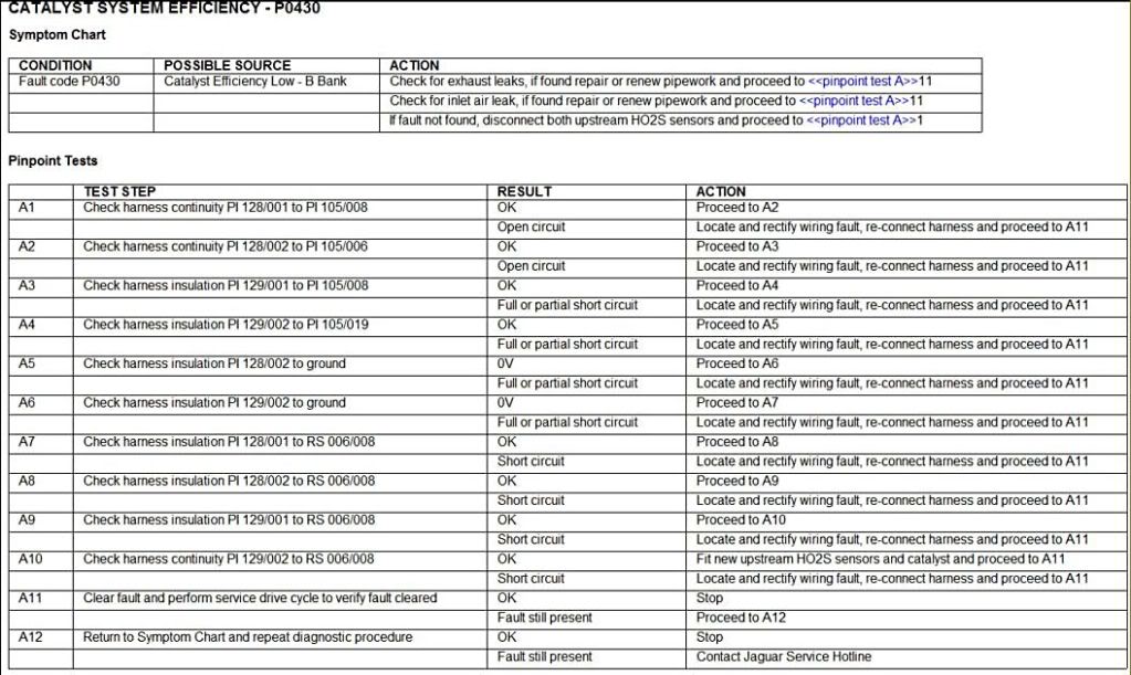

Also I was getting a p0430 code after a week of the light being on. If that nnarrows the problems down. Thanks for the diagnosis chart

Hello
Well, here is another JPEG, this one is for P0430 DTC Fault Code:
Since Cylinder bank A is right-hand cylinder bank (US passenger side) viewed from flywheel end, then Cylinder bank B must be left-hand cylinder bank (US driver side) viewed from flywheel end.
