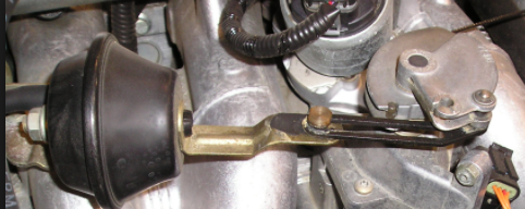

I have a question to clear up this issue or non-issue:
My cat is stalling during braking/red lights is due to an vac/air leak.
During checking all the air lines for visual damages, when i squeeze the cruise control valve i hear air escaping in the LH bay area.
Should I Hear anything? (Plus the bolts were loose, so i tightened them.
Thanks for any input in advance!

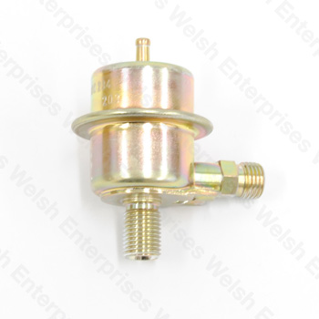

Vacuum line on the hidden back side of the fuel pressure regulator ?

The picture you have is the vacuum operated throttle actuator. The hose goes to a pump/motor controller in the left front area. It needs to be open to atmosphere when it is NOT pulling the throttle during 'cruise-control' or automatic speed control.
bob

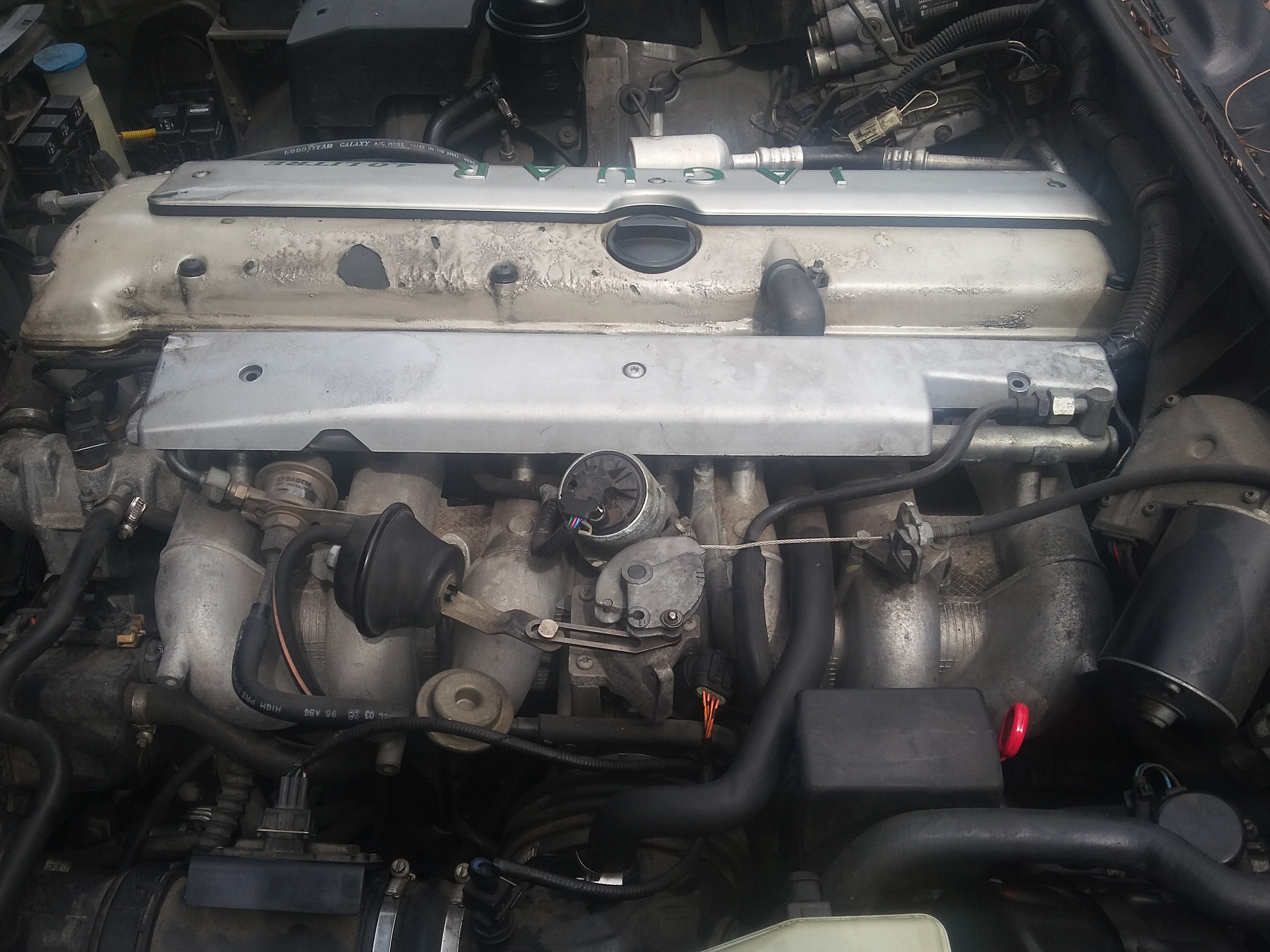

Ok, i took some photos of mine, and do understand mine is missing some components, the original picture i posted was from the internet, the images below are of mine, with missing spring and connector for the cruise control rubber valve:
Attached Thumbnails 1997 XJ VDP VIN From 720125 Throttle mounted part / Why I hear Air?-20170813_153547.jpg
